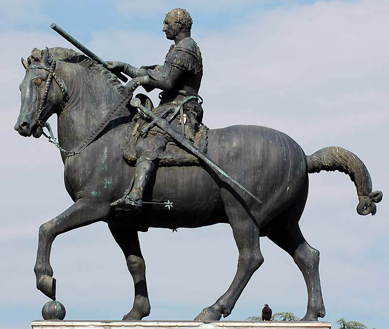

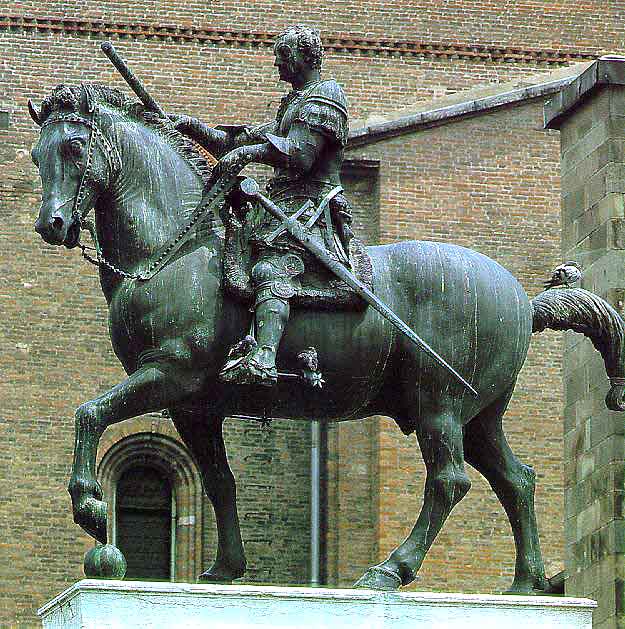

I came across this image from this site here.... http://www.paradoxplace.com/Insights/Equestrian/Equestrians.htm ...and I wondered when I saw that the Longsword seems to not have a full scabbard. It seems to be only about 12 inches long and the blade seems bare. I have seen this type of sword suspension in Landsknecht woodcuts but never on a mounted warrior. The sculpturers, one of whom was Michangelo's teacher, paid very great attention to detail in this statue as this Condottiere was very important in Venice. IMHO, it is unlikely that much artistic licience was used.
Wouldnt a sword suspended like this hurt the horse or is the blade too long to get in the way ? Does anyone else have any illustrations of unusual suspensions, mounted or otherwise ?
I am interrested to hear your feedback.
 Attachment: 88.53 KB
 Attachment: 84.36 KB

PostPosted: Mon 12 Feb, 2007 12:01 am    Post subject:         Reply with quote
That's fascinating... very good find.
I'd be interested to see the woodcuts showing hangers with exposed blades.
Is it a bare blade? I'm not certain...
Thank you.

Why do you think the blade is bare?
Scabbards were slim and thin.
They did not build much volume around the blade, that is why it might seem likte the blade is bare.
The suspension is typical for this period: two knots with thongs to attach to the waist belt.
Hi Peter........Did you download the Close-up image ? I ran the image through "Photoshop"...some different filters and blew it right up and I can see absolutely no trace of a scabbard whatsoever ...not a tip or a chape or a sliver. The Sword-tip is very sharp and although I know that scabbards can be quite tailored ( I make them ) ... I have never seen any scabbard this sharp. I checked the image very carefully before posting ! You can see the end of the short suspension piece. Its not at all an uncommon way to suspend a longsword in central Europe ( I'll post some more references presently ) , I've just never seen one on a mounted soldier before.
Cheers !
Merv ....... KOLR

These photos are not in a very high resolution and so I've been trying to find sharper ones on the web. I have typed in just about every word I can think of including Padova and Donatello without much luck so far. You gotta just love the web sometimes, huh ?.... I type in " Donatello " and end up with three hundred shots of a Mutant Ninja Turtle !! WTF?!
 Attachment: 97.65 KB
Merv ....... KOLR
Well, yeah Big Grin
The keywords that seem to be the most successful are 'Donatello Gattamelata'...
The highest resolution I found is here but unfortunately you don't get much more details because the quality of the photo is slightly lower (beware that the page is difficult to load, I had to hit refresh quite a few times to finally get it). I believe that if you follow the links starting from the Google image search you could find better shot of the sword.
Regards

I didn't see sculpted in the statue anything that would show where the "scabbard" ends and the blade begins to suggest that it doesn't go all the way to the tip. . .
Maybe I missed something?

solution is here
Look at the cross
http://www.bluffton.edu/~sullivanm/italy/padu...ropped.jpg
a good series of views of the monument
http://www.bluffton.edu/~sullivanm/italy/padu...elata.html

Hello all!
I agree with Bruno, there definitely appears to be a sculpted "triangle" over the central part of the cross, indicating a typical triangular overlap of the scabbard cover over the central part of the cross. I could see it if I looked carefully at the side-view photo posted earlier, but it's definitely visible in the head-on view.
My question would be this; did every period scabbard have a chape at it's end? Could this be a case of a scabbard without a chape, making it appear as if the blade were carried bare in the loops, or is the chape just indistinct? Could the tip of the scabbard, since it's small and juts out, have suffered differential wear? Could the finer details like a chape have been lost over time?
When you think about how narrow the blade represented in the statue must have been, you realize that it represents a definite thrusting-sword. That weapon must have been a wicked thruster, certainly not a dedicated cutter by any means. Almost an estoc.
Neat statue, though. I've always liked this one.
Cowabunga! Big Grin (Sorry, I couldn't resist!)
 Attachment: 8.64 KB
Close-up of sword's cross on statue.
 Attachment: 6.87 KB
Close-up of scabbard's tip on statue.

Couple of observations.
look at the cross: unusual (straight, very thick, a volute at the two ends), is more an architetcural element than a real cross.
So don't take the statue as too realistic on such details: it is realistic just as for the body and teh face, this was the focus of renaissance art, body proportions.
Gattamelata is depicted as a roman consul (please notice the roman breastplate gaily mingled with a period armor).
As for the roman statuary, the facial features are realistic with just a bit of idealization.
Even hairdo is typically ancient roman style, as it is the angel-like winged face on the breastplate.
The position is similar to that of Rome's Marc'Aurelio emperor (one of the few bronze statues to survive from the roman age).
Renaissance sculptors were concentrated mainly on studyng the math behind the proportions of things, a sword scabbard was not their primary concern for sure.
It is a masterwork of lost wax fusion too.

All of the discussion on this statue has been about full scabbard vs. partial scabbard, and that's great because that is the basis for the thread. But, what really impresses me most about the statue is the horse. This strikes me as a marvelous representation of an immensely powerful and majestic animal!
people who mantain that knighs were not using draft horses should regard this portrait with a certain interest: its is an heavy horse indeed, I'm not an expert but this is definitely not an arab horse.
