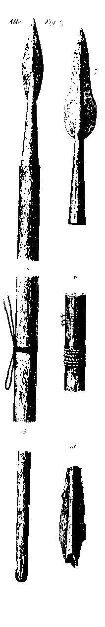

Peter Johnsson
Posted: Fri 13 Jan, 2006 9:59 am Post subject: |
On Javelins:
It is interesting to note that shafts from throwing spears were preserved in the Nydam find.
They are of ash and have nice line engravings in the last few inches of wood towards the head. The decorations are not unlike some found on viking spear head sockets a few centuries later.
The shafts taper slightly towards the head and more strongly towards the butt end. They sometimes have remains of a loop for one or two fingers secured at the thickest part. The use of such loops on throwing spears is depicted in art from many different time periods and places.
On others there is nails or cord wrap to mark the place to grip the shaft when throwig. You canse examples of theat to the right in the pic attached.
Depicted in the original publication of the find is one complete throwing spear with head and shaft intact together. It is interesting to note that the shaft is actually slightly thicker than the socket of the head. I wonder if this is for strength, or some other reason?
-Shane: I can see there is reason to add wrapping for securing the parts together, but I have never seen this in finds or depicted in art.
Was it for reason of extra security you decided to do this, or were there some other reason?
Just curious.
