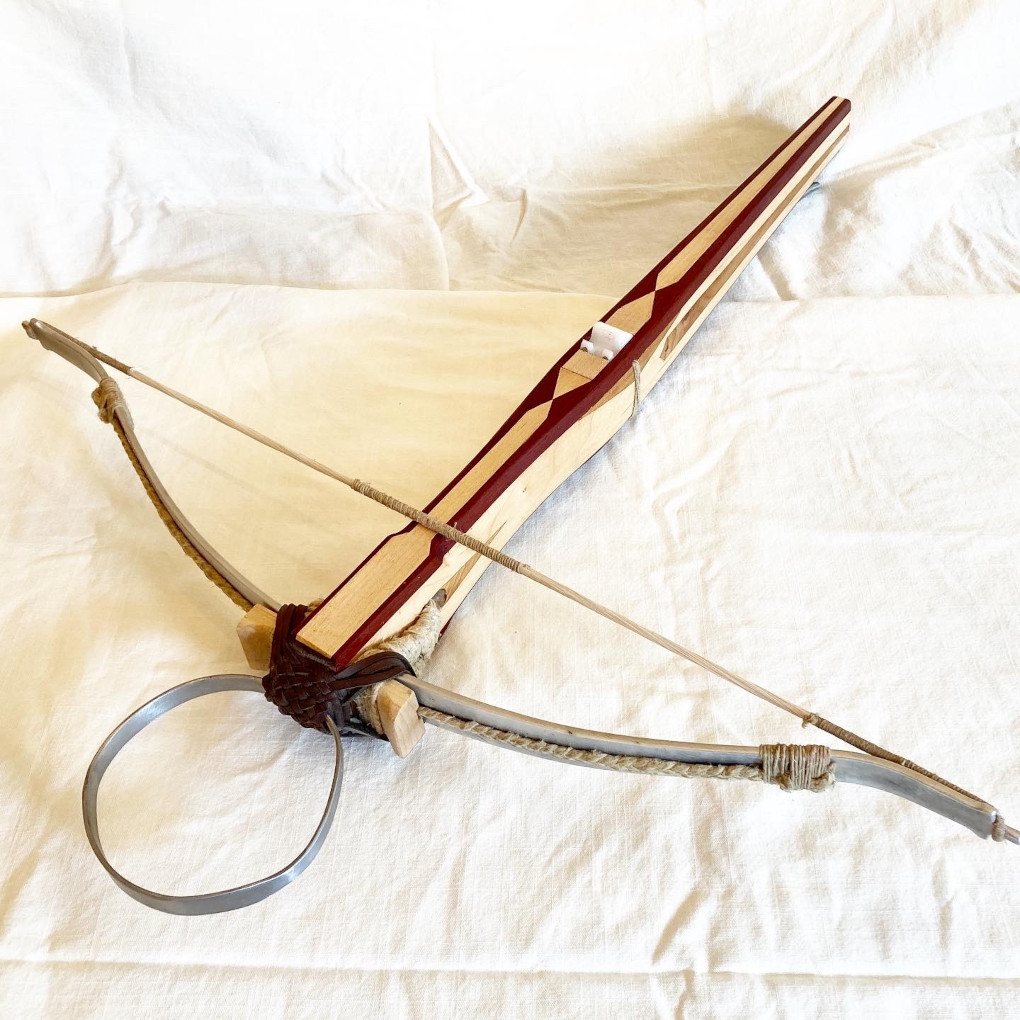

Hi gang,
I've just uploaded two new bows to my website (www.themodernarmbruster.com). The first was inspired by a 15th century Swiss (probably) example, with which I took some liberties with the materials, using padauk to veneer the top and bottom, and hard maple for the main body of the tiller. While I love the look of padauk, I do NOT recommend using it in conjunction with maple, because the dust gets into even the tightest of grain and stains it a bit.

Was thinking about one of these for light target practice in my garage during the winter. I particularly like the look of that Swiss bow. I notice that it does not have a bolt groove on the table. How does that affect making consistent shots?

Ah good question - I've left it flat for now, as some folks prefer groove, others a bolt rest at the front, so it will be up to the eventual customer. Personally I prefer the latter, as it makes it possible to adjust for windage (and for this one, would be more accurate for the Central European type). I wish I had done the same on the Flemish one!
