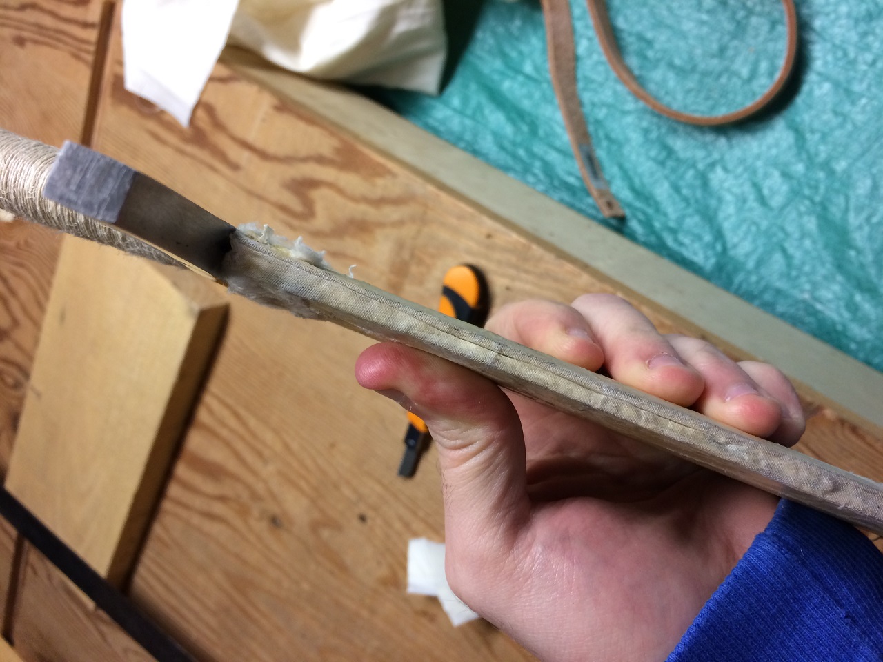

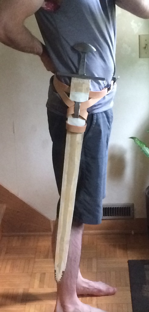

I've included some pictures of my scabbard (second ever, so it's pretty rough) and belt, as well as some suspension methods. The belt end is tucked around the back of the grip, and the system is NOT a double belt rig, though it looks so. I am beginning to believe that the belt is too wide...

Like the way you mounted it. Sliders do seem to have been hidden for the most part during this period and they often seem to have been carved into the wood of the scabbard. I've only seen sliders on English scabbards and possibly one Norwegian example. Have you covered the scabbard yet? I was thinking about using a hidden slider on a scabbard for an Anglo Saxon sword I have, it must be a bit of a headache to fit the leather?

I haven't covered it yet, no, but I have developed a tracing template for the leather using the slider mounted to the scabbard, and the extra tolerance isn't too much if the slider is lower profile. My plan is to put a leather or waxed linen patch below the slider void, to avoid exposing the wood, then skive the slit leather edges and wrap and glue them around the actual slide. I'll be using 1-1.5 mm pig skin for the whole scabbard, so it'll be thinner to begin with.
