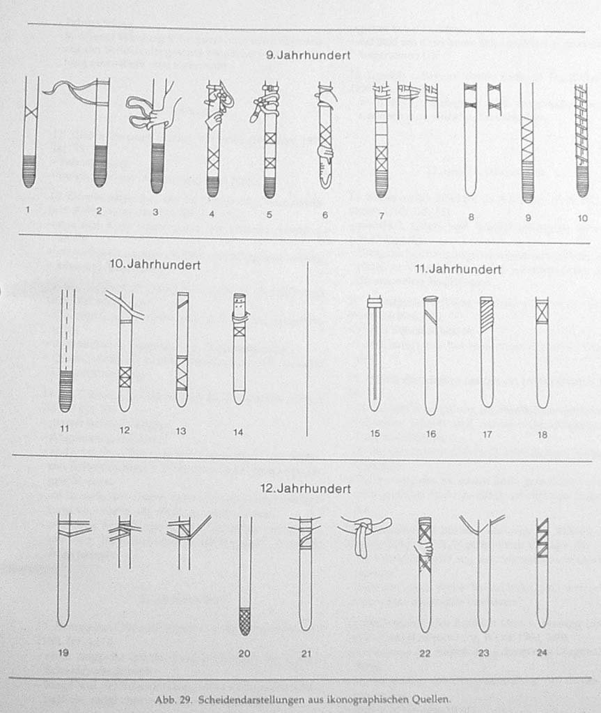

Also, there is one thing that I've been pondering. Many of these linen covered scabbards seem to have had a chape that consisted of a tightly wrapped linen spiral as illustrated in the attached scan from Geibig's book and reproduced by Tim. However, the thing I'm still not sure about are the cross-tied, zig-zag and spiral cords/strips wrapped around the scabbards and illustrated in the second scan from Geibig's book (which unfortunately does not show in the post). Tim reconstructed these as being decorative and under the linen wrapping. They may have been under the linen or leather cover but I'm having trouble with these things being decorative. Surely these cross ties would have served some purpose? Were they on top of the covering? Did they hold the halves of the wooden scabbard core together?
I can se how No. 10 for example would be the ribbon of the linen chape wrapped as reproduced by Tim in a long spiral around the rest of the scabbard. I tried reconstructing some of these other cross ties with a bit of string and some of them look plausible like No 5,7,9,12 and 13. Other ones like No. 1, 4, 6 and 8 just fall off when I try to reproduce them with a bit of string. Any ideas on what these cross ties would have looked like on an actual scabbard?
 Attachment: 64.39 KB
 Attachment: 100.55 KB

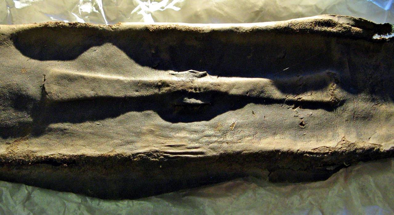

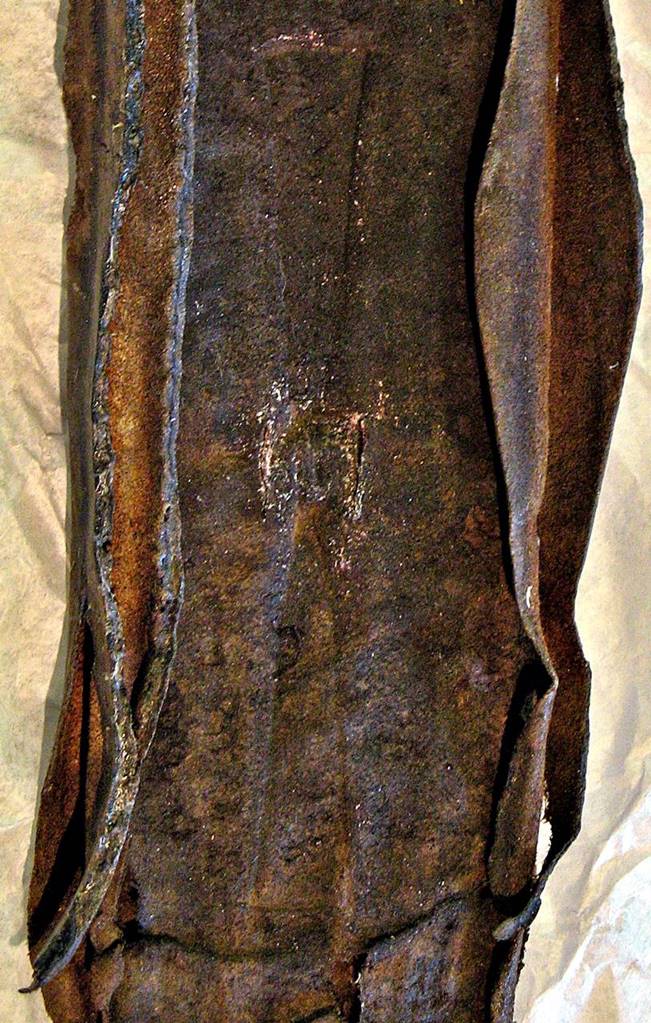

The assumption is organic, wood, bone, horn (there are no finds post-8th century in Western Europe that I know of...somebody showed me what they claimed was an iron one once but on what basis it was being identified as such I don't know..it certainly didn't convince me).
All that survives is the leather covering with the paired slits in for the strap to pass through and, in a couple of examples (most notably the one from Gloucester - I've attached some of the photos I took at Gloucester museum photos), the legacy mark of the slide itself survives imprinted on the inside of the leather.

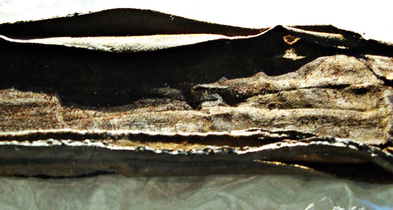

The best publications on the subject are both by Esther Cameron :-
https://www.amazon.co.uk/Sheaths-Scabbards-England-AD400-1100-Archaeological/dp/1841710652
https://www.amazon.co.uk/Scabbards-Sheaths-Esther-Cameron/dp/0901777595
 Attachment: 151.9 KB
 Attachment: 129.18 KB
 Attachment: 156.09 KB

Kristjan Runarsson wrote:
About the scabbard covers, were they found alone or were they found complete with wooden core? If they weren't it's entirely possible somebody scavenged the sliders for scrap mental. That imprint in the leather looks like whatever was under it was made of metal.
The leathers are found in rubbish dumps, having been stripped from the cores.
I've reconstructed the Gloucester scabbard with a wooden slider and then stripped the cover from it after 4 years and the imprint is exactly the same as that depicted. I don't think you can tell anything about the material from the imprint.
Why would you make it from valuable metal and then cover it with leather?
They may have carved them directly into the front face of the scabbard. That's a method known from both English and Continental scabbards from the 5th to the 7th century.
I just figured the imprints in the cover you posted photos of looked a bit too dainty to be made by a wooden slider that can stand up to some amont of abuse and the way the 'tails' at each end flared out into fans is typical for an iron object. You get this shape if you take an iron round bar, loop it into a '_/\_' shape and pound the tails of the '_/\_' progressively flatter towards the ends. If you are spending 500 grams or more of silver on a sword you'd be able to afford a metal slider. Iron in particular was not that precious.
