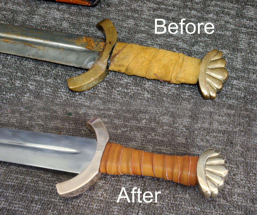

This is nothing to get excited about - it's a restoration of an old, cheap reproduction Viking sword that was made in India. But it came out rather nice, so I thought that I'd share. A friend of mine asked to see what I could do for this old, rusty, pitted sword. I didn't want to spend a lot of time working on it, but I wanted to give back to my friend something that he would like. Before and after pictures are shown below.

You did an excellent job of turning a genuine sow's ear into a silk purse. Very nice work!

I disagree with "nothing to get excited about".... you did a GREAT job cleaning up, and refining this sword. It's not so much about "this sword" - it's FAR more about you, and YOU having the guts to clean up & refine a commercial offering Happy.
Welcome to the "I'm gonna fix this sword dammit" club Happy.

Wow! The difference is like night and day. Very good job. Now tell your friend to keep it oiled Exclamation

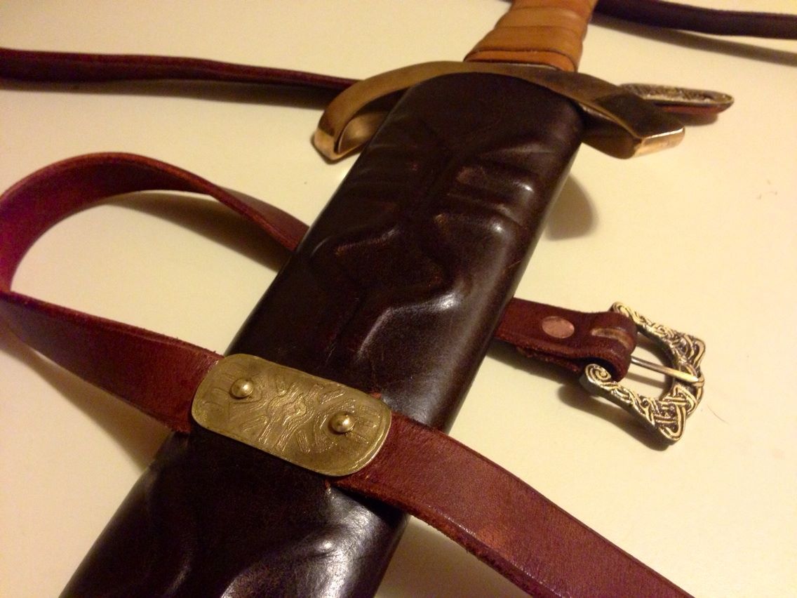

Here's an update... I decided to turn this whole project into a skill-building and learning session. So I made a scabbard and three-way ring suspension based on a hybrid of the Ballateare and the Cronk Moar scabbard from the Isle of Man.
I have never done any metal work, so I bought a brass bowl from a metal salvage yard, cut it up, and started tinkering around with some hardware for the suspension. It's not "Tod's Stuff" quality, but here's what I've made so far.
I am still trying to figure out how the Vikings tacked on the upper fixing plate, given than the scabbard wood core is so thin.

PostPosted: Wed 13 Aug, 2014 7:47 pm    Post subject:         Reply with quote
Seems like you are using your imagination learning to use various tools and methods and doing a very good job improvising techniques that seem to give good results.
Plus a good sense of visual design with the scabbard and scabbard furniture.

Anyone have a suggestion on how to place rivets in the scabbard, given that it's only 1/8" to 3/16" thick? Looking at the old Ballateare scabbard, the suspension plates were riveted to the scabbard, and they bore the full weight of the scabbard.

Here's what I did to rivet the upper fixing plate to the scabbard:
1. Carefully measured the thickness of the fixing plate, strap, leather cover and wood core wall = 7mm
2. Carefully drilled two rivet holes 6mm deep
3. Cut and sanded two rivets so that the shanks were 6mm long
4. Plastered the back of the fixing plate and the rivets holes with super epoxy and glued the damn stuff into place
 Attachment: 111.18 KB

Pretty much what I would have done... toss in epoxy, insert rivets, flip scabbard upside down (gravity allowing epoxy to flow AWAY from blade channel). Run the blade in several times, then have a little acetone handy to remove any wet epoxy from the blade. Walk away for 24 hours.
....and I'm going to be really surprised if this was your FIRST scabbard Happy. VERY GOOD job Happy
