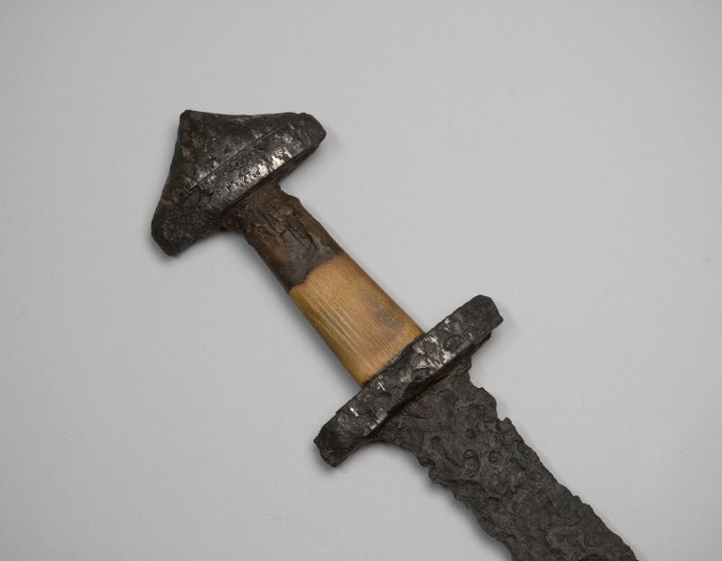

Here's a narrow thick bladed Viking age sword with no apparent fuller found near Adelsö (near Birka).
Link to the Kringla website:
http://www.kringla.nu/kringla/objekt?text=sv%...ect/263029
It seems to me a sword like this would be well suited for thrusting and could be quite rigid.

The photos I just posted, that would be a Maekir then? It almost looks like a sturdy Rapier even.

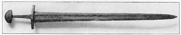

Here's a couple more pics of viking swords with pointy tips for you...
 Attachment: 14.02 KB
 Attachment: 17.24 KB
 Attachment: 48.54 KB
