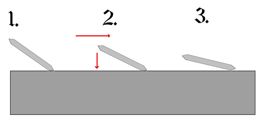

First I have to say, forgive the crudeness of my picture... I cant do better right now :p
Ok, so. This is the way I use and some people could disagree with my method, but hey, it works for me ;)
I usually improvise a sanding block just using 2by2, and I usually start with a REALLY coarse sanding paper, to get rid of the scrathces and making new ones uniform. Just go up with higher and higher repeatedly.
1. Line the beveled edge of your sword / knife with your sanding block / whetstone thusly
2. Then carefully start to move your blade forward, GENTLY rotating the blade downwards, so that the edge would take a round shape
3. You should use the whole lenght of the whetstone / block, and in the end, it should be in this position.
And as for the second picture, you should move the blade diagonally as such.
When done corrcetly, doing this repeatedly should get you a nice, appleseed edge!
I hope this helps even a little.

Hmm, the pictures went the wrong way around. Oh well, I hope they still are of any use :p
