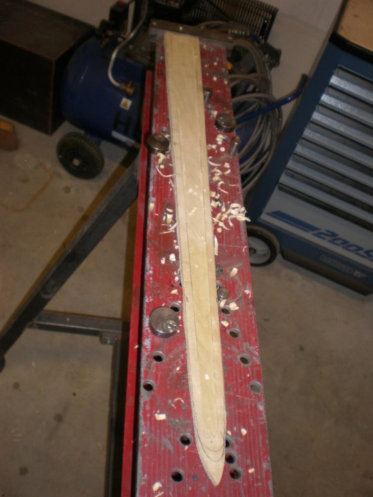

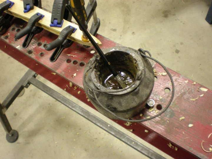

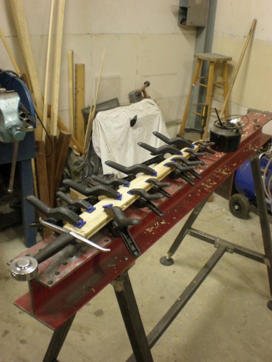

Hi.
i'm new to the Industry Professionals.
and i want to show you some things i make.
so here is my first DIY project
ben
 Attachment: 48.05 KB
drawings for the fittings
 Attachment: 62.3 KB

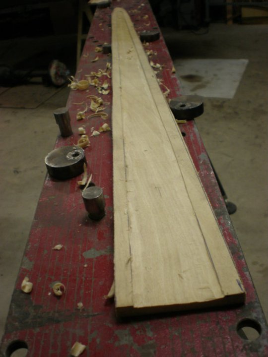

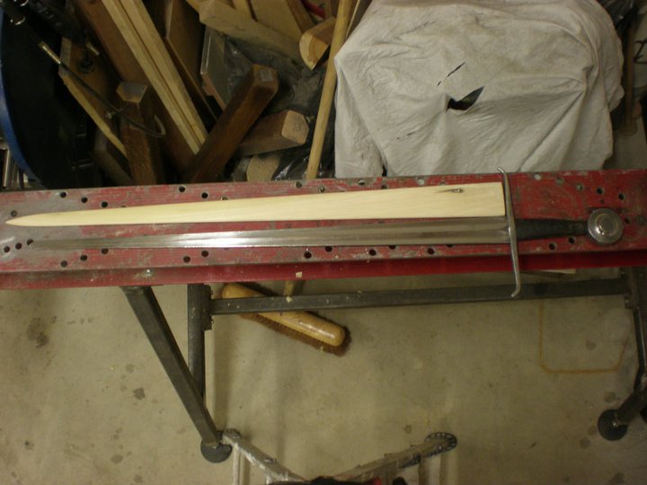

sword beside the plained core
 Attachment: 70.94 KB

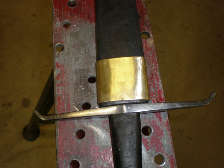

last fitting before the plaining of the scabbard
 Attachment: 76.44 KB
the bone glue
 Attachment: 70.31 KB
glued the scabard core
 Attachment: 63.79 KB
test fitting the sword
 Attachment: 51.65 KB
chiseled out the core
 Attachment: 59.97 KB

PostPosted: Fri 14 Jan, 2011 7:39 pm    Post subject:         Reply with quote
Very informative photos.I am also working on a scabbard right now,so it was fun to compare techniques.I'm using poplar for mine,what wood are you working with in the photos?I am also fascinated by your steel I-beam workbench.That's a cool idea,did you make it yourself?Your website was nice .Do you just make scabbards,or do you make other stuff as well ? (for "the upper class",of course Big Grin )
Wounds of flesh a surgeons skill may heal...
But wounded honor is only cured with steel.
We who are strong ought to bear with the failings of the weak and not to please ourselves.
Each of us should please his neighbor for his good ,to build him up.
Romans 15:1-2
Ben Anbeek
Location: veenendaal netherlands
Joined: 28 May 2007
Reading list: 18 books
Posts: 113
PostPosted: Sat 15 Jan, 2011 1:12 am    Post subject:         Reply with quote
Hi Isaac
The core is also poplar.
I made the I-beam bench it's one of my favorite tools.
It wont shift while plaining large poles.
i also make poleaxes and lucernhamers and planning on daggers and swords.
ben

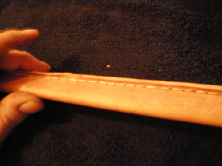

PostPosted: Sun 16 Jan, 2011 8:56 am    Post subject:         Reply with quote

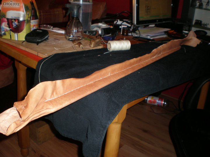

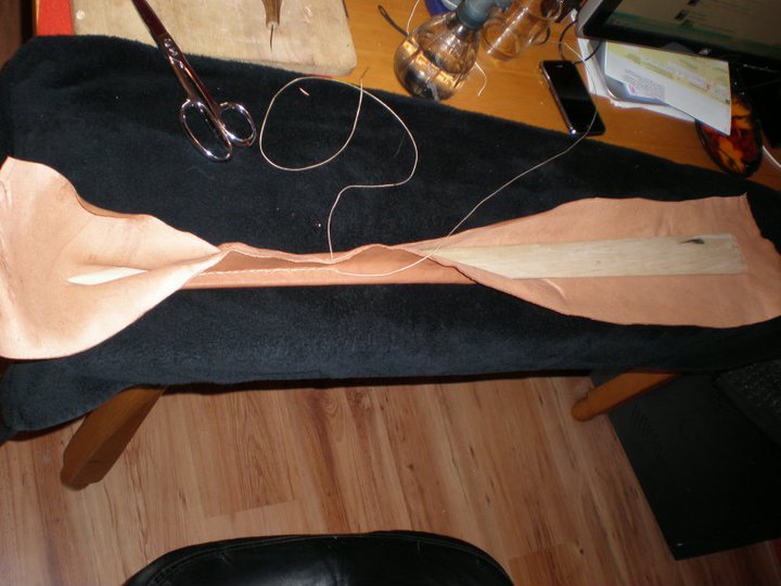

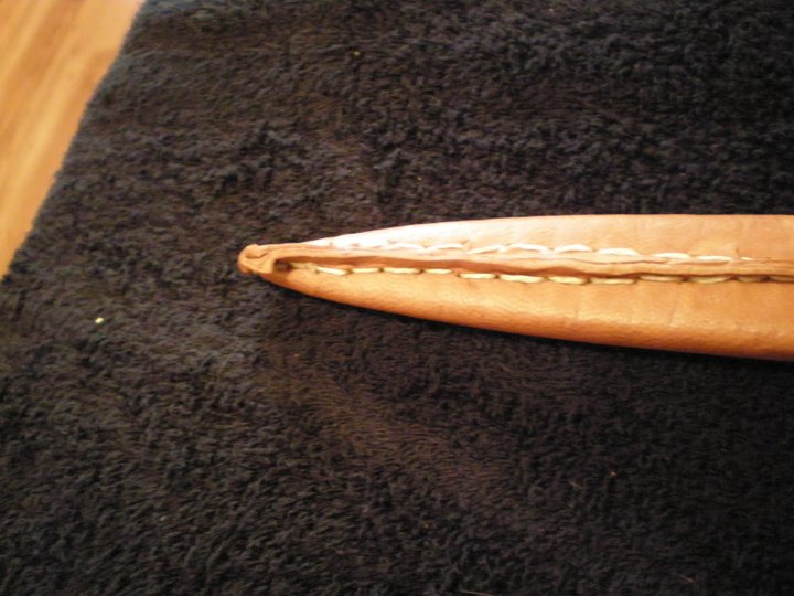

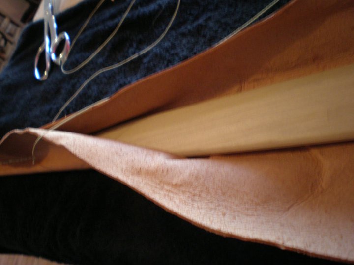

just finished the sewing of the scabbard.
it's sewed with a saddler's stitch starting about 5 cm from the point sewing it up to the throat.
then sew back the last 5cm to the point.
then cut down the seam just above the sewing line.
and iron it down with a hot ironing tool.
then burned my mark in it.
ben
 Attachment: 65.88 KB
sewing the leather with a saddler's stitch
 Attachment: 49.69 KB
 Attachment: 63.91 KB
sewed the core
 Attachment: 53.41 KB
trimed down the leather
 Attachment: 74.46 KB
the seam needs to be trimed down even lower
 Attachment: 47.84 KB
ironed the seam down and added the burnmark

Hi Ben, I am fairly new to making scabbards but I haven't seen documentation for that sewing method on a sword scabbard before (I know it is used on knife sheaths). I was wondering if you had any docuementation as it its use on scabbards?
Thanks,
Dan
Ben Anbeek
Joined: 28 May 2007
Posts: 113
PostPosted: Sun 16 Jan, 2011 9:55 pm    Post subject:         Reply with quote
This is how all the medieval scabbards are sown up I have seen en have read about in the netherlands.
I have never seen one with a cross stitch on the back.
So this is how I make them.

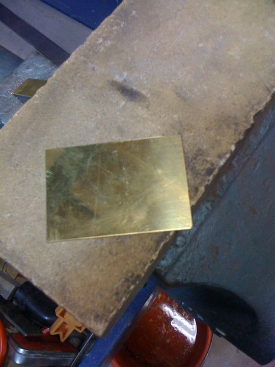

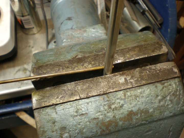

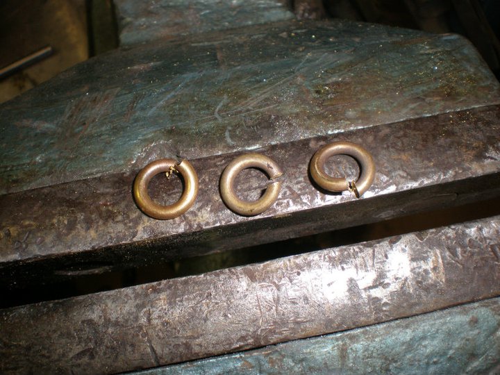

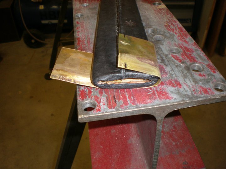

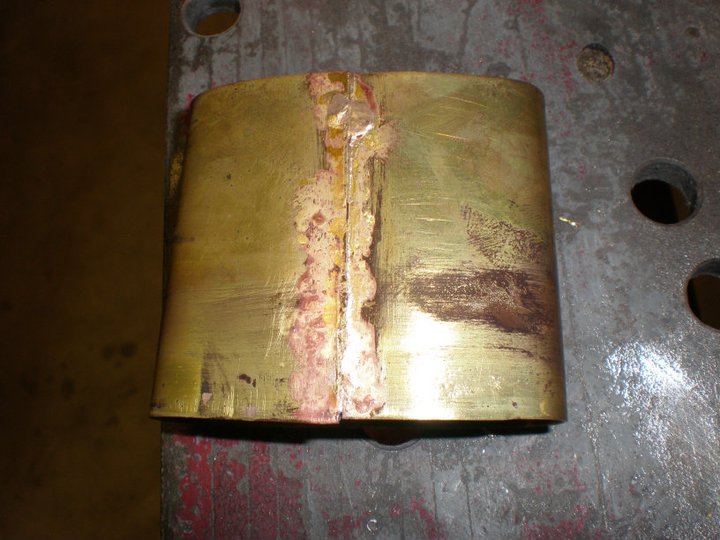

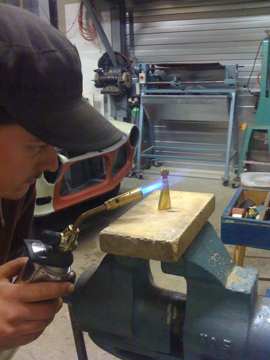

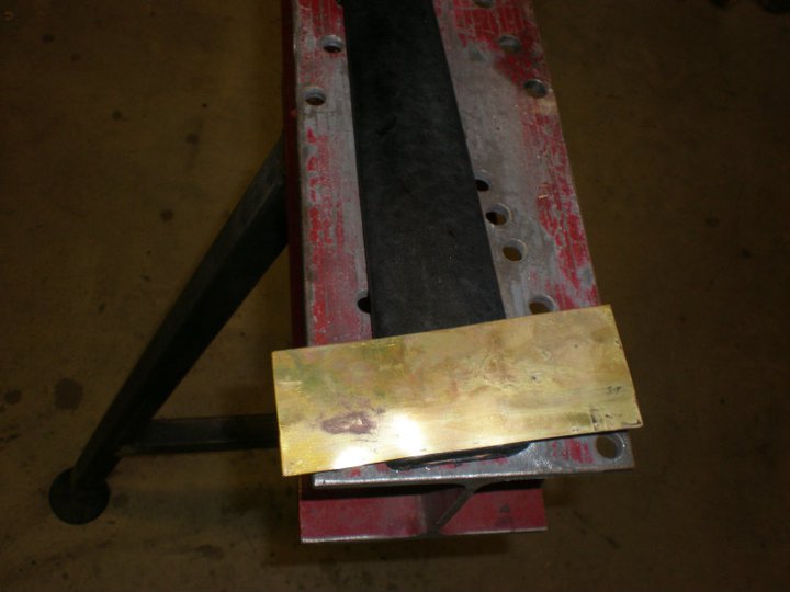

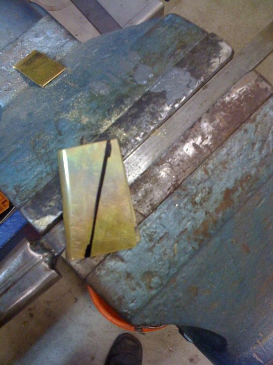

Brazing of the upper chape
I think the pictures are self explaining.
If you have questions pleas feel free to ask.
 Attachment: 43.42 KB
brass sheet
 Attachment: 65.07 KB
forming the brass
 Attachment: 66.59 KB
formed
 Attachment: 75.34 KB
brazed
 Attachment: 55.4 KB
filled down
 Attachment: 78.05 KB
 Attachment: 90.39 KB
 Attachment: 99.12 KB

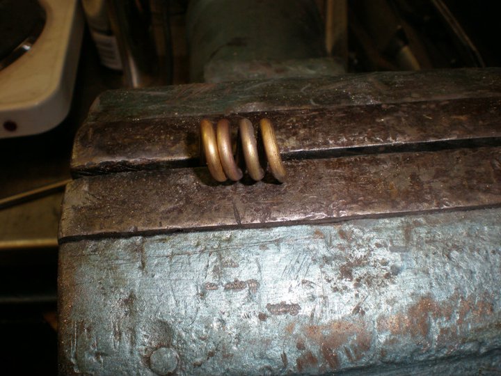

and the last foto's of the brazing
 Attachment: 62.72 KB
brazing on the ring
 Attachment: 57.36 KB

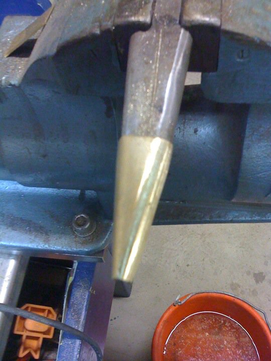

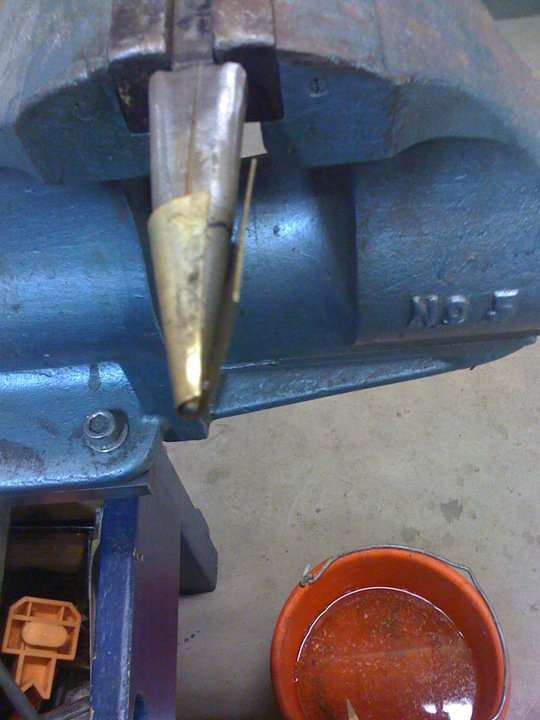

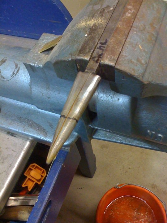

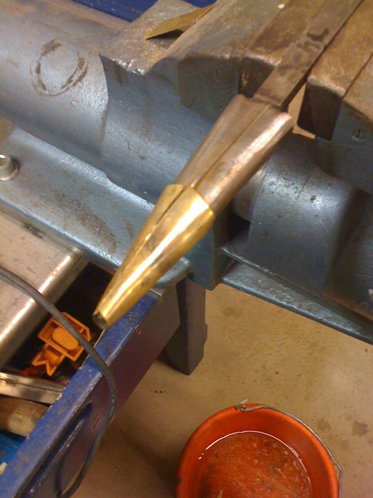

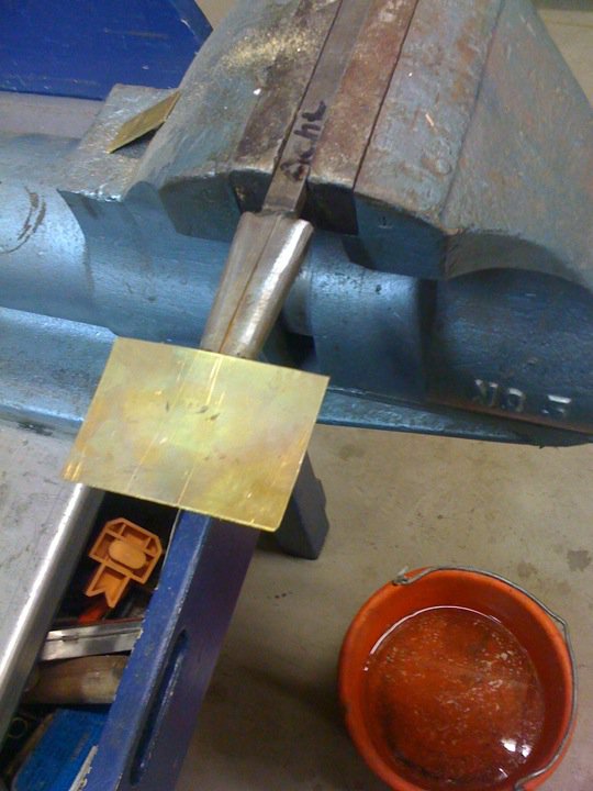

PostPosted: Tue 01 Feb, 2011 1:11 pm    Post subject:         Reply with quote
Hi made some procress today and here are the pictures of making the point.
 Attachment: 61.89 KB
0.8mm brass sheat
 Attachment: 73.94 KB
metal die for the point
 Attachment: 71.21 KB
 Attachment: 74.03 KB
forming the brass over the die
 Attachment: 72.64 KB
cutting the brass on one side
 Attachment: 71.2 KB
folding over the other side
 Attachment: 71.16 KB
cutting the back with a 1mm cuttingdisc
 Attachment: 70.06 KB
brazed and filed down

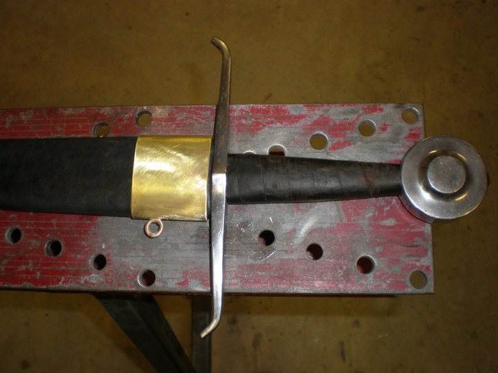

progress so far.
made the middle shape same as the upper one.
and a start at the point.

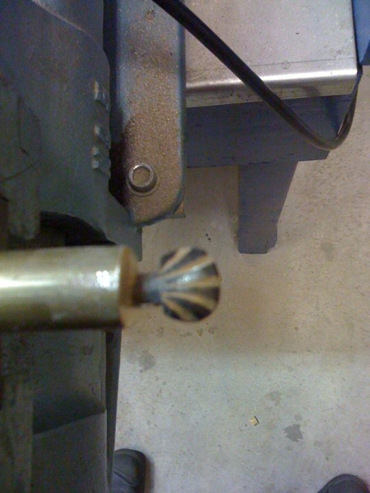

PostPosted: Fri 04 Feb, 2011 12:19 pm    Post subject:         Reply with quote

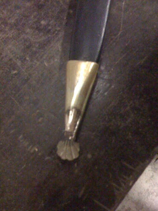

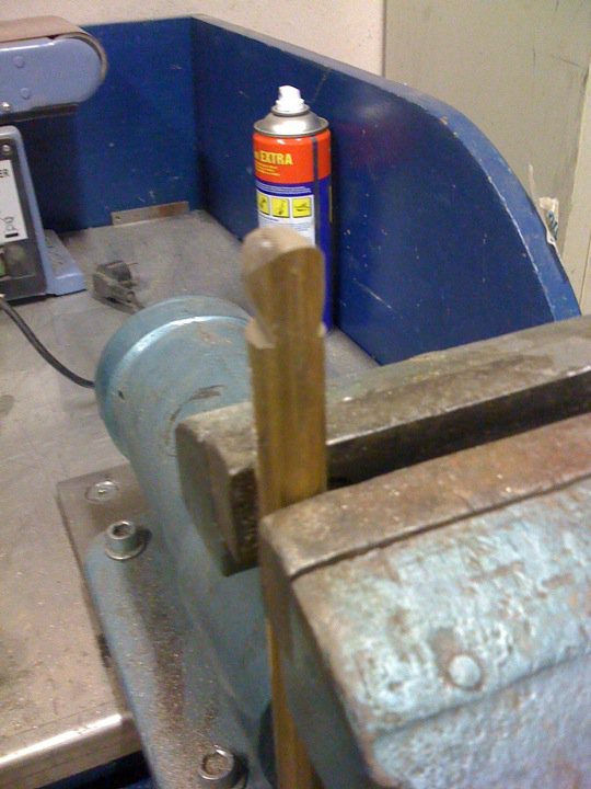

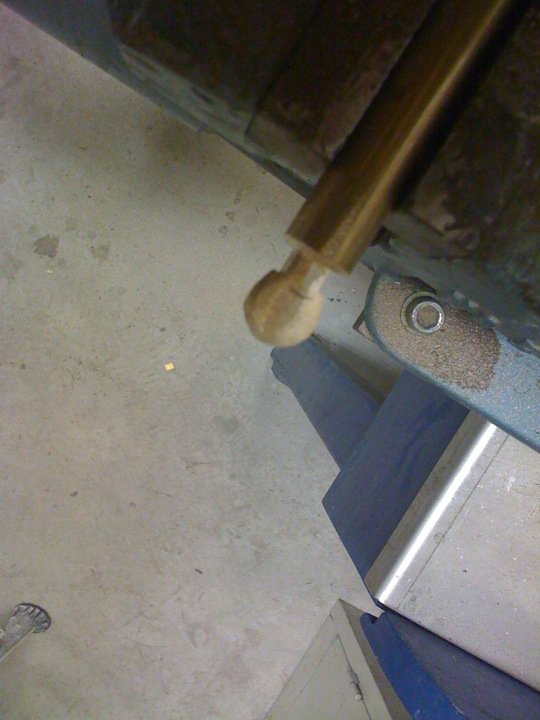

made the scallop for the point
it still needs some filing and polishing
 Attachment: 70.05 KB
 Attachment: 58.66 KB
 Attachment: 62.81 KB
marked the scallop with black marker to have a better view at the lines i'm working on
 Attachment: 76.16 KB
brazing
 Attachment: 58.78 KB
still needs more filing and polishing
Medieval Goods

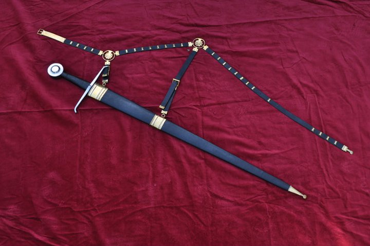

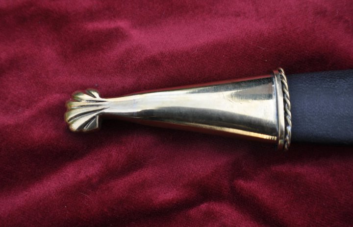

thanks for the kind words.

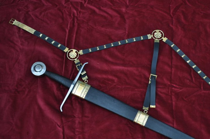

i don't think i ever posted pictures of the finished piece.
 Attachment: 55.06 KB
 Attachment: 49.95 KB
 Attachment: 54.74 KB
 Attachment: 57.02 KB

Robin Smith
PostPosted: Tue 18 Mar, 2014 12:03 pm    Post subject:         Reply with quote
Oh this is great! I love how it starts out very humble, but the finished piece is magnificent. Very cool... I especially like the chape.
Jean-Carle Hudon
Location: Montreal,Canada
Joined: 16 Nov 2005
Posts: 450
PostPosted: Wed 19 Mar, 2014 7:55 am    Post subject: Nice work         Reply with quote
Thank you for that Mr Arbeek. Seeing the whole process like this helps to remind us to keep the final result in view as we go through all the preliminary steps. When you first posted the beginning of the work on the chapes, I must admit that I would not have predicted the final result, but you obviously knew where you were going all along. Nice work.
