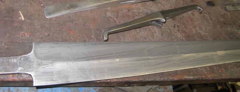

Hi all,
Some of you might remember me inquiring about "broad type XVIII" swords on this forum a while ago.
I finally chose to have a sword made in the fashion of the Castillon swords...(a loose interpretation of the one kept in The Royal Armouries to be precise). I didn't ask for a carbon copy though, and I find that the sword below exhibits features from several of the Castillon swords (the blade is certainly more slender than the one kept in Leeds). The main characteristics I was after was a broad type XVIII blade, with a clear hollow ground, and a bronze/brass pommel.
Also, I've requested a slightly longuer blade than the original.
M vickers, who is well known here in the uk for his custom swords, was the obvious choice for the job, not to mention that he has handled some of the original swords in the past. He recently sent me a bunch of pictures on his progress, and I wanted to share my excitement with you (first custom job I've ever ordered!).
I must say I'm very pleased with what I can see on those shots...I love the way Mark dealt with the hilt (especially his interpretation of the guard/quillons). I have no doubt this will be a great sword to hold and behold Happy I plan on doing the grip leather work and scabbard as soon as I get it.
stats as given by Mark:
1.35k
balance 4inch
COP 12inch from the tip
Hope you like these pictures as much as I do Happy

Hi Julien,
Looks a fine sword,
whats the width at the guard ?and what are your plans on the leather work?
i recently had one from mark,its the gothic hilt on the swords part of the shop page under the 18 carat full package sword he pictured,mine is hollow ground and about 62.5mm wide at the guard,you might like it, Wink
if yours comes in similer,handles like a dream single handed,super nice with two hands,
now the only problem you haveis comparisons on future swords, Big Grin
do you know hwen its headed your way?
and i see from the pic he still hasnt tidied up,lol.

Hi Julien,
Beautiful sword, you know I'm a sucker for broad pointy look too! Big Grin
I like the turned down ends of the guard and the hollow grind looks well done, coming to a re-enforced appleseed at the edge?
Really looking forward to seeing the finished sword.

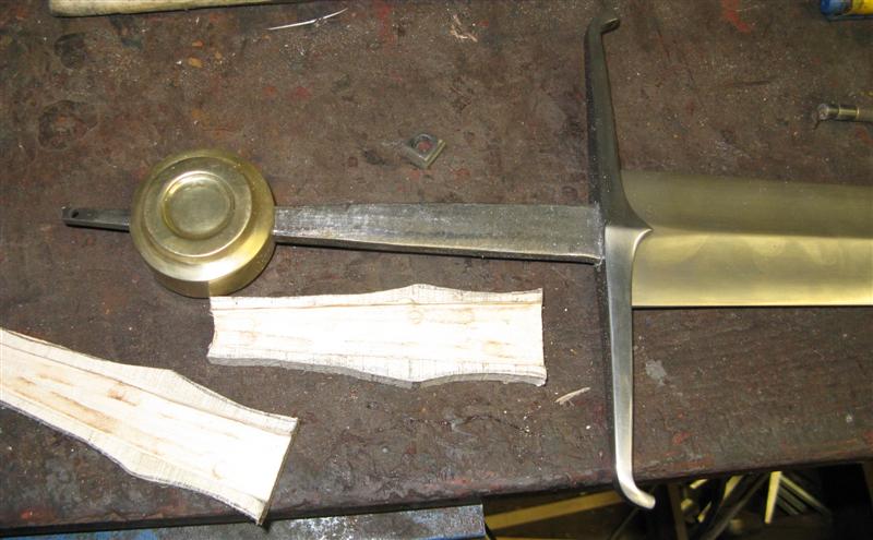

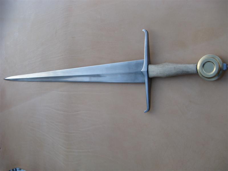

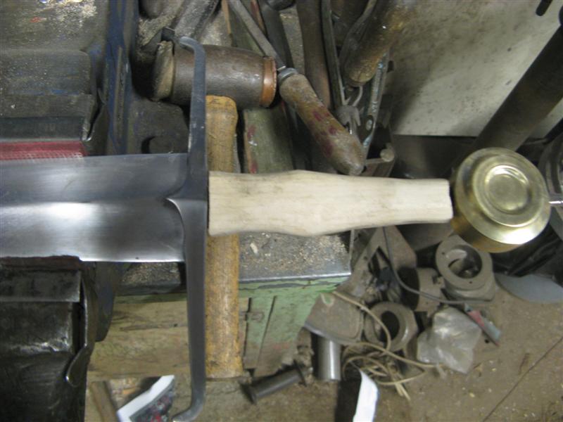

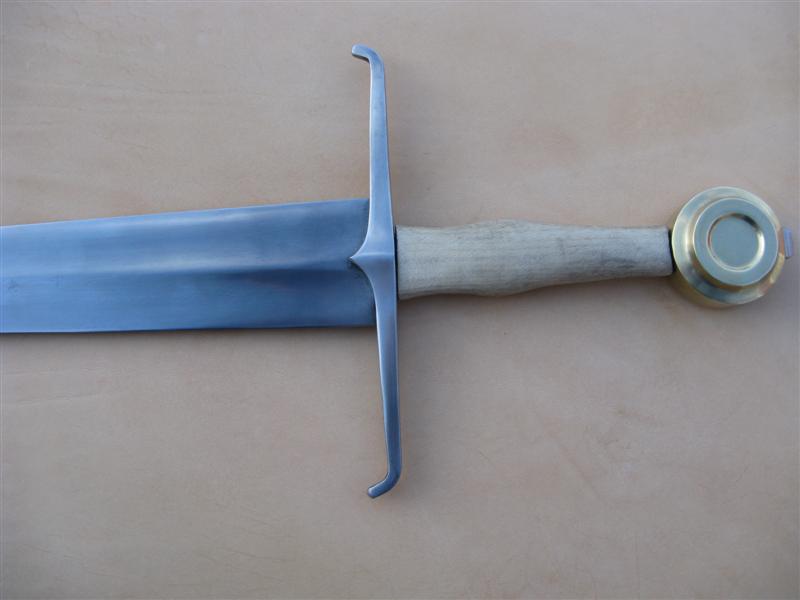

Hi all,
Mark is almost done with the sword, save for the final peening/assembly. I really like what I see here and I can't wait to get the sword in my hands to begin working on grip and scabbard. Once I'll be done with the core, I'll send it back to mark for a 2 piece locket and shape set.
Let me know what you think of those shots below.

looks beautiful and well balanced i can't wait to see how it turns out!

This is one of my favorite types. This is well done so far. Cant wait to see it done.

Love the type 8 cross and the period and style of your sword. making a well faceted and correctly shaped type 8 cross with ecusson de-novo is no easy feat. that looks great. tr

Looks like a really outstanding blade, I really love these broad bladed types.

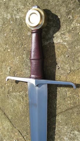

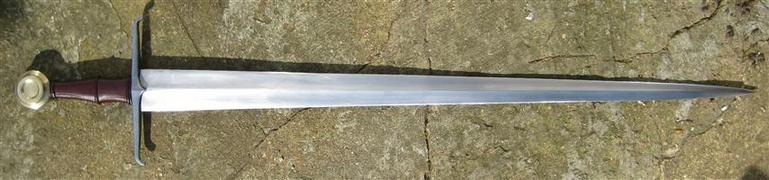

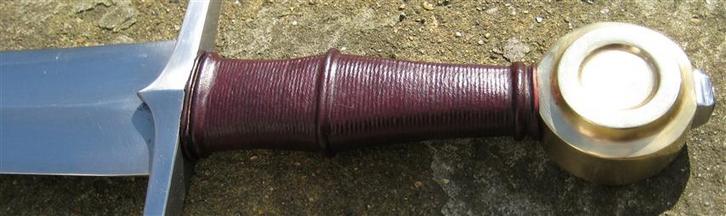

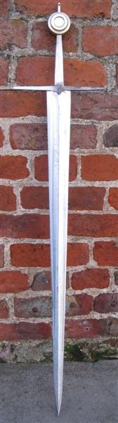

Hi all, I finally managed to free some time to wrap the grip of my Vickers Castillon sword ...so now I can show it off Happy
A few words on the sword I received a couple of month ago (I'll probably do a proper review in the coming months).
In short, it is a superb, slender and elegant blade. The hollow ground is very deep, well centered and the spine is straight.
The blade is VERY Sharp, resulting from edge geometry without much of a noticeable bevel (no bevel at all would be closer to the truth). Temper, distal taper and weight distribution are top notch...resulting in a blade that is very true to its type, cutting and trusting with frightening ease, with just the right amount of flex.
The blade, very much like my Albion Crecy, "sings" when you give it a nudge, holding the note for several seconds like a tuning fork.
The guard is very true to the original: a plain and beautiful design, with crisp lines. It is not obvious from all angles, but the quillons are very slightly asymmetrical. This was a bit of a concern at first...but I got over it as this is after all a handmade custom sword not a production or semi production sword involving CAT or cast hilt parts in the making... it does adds a bit of character to the sword. The brass pommel is very even and well made.
the polish: I requested a satin finish on both blade and hilt parts, which was beautifully executed by Mark.
Assembly: that's the only thing where improvements could be made in my opinion. I would have loved the blade to be recessed in the guard. It's not the case and there is a very slight gap on each side of the tang (less than half a millimeter but still Happy...where the blade and guard meets. Also the peen block has been crushed a bit during the peening.
Handling: the sword balance is great. Even with a bare wood grip, the handling was superb....with the leather wrap and carefully placed risers, it's even better...it is right at the top of my modest collection along with my A Crecy.
Conclusion: I am more than pleased with Mark's work on this sword. It is the pinnacle of my collection, along with a couple of Albion blade. Considering the price point, it is also amazing value for money (slightly under 500$, for a hand forged custom...). I'm surprised Mark Vickers didn't get more attention here on this forum, as he is very well established in the field in the uk and most likely in the rest of Europe. As far as I'm concerned, he's by far the best option around (a windlass will cost you almost as much in the uk!) and I will definitely order more blades from Mark Vickers in the future.

Julien,
The finished sword looks fantastic, a very elegant looking weapon. Cool
Your grip work is top notch (as always Happy ) and really suits the brass pommel.
I can't wait to see what you do with the scabbard and suspension.
Congratulations on a really fine piece!
