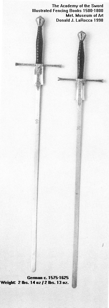

PostPosted: Fri 18 Feb, 2011 12:23 pm    Post subject:         Quote
Roger Norling wrote:
And while I am at it, I have images of three different proper federschwert, the one in Turkey which Albion used as a source, the one in New York which Hanwei used and a third Italian that I think is privately owned. Does anyone have anything else to share?
The one Hanwei used is in Switzerland, I think, not New York. You do not have that one in your article, so I included a picture below. You also don't show the pair at the Metropolitan Museum in New York, so I attached a picture of them as well.
 Attachment: 93.82 KB
Swiss Federfechter used by Hanwei
 Attachment: 115.55 KB
Practice Swords at the Met in New York [ Download ]
Regards,
Hugh
www.schlachtschule.org
Profile PM Website YIM
Roger Norling
Location: Gothenburg, Sweden
Joined: 27 May 2009
Posts: 109
PostPosted: Fri 18 Feb, 2011 12:28 pm    Post subject:         Quote
Ah, I mixed up the ones in the Met with the Swiss. :) Thanks!

Hugh Knight wrote:
I understood that the Montante was more of a grip--a ricasso with the points for protection, rather than a schilt designed to allow for a thinner practice blade--because it's a true two-hander, not properly a longsword. Is that considered incorrect? The Oakeshott example you gve seems the same to me, too, because of how it narrows inside.
Many of them do not have a long enough ricasso to grip, with some only being about two or three inches long.
I used to believe the schilt had more to do with the mass distribution, but over the years of using the design, I've started to come around to the idea of it being for protection. For starters, the name implies protection. But also there are certain techniques where your hands are more vulnerable within the safety of practice than in real combat. For example, when you wind and thrust -- If you are actually thrusting into someone, your hands are further forward, which creates an angle at the cross where they are very safe. If your hands are withdrawn (as you have to do with a practice partner where you are not really thrusting through), you either have to lift your hands a little higher, or else you can use a schilt to keep the fingers from being hit.
