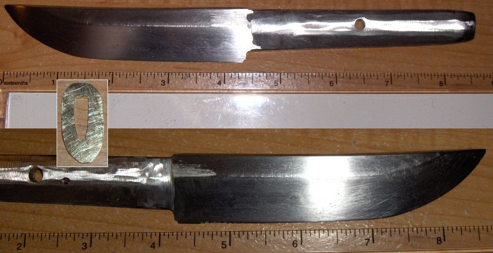

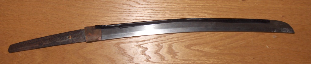

Thanks for the words of encouragement! I have a couple of pictures but I have to apologize for the quality... I need to invest in some adequate lighting, or wait for a day with a bit more sunlight.
I have just about finished grinding a tang onto the tanto / katana-tip. I may need to work a bit more on tapering it thinner - Can you call it a 'distal taper' on the tang? The tang's profile is where I want it, and I managed to get a peg hole into it. I will probably go for epoxy & a rivet, rather than a traditional grip, though. It is a pretty beefy blade for a knife - it is 1/4" thick and weighs 4 1/2 ounces as-is. The tang is 4 1/4 inches long and the blade also about 4 1/4 inches. Apologies for the black tape but the blade is like a straight-edge razor and scares me a bit. There is a faint hamon, and when I have finished the handle and removed the tape, I will try and get a good photo to show the hamon. The sketch below the blade is one of the ideas I am considering for the handle - it will be brass at either end, and wood in between.
I've got a tip outline ground onto the wakizushi / rest of the katana, but haven't started working on beveling it into a rough edge. I imagine that will be difficult. Like with the tanto, the tape is there while I'm working with it, so I keep all my fingers - and also like the tanto, there is a faint but visible hamon. I don't know what to do about hardening / tempering the tip when it is done - I imagine I will just leave the tip unhardened, while the edge remains hard.

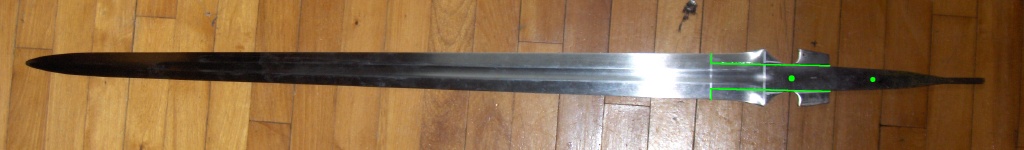

For the Del Tin blade, I've only got as far as figuring out what I want to cut away. I have some ideas in mind for the hilt but haven't got anything sketched out yet. The green indicates where I wish to cut at the shoulders and extend the tang. This will reduce the blade length from 32" to 28".

I have finished the grinding on the tanto / katana tip. One thing's for sure - I need more practice with the grinding wheel!
I've also got a grip roughed out, it's clamped at the moment while the two halves get glued together. I'll try and get the grip shape finished tomorrow. Finally, I have made a guard-plate out of 1/16" brass. It still needs to be polished but that will wait till the assembly stage.
The hamon is visible but very faint - in person, you need to tilt the blade to the light to see it. I think it's just barely visible in the attached picture, mainly around the light-bloom from the camera flash.

I like what you're doing with the Orcrist blade - it looks quite similar to my own project. Good luck. Happy

I have 'finished' the tanto... for now at least. I'm not happy with the outcome, and that's mostly because I got impatient and rushed my way through the handle work. The only positive I have is that it turned out to be a tight-enough fit that I was able to use a wood peg (mekugi?) to hold it together. I think my biggest problem was a lack of planning. I had a number of ideas and rather than settling on something I just 'winged it' and ended up with something that doesn't please me. My biggest complaint is that the handle is 'off-centre'. It's centred on the tang rather than the blade. The knife does feel pretty good - it feels a tad blade-heavy but the centre of balance is actually just inside the handle, about 1/4" inside, giving it a very quick feel.
I think what I will do is, when I have finished grinding a point onto the wakizushi, I will try and come up with a design that uses both the tanto and the wakizushi as a pair. I think that makes good sense as they came from the same blade originally, they should be treated as a set?
For the orcrist blade, I have been doodling designs for a while. Actually I kind of like the last sword-handle I made, although it was for a rather worthless blade. The blade was a cheap soft-steel decorative Toledo piece that I've had for years. The rat-tail tang broke off long ago, but I cut the shoulders down to give me a nice long tang. The Orcrist will probably get a handle similar to this -- but a little more carefully-done, and with a nicer pommel:

The tanto looks good, the thingy about the handle is one of those trial and error things I mentioned. It helps to have the tang centered on most types of blades, even if they are not symmetrical. Some blade types lend themselves to this better than others but an offset tang is something that should be accounted for in the design from the beginning. The grip material often becomes very thin near the guard end , which limits how much you can adjust for problems like this. I have learned that tang design is often critical to achieve the desired strength and still get the proportions right on some pieces.
It does help to have at least an idea of how the whole thing will come together in the end. I find more and more that drawing even a rudimentary sketch of what you have in mind can save hours of labor and lots of disappointment when something dosen't turn out as hoped. Fine tuning proportions is much easier on paper than in wood and steel. Not that you can't or won't vary from your sketch in the actual working process, but it gives you a solid starting point and allows you to address design issues before they arise in the actual workpiece.
It is very easy to get excited and rush a piece to completion but some ideas need time to ripen and for the details to form in your mind. I will sit on projects for months sometimes until a particular detail or problem clarifies itself in my head, or sometimes just to give my eyes time to absorb the proportions of a piece, and decide what needs a little more work. Especially when a project is assembled with all the parts for the first time I try to just study it for a day or two, and make any changes or adjustments gradually. Even if you spot a problem or mistake immediately, the "best" solution may be longer in coming so patience is key.
PostPosted: Sun 20 Jul, 2008 11:50 am    Post subject:         Reply with quote
If the material of the handle is robust enough the top of the handle could be flush with the tang and this would " fix " the uncentered look of the handle: This may be a problem with wood as the bottom might not be strong enough and split along the grain.
Now this would be for an non-Japanese styled handle and one could also drill small pin holes along the tang and have a slab handle pinned and glued in place.
A micarta handle could be made with an open " U " shaped slot and have an open top showing the tang.
A new symmetrical handle might be possible by thinning the top of the handle as much as possible while still keeping it thick enough for structural integrity but then the handle might have to be extended in width to compensate: The tang being offset into the handle. Visually this might make the handle look and be too wide ?
Oh, grinding away 1/8" from the top of tang might also work at long as the tang isn't narrowed too much.

Stephanie,
Would it be possible for you to get a few clear pictures of the tang (nakago) of the longer part of the sword? There should be some nice brown rust and a signature (mei), unless it was a mumei (unsigned) blade. Get any markings on the nakago into the pictures as well if you could.
It is too late to say "Don't do this!" but I want to point out a few things...
The edge of the sword you have was and is harder than the body of the blade, this means that the edge that rolls up to the spine at the tip is hardened. The tip of your wakizashi sized blade is no longer hardened like this and is going to be very soft.
At this point, the best way to fix this issue with the wakizashi blade (as both pieces are now worthless) is to cut the tip at an angle such that it would look like a seax tip, as this will keep a good hardened area there, while "pulling" the soft steel away from the tip. (see picture)
The hard portion of the blade is called the "hamon," literally "edge pattern."
You may not be able to see it on this old blade, but it is there if it is a true Japanese sword.
Be very careful to not turn any portion of the blade blue in grinding, in fact, you will want to take a nice big bucket of cold water and dip that blade in it after every two to five seconds of grinding. If the hamon gets too hot, it will start to anneal and no longer be hard. Dip often, and when the water gets warm, get new water. Better yet, use a hacksaw and cut it.
It's been said by the other guys, but i want to repeat it...
To anyone on this forum; please do not ever take an antique Japanese sword and do this unless you are absolutely 100% sure that it is 100% worthless.
It is akin to taking one of those nice migration era blades that may have survived and turning it into a floor scraper or taking a highly decorated breastplate and hammering it out into a door decoration.
 Attachment: 7.74 KB

Well, I had no idea people would be so shocked, upset, dismayed, etc. about the old katana blade. I'm sorry I've got folks upset, but I stand by my 'project' decision - whether it was fixable/repairable/salvagable, the two key points were, I bought it specifically as a project piece, and it was not fixable by me nor could I afford to have it fixed by a professional. I know the hamon is not going to follow the new point, I know the new point will not be hardened, and considering these are my first projects involving working on the steel, I know that odds are it's not going to turn out so great regardless.
I'll get some pictures of the nakago when I get the chance. There is no mei, but it does have a layer of brown rust / patination.
I've been working this past week with the Del Tin blade rather than the nihonto; cutting new shoulders to shorten the blade and lengthen the tang was fairly easy with a dremel and heavy-duty cutting disc. The hard part was putting some holes in the tang for the rivets I want to use. (Rivets might not be historically accurate... but they give me a nice feeling of security, that the handle's not going to come off!) 3/16" holes, through 1/4" of hardened steel... I have managed to do it, and without wrecking it - slow going, with damp cloths wrapped around to keep the temperature down, using cobalt-steel bits (I did manage to kill 2 bits). I have a bit more grinding to get the tang shape smoothed out from the dremel cuts, and then the steelwork will be finished and I can focus on the design and construction of the hilt.
Will get pics of the Del Tin tang as well as the nihonto, over the weekend.
