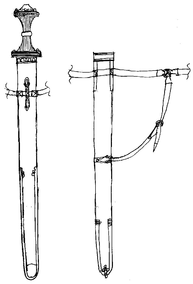

Jay Barron wrote:
Thanks for the info. Kevin and I are still working out the details of the hilt design, including materials.
I have not seen the original sword, but would guess the that the hilt is composed of horn and (gilt?) bronze.
The grip is probably a three part construction: Cone or trumpet shaped parts meeting a ring of (gilt?) bronze in the middle.
The upper and lower guards are five layer constructions: outer sheets of bronze sandwiching horn/bronze/horn. The pommel is obvioulsy bronze as well and might be hollow. A stiking feature is the simple but effective ring-dot decoration repeated on guards and pommel.
The scabbard for such a sword would probably be somewhat similar to early Vednel/Valsgärde scabbards. Through the Sutton-Hoo find we know there were (close?) contacts between England and eastern scandinavia at this time.
I would think a mouth band circling the opening of the scabbard, some kind of scabbard slide construction for the belt support and a long U-shaped "chape" that reaches across from halfway down the scabbard. Some kind of escuring embellishment at the apex of the curve, perhaps a stylized beast head.
I attach two possible versions. The solution on the left is a bit later, while the one on the right is a bit earlier. I cannot give exact datings for any without going through several books and articles. At a guess I would say that the later one would put the sword in the middle of the 7th C and the right would be 5th or ealry 6th C.
The left hand one is based on Valsgärde finds. The right hand one is based on germanic scabbards.
 Attachment: 71.51 KB
