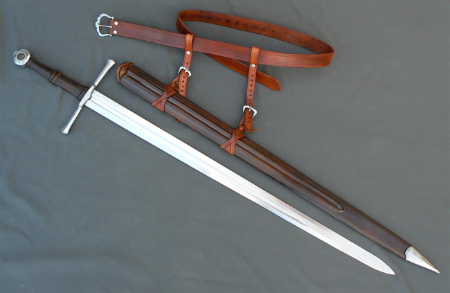

David Stokes
Joined: 23 Aug 2003
Posts: 250
PostPosted: Tue 22 Apr, 2008 6:52 pm    Post subject:         Reply with quote
wait wait wait...
In confused....
How do you get this:
from this
or was the CF proto for something else?
not really looking much alike....
or did i miss something?
Dave Smith
Joined: 15 Mar 2007
Posts: 30
PostPosted: Tue 22 Apr, 2008 8:50 pm    Post subject:         Reply with quote
The practical longsword in the first picture is from a more basic line inspired by Gus's personal designs. The second picture is a prototype of a sword that will be part of a completely different line-up called the "Signature Collection". The signature collection is based on collaborations between Gus and Christian and is due out later this year according to the Valiant Armoury website.
