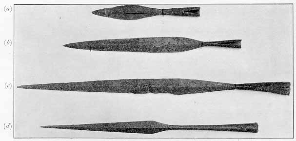

Ha... I'm trying my best to blend as much of the socket seam as I can though forging on a mandrel.. but I just saw this image of Anglo-Saxon spear heads and they show the seam and the split at the base. I might be able to blend most of the seam.. but I will certainly end up with the split:

That looks awesome. As a coincidence I have been researching boar spears for the past couple of weeks after reading up on the inventory of Henry VIII. -The armory lists around 261 of them
And I would not worry too much about having a split seam. It is featured on many originals, and with proper pinning (as you plan to do) will keep the head securely on the shaft.

And thank you about the seam. I try not to always use history as a standard for craftsmanship... but spears are still rather new for me and I will just strive to improve with every one!
