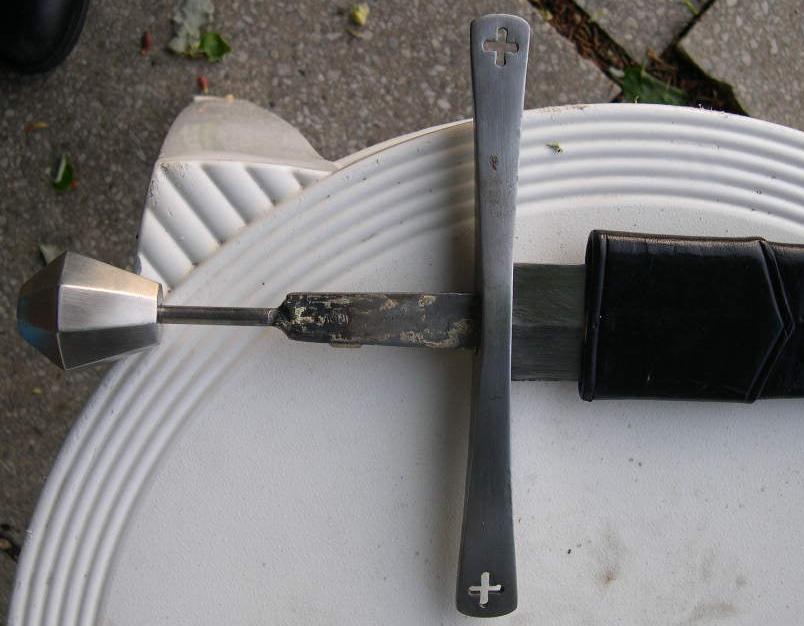

Windlass quality, especially for this piece, has drastically varied over the years. Mine was one of the earliest Windlass models, circa 1992, and had a welded tang with rat-tail, no better than a SLO. Had I used mine for cutting, I would have had a broken hilt in no time. Others here, whom have received this sword in recent years, have reported a beefier tang with no weld. Windlass has gradually improved this sword and others in their lineup, so I would say you should be okay if yours is one of the later swords.

Most Windlass pieces from that period have threaded pommels, although I have heard an unconfirmed rumor that they are peening their pommels these days. The threaded pommel would allow you to disassemble the hilt. You could do so and check to see what kind of tang you have. If you got it in September two years back, you should be fine though. I'll have to dig up the pictures of mine with it's welded tang. Of course nowadays, the eighteen inches of the tip of that sword has become my new basilard dagger, which is a work in progress (I had made a rondel out of it, but it looked really bad, so now I'm making it a basilard).

Jonathan Blair
Location: Hanover, PA
Joined: 15 Aug 2005
Likes: 9 pages
Posts: 500
PostPosted: Thu 19 Apr, 2007 5:46 pm    Post subject:         Reply with quote
Here's mine. As you can see, the tang on the early Windlass Shrewsbury Sword leaves much to be desired. I understand that now they are much better.
