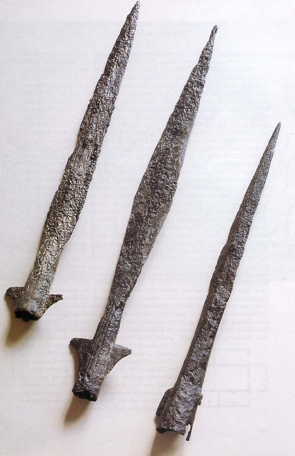

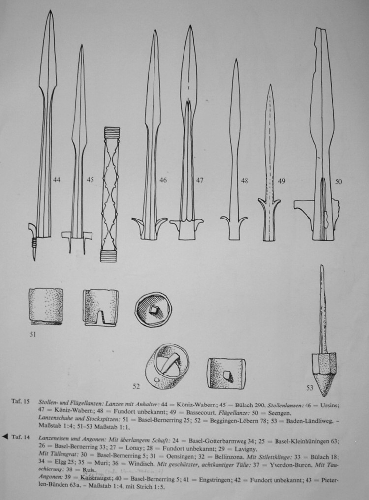

This short graphic from 'Die Schweiz zur Merowingerzeit' shows the likely evolution of the winged spear. I hope this may help you, although it lacks some dating.
The second picture shows some winged spearheads found in south-western Germany. The piece in the middle is 52 cm long and has 8,2 cm wide wings. It was dated to the 9th. century. The shorter example on the right is said to show some merovingian influence in having a hexagonal socket and is dated to the 8th. century. the blade´s cross section is also more diamond-shaped, owing to avarian influence on the weaponry of this region and period.
