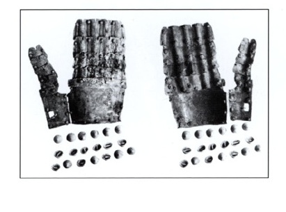

I have this image of a gauntlet, that memory tells me is ancient but that I have lost the supporting information for. I googled the image name sometimes that finds the image this time nothing.
added:
The this thread http://www.swordforum.com/forums/showthread.p...nz-Germany and the name of the image may indicate that this image is of a Sassanid gauntlet in the Römisch Germanisches Museum in Mainz, Germany
another possible thread: http://ancient-warfare.org/rat/25-allies-a-en...azpan.html
which lead here: http://schnucks0.free.fr/forum/viewtopic.php?...5:1gwk1dka
http://img515.imageshack.us/img515/2166/gante...8tknc9.jpg
pretty sure these are 6th - 7th C Sassanid gauntlets from Iran
They look pretty practical to me.
 Attachment: 33.75 KB
Roman?
image name:
 Attachment: 38.28 KB

PostPosted: Fri 09 Nov, 2012 3:11 am    Post subject:         Reply with quote
Would people classify 7th C Persian armour as "Roman"?

PostPosted: Fri 09 Nov, 2012 11:43 am    Post subject:         Reply with quote
Well there is the sassanid gauntlet shown in this thread.
