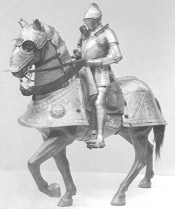

Hello to all,
I have some paintings with french gendarmes, and i´m not sure what kind of armour are them using, or they really used in combat.
I´m not sure how reliable paintings are, but looking their helmets and the fact that they are very similar, maybe they are based in a true kind of armour wich i don´t know.
Do you know wich style of armour are they using in the pics, or wich kind of armour they prefered during the frist half of the XVI century?
Thanks.

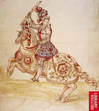

I would say probably sixteenth-century full armour with cloth bases (the pleated "skirts" worn over the armour). I think the top illustration is actually based on an illustration of an English knight (possibly Henry VIII) from a Dutch manuscript of the early sixteenth century. If you look at the image below, the mounted warrior has a similar armour, and even pose, to the illustration you posted. Note the cloth base. This particular detail is also present in the painting you posted. I see no reason to believe the painting shows anything other than a battle. Full armour is also shown in depictions of the battle of the spurs of 1513. The French cavalry decided to quit the field shortly after the English cavalry charged, with the English in hot pursuit. (Maybe it wasn't really much of a battle, but it was a battle.)
 Attachment: 20.18 KB
A mounted knight.

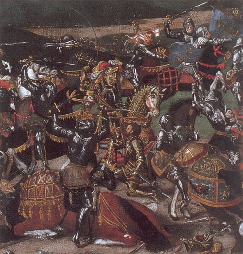

In case it helps narrow down what kind of armour is shown in the illustrations Rodolfo posted, I found another painting with roughly similar armour. The mounted warriors in the detail from "The Battle of Alexander" by Albrecht Altdorfer, 1529, also wear cloth bases. They also appear to be wearing full armour in battle.
I also found a painting of the Battle of the Spurs (or Battle of Guinegate) of 1513. I don't know the actual date of the painting, but note again that some of the armoured warriors wear cloth bases over what appears to be full armour. This armour is definitely worn in battle in the painting.
 Attachment: 74.67 KB
The Battle of Alexander (detail), 1529.
 Attachment: 97.94 KB
The Battle of the Spurs (or Battle of Guinegate) 1513.

Thanks Richard, Do you know if those gendarmes still used the ¨Milanese¨ style (Like the armour at Glasgow) and ¨Gothic¨ in the first half of the XVI century, or they used later like the armours of the picture?
Thanks
 Attachment: 16.26 KB
 Attachment: 52.04 KB
This armour dates from 1560, but there are earlier examples of the style. 1540, maybe 1520.

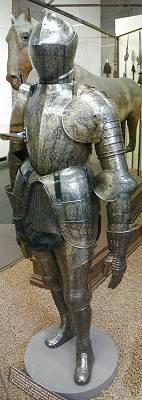

Here's an interesting Greenwich armour for the field and tournament dated 1527. The fact that it was for the field as well as tournament implies that it could indeed be used in battle. It is a garniture, which means it has exchange and reinforce pieces to enable it's use in tournament as well as battle. I think the gilding is an interesting comparison to at least one figure in the painting Rodolfo posted. this armour was made in England, but was presented to the French ambassador François de La Tour d'Auvergne. The armour is now in the Metropolitan Museum of Art.
 Attachment: 23.6 KB
English Armor for Field and Tournament, dated 1527.
Copyright © 2000–2006 The Metropolitan Museum of Art.

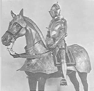

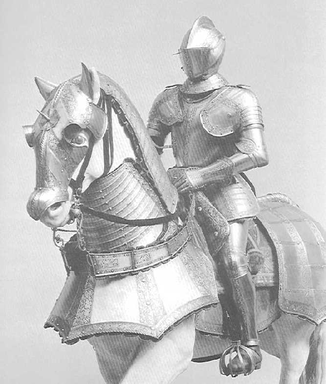

The following armours are Italian and German styles from second half of XVI century, Aren´t them very similar?
 Attachment: 42.76 KB
German horse armour ca.1550
 Attachment: 10.03 KB
Another German armour dating around 1540-1550
 Attachment: 48.98 KB
Italian harness, ca.1560 (Name Mistaken :/)
German armour. C. 1551
