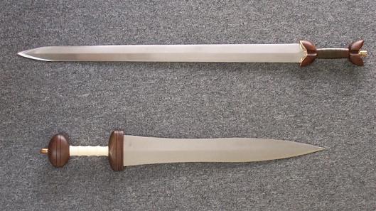

It probably depends a lot on what kind of grip you have on the sword. I use boiled linseed oil to treat the wood components of hilts. For example, I have these two swords:
These each have a guard and pommel fashioned from walnut. I put linseed oil on a rag and rub it into the wood, then let it sit there a little while. Then, I come back and rub off the excess and buff.
The sword on the top has a leather wrapped grip. I put a leather conditioner on that from time-to-time, not linseed oil.
Does that help?
