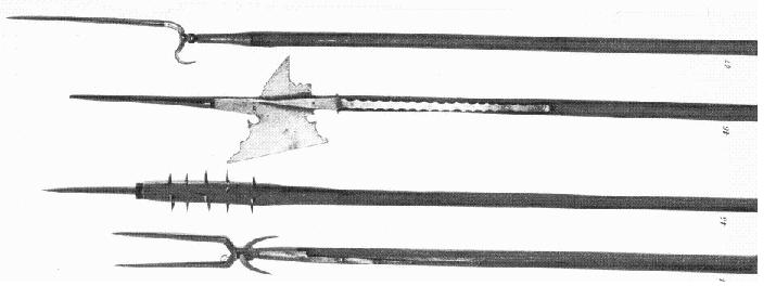

I've posted the photo from Courtlandt Canby's A History of Weaponry, since the supposed "sackbut" is rather hard to describe. Note the military fork in the middle of the photo below. See how the side-spikes are hook-like. They could be used to hook a man out of his saddle, or pull him to the ground. Note the strange weapon all the way to the right. It has an upright spike and a hook on the opposite side. Canby calls it a "sackbut". What would the name be for this unusual pole arm?
I hope this helped!
Attachment: 30.66 KB
![Pole arms from A History of Weaponry.JPG](files/pole_arms_from_a_history_of_weaponry_754.jpg)
Pole arms from A History of Weaponry by Courtlandt Canby.

Richard Fay wrote: | Hello again!
I hope this helped! |
The military fork with the hooks might also be used in moving " fascines " ( Bundles of woven sticks used as field fortifications. ) Tool used to move them in place or used in an assault to create a breach in this type of defence.
Weapons use being also a use. ( Read this somewhere but can't remember where on when ! So, it needs to be taken with a grain of salt or fact checked. )
The unusual one with one bent arm looks like some sort of fork musket rest with some weapons application in lieu of the later bayonet ?
![](images/avatars/25712693861015298c70fc.gif)
Posted: Tue 02 Jan, 2007 1:09 pm Post subject: |
The weapon at far right is interesting, and I'd agreethat it's a musketeer multi-tool (and like multitools throughout history, probably a jack of all trades, master of none). It looks like the kind of thing a soldier could easily have created from a military fork. It actually makes good sense to equip musketeers in this fashion. Since the alternative is to "club musket," I'd much rather have one of these when the cavalry break through the pikemen.The nodus between head and socket suggests to me that it's a later weapon--late 16th or 17th c.

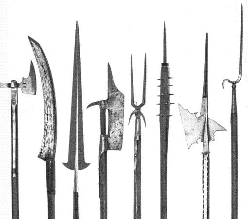

Just in case it will help the discussion about the weird weapon Canby calls a "sackbut", I've included the photo without cropping its width (I just turned it, and cropped out some of the other pole arms). I wish I knew the full length, or even had a full-length photo, but Canby didn't even give a date for this thing.
Modified or abberant military fork, perhaps?
Attachment: 21.31 KB
![Sackbut from Canby's A History of Weaponry.JPG](files/sackbut_from_canby_s_a_history_of_weaponry_745.jpg)
Ploe arms, including "sackbut", from Canby's A History of Weaponry.

The odd musket-rest-come-pikestave could well be a member of the elusive "Swedish Feather" clan. Or maybe something else entirely, depending upon it's length. But if the stave itself is under 5', then I'd vote for a type of Swedish Feather.

Interesting. "Sackbut" is the name of the precursor to the modern trombone. From Wikipedia (bolding is my addition):
Quote: | The Sackbut (var. Sacbutt; Sackbutt; Sagbutt), a brass instrument from the Renaissance and Baroque Eras, is an ancestor of the modern trombone. The name is derived from the Middle French sacquer and bouter ("push" and "pull") and the term survives in numerous English spelling variations including sacbut, sagbut, shagbolt and shakbusshe. In France, the instrument was called sacqueboute; in Germany, Posaune, and in Italy, trombone. The term sackbut is used to differentiate the historic instrument from its modern counterpart. Increasing interest in authentic performance in recent years has brought many trombonists to the sackbut. |
Perhaps the "push" of the pole and the "pull" of the hook give this weapon a similar name...

That's similar to what Courtlandt Canby claimed in the caption to the photo in A History of Weaponry:
Courtlandt Canby wrote: |
A sackbut, a word derived from the French saquer, pull, bouter, to thrust. |
