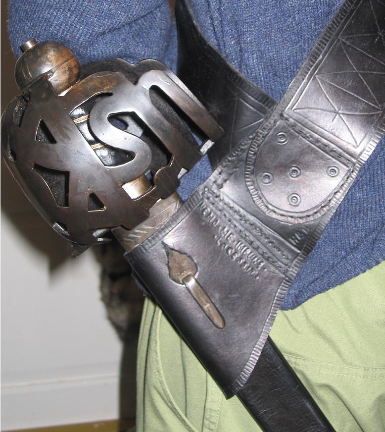

Hi all,
A couple of days ago I finished a baldric for my Ribbon-hilted broadsword by Donnie Shearer. I made this baldric using a pattern that Donnie gave me, and decorated it with symbols, lines etc that I tooled into the leather. As you can see from the pictures I added a little latin text on the frog; "NEMO ME IMPUNE LACESSIT", which is the National Moto of Scotland. I made the tip and keeper using brass sheets, and stamped these with my initials: HBB, just to give a simple decoration to the rather plain brass pieces, and of course to sign the work.
It's really late and I have to get to bed, so I'll just post pictures now, and tell more about the method etc later...
Henrik
Attachment: 77.56 KB
Attachment: 90.4 KB
Buckle, keeper and tip.
Attachment: 98.56 KB
How it looks from the back. [ Download ]
Attachment: 115.23 KB
The frog. Notice the text. [ Download ]
Attachment: 53.76 KB
and a picture of it from the front. (Aye, I'm in the picture and am sorry to say I've not dressed up in my plaid!) [ Download ]

I had some 2mm thick brown coloured cow/ox leather that was leftovers from some other small projects that I've had. It's been laying about for a few years, and when I got the broadsword from Donnie I knew I needed a new baldric for the sword. Donnie sent me a fine baldric pattern with good instructions and I decided to try making it. I got some different double-D buckles from Jas Townsend and chose one of these for the project.
First I cut out the pieces of leather and left them in water to make them easier to work with. I then made holes for the seams with a thin leather-awl. I used a waxed linen thread and did a pitch seam. I sow the main parts together (not the keeper), fitted the buckle and secured it with a pitch seam. I made holes in the belt to fit it with the tongues on the buckle and tried wearing the baldric. I then made the hole in the frog for the froghook on the scabbard.
After this was done, I started cutting out the brass pieces and filed the edges. I then made similar pieces to these to be placed on the backside of the leather. I drilled through the brass front- and backpieces and and made holes through the leather so that I could drive brass nails through. I then cut the nails shorter and bent them on the backside of the belt, so that they were firmly in place. I punched the "HBB" into the brass as decoration. The same process was applied on the keeper-part, but with a few differences... I then did some polishing of the brass, and finished the polishing with some 0000-steelwool.
I then sow the keeper on...
I put the entire baldric into the bathtub (save the brass-pieces, these were held above water). I used normal cold water. I left it there for about ten or fifteen minutes, I think. The idea was to get the leather wet, but not straight through. I placed the baldric on a working bence and used a special tool to draw the lines etc. into the leather. When I was done decorating it I dyed it with a black leather dye. This leather dye is works best when the leather is wet, so it was ideal to start it as soon as the tooling was complete. To get a satisfying colour, I had to apply the dye some 6 to 8 times. I hung the baldric to dry after the dye had sunk into the leather and left it over night.
I treated the baldric with leather oil till it was softer and tougher than before the treatment. I used black shoeshining in a thick layer and left it to set for about half an hour. I polished it off and covered it with waterproofing wax and let it set for about as long as the shoeshining. Then I polioshed it with a soft cloth, and voilą! Done!
I think I've summoned it up without leaving anything out...
