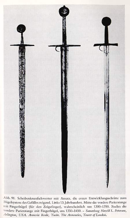

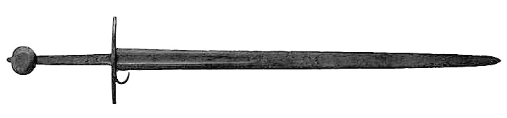

This sword can be seen in the Armeria Reale Museum in Torino. It dates to around 1350. I'd say the blade is around 35 inches long. I can't quite determine the blade type. The cross section is hexagonal or maybe lenticular. Perhaps it is a XIIIa. Or maybe it's a XVIa. I find it odd that XVI's are described as having a flattened diamond cross sectilon between the end of the fuller and the blade tip, while on XVIa's, the same area is hexagonal.
What Oakeshott Blade type do you think this sword has?
 Attachment: 12.69 KB
 Attachment: 42.61 KB
the one in the middle

Hello Roger.
That's an interesting sword that certainly does not fit neatly into any of Oakeshott's categories.
Looking at the overall profile it appears to be more dedicated to the cut than expected for an XVIa. It appears to have features of both XIIIa and XIX, so I would call it a transitional form between these two types. (Although the fuller is a bit wide for either type.) I think Oakeshott himself suggested a functional similarity between these two earlier and later types, so this sword could make for a 'missing link' of sorts. The dating seems right for this conjecture as well. Interesting.

PostPosted: Sat 23 Nov, 2013 1:04 am    Post subject:         Reply with quote
I think it can be classified as a XIIa, fe roms XIIa.3 also with a short fuller, because the guard has a finger ring, a later dating around 1400-1420 is plausible.

PostPosted: Sat 23 Nov, 2013 1:10 am    Post subject:         Reply with quote
I'd say XIIa rather than XIIIa, based on the profile taper and relative pointiness.
That said, there are swords that just don't fit neatly into Oakeshott's system and this is clearly one of them. Typologies are by necessity based on typical specimens, and there are always some inconvenient outliers like this that get left out.

PostPosted: Sat 23 Nov, 2013 6:30 am    Post subject:         Reply with quote
Well, I found some more information and better quality pictures of this sword.
They say it's from around 1350, probably based on the museum's own estimate. Personally I think the only obvious element that would cause any reasonable doubt about that date would be the primitive finger guard, as otherwise the sword is, at least superficially, extremely similar to many XIIa and XIIIa from that period (as well as many early XVII, especially considering the hexagonal cross-section and short fuller). The finger ring looks to be a separate piece welded onto the guard, at that, and without a closer look I think it could even be a later addition to an earlier made sword, possibly...
It's kind of an odd bird in several regards. To me it seems plausible to think of it as an early experimental, transitional form.

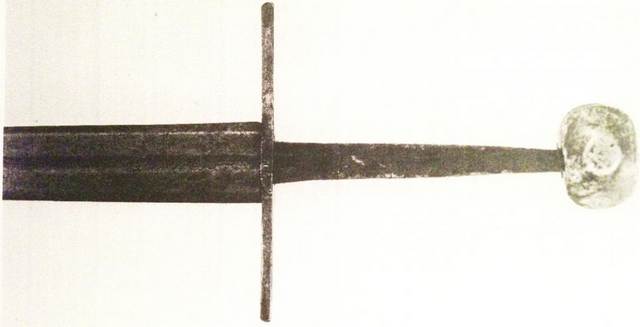

PostPosted: Mon 25 Nov, 2013 2:10 am    Post subject:         Reply with quote
It actually does seem to have a clear hexagonal cross-section. It's stated in the text description I linked to, and while the picture quality and lighting are really not the best you can still see the distinct flats and bevels in all the photos if you know to look for it.

It has a hex section, as Roger points out. The fuller's not narrow, but is short and well defined. To me it doesn't fit any Oakeshott type, but it's closest in style (especially including the hilt) to a XIX in my opinion. It's not close enough to the XVIs and XVIIs people are talking about. I don't find it to be that close to the XIIs and XIIIs people have mentioned.

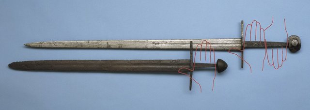

of course Iam happy with any classification as long as it explains how the sword looks like, so also type XIX with alterations will work fine.
For me personally it has more in common with an arsenal sword in the Royal Armouries. two hander, flat blade with hexagonal geometry, short fuller, moderate tapering towards the tip, straight cross, eso.
more than half of alexandria swords with finger ring is of a different type than XIX, so for me this is not a useful criteria.
the RA sword is published in roms;
XIIa. 3
Type: XIIa
Find-place: Alexandria, the Arsenal
Collection: The Royal Armouries, H.M. Tower of London. IX.915
Blade-length: 35&1/2" (90cms)
Pommel-type: A variant of Type K
Date: c.1350-1400
Condition: Almost perfect, except that the grip is lacking. There is an Arabic inscription incised in the fuller just below the hilt, which has been translated as 'Inalienable property of the treasury of the marsh province of Alexandria, may it be protected'. There is a smith's mark on the tang.
This was sold in 1960 in the D'Acre Edwards sale at Christies, where I tried for it myself, and ran Sir James Mann up a a good deal, but of course he beat me.
Publication: Dufty, Plate 4d
Oakeshott SAC, Plate 29, where is is erroneously classified as of Type XVIa, instead of XIIa.

PostPosted: Mon 25 Nov, 2013 8:41 am    Post subject:         Reply with quote
Cornelis,
The RA sword has a strong hex section you would think would disqualify it from being a XII. Yet that's what Ewart called it. Happy It just shows how much variation is present in medieval swords and how they defy neat classification as a whole.
I don't see these two swords as being as similar as you do. Variety of opinion is what makes life interesting. Happy For me, the different fuller width and length (in proportion to the blade overall) as well as the different tip shape make these different enough for me that I wouldn't automatically put them in the same type. The RA sword is also not a prototypical Type XII due to its section.
