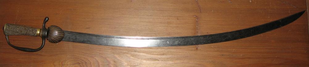

Jonathan Hopkins
PostPosted: Fri 13 Oct, 2006 8:15 am    Post subject:         Reply with quote
I have a late 18th century wakizashi that is weighs 1 lb. 1.5 ounces and is 21.25" overall. In the album, I have a hilt photo of my English hanger c.1720-1740 that weights 1 lb. 4 ounces.
 Attachment: 87.46 KB
Low-res shot of the Wakizashi (Sorry--don't you love it when people borrow your camera without asking, forcing you to use antiquated technology?)
 Attachment: 26.7 KB
Overall shot of the hanger. [ Download ]
Last edited by Jonathan Hopkins on Fri 13 Oct, 2006 12:38 pm; edited 1 time in total
