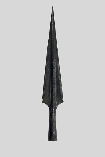

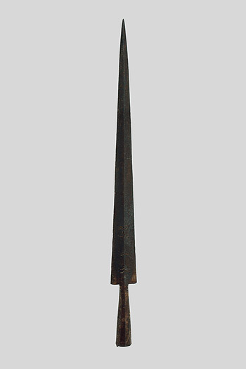

I don't have Waldman's book in front of me, but I can at least say that the size and form of this weapon looks reasonable for a partisan. The "captain" ID is convincing. Officers typically adopted the spear as a badge of rank, and this one (I'd call it a partisan) is a very fine example, with what appears to be etching/gilding and a tassle. The haft isn't much of a concern because this may not be a field weapon. We may be seeing the officer in his finest, fit for parade, with his fine badge of rank. I can easily imagine that this shows a captain of a bodyguard or other elite unit.
Combat spears/partisans of this era often have very long heads, by the way. Here are a couple from Czerny's, ranging from 17 inches (43 cm) to 27 inches (69 cm). Hunting spears like the one shown here (225 cm OA, Hermann Historica) were adapted for martial use. The broad-bladed boar spear became a common officer's weapon.
Waldman's book sometimes gives width-to-length ratios for some polearm heads, so I'll see what I can dig up....
