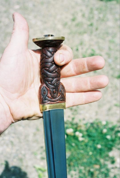

PostPosted: Tue 24 Jan, 2017 3:10 pm    Post subject:         Reply with quote
I've got a Windlass blade and one from Crazy Crow which looks extremely similar to the Track of the Wolf one and is likely from the same maker -- similar or identical profile, slightly off-center tang with a narrow threaded end, even the same INDIA stamping. The Windlass is nice but I think it clearly resembles a modern regimental-style blade, even though it's not etched. The Crazy Crow and TotW blades are more like 18th-century ones, albeit somewhat less acute than most from the time, and the Crazy Crow at least is rather bulkier and heavier than the Windlass.
For the sheath: I've seen photos of several examples from the late 17th to early 18th centuries with what appear to be leather sheaths, which are presumably back-seamed, are tooled and feature a brass chape with scalloped top edge and ball finial (a small lamp finial will do for that, though it's probably not strictly necessary). This one could be a good idea for simple tooling; admittedly the leather might be new, because it's in awfully good shape, but it's claimed to be original.
At a guess, I'd say that wood scabbards with thin leather facings probably also existed; after all, not even all cowhide is heavy enough for large all-leather sheaths, let alone calf, deer, goat, sheep... but I can't think of examples off the top of my head.
Attached is a pic from IIRC an old build-along album by Vince Evans which I can't seem to locate on the Web anymore; hopefully this can give you some idea about proper hilt sizing, though someone else more knowledgeable than myself would be able to explain it better.

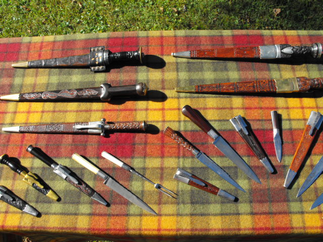

Christopher Gregg
Location: Louisville, KY
Joined: 14 Nov 2007
Posts: 675
PostPosted: Tue 24 Jan, 2017 4:29 pm    Post subject:         Reply with quote
Here's some dirks copied from the National Museum of Scotland. They should give you some idea of the styles of the era.
 Attachment: 113.03 KB

PostPosted: Tue 24 Jan, 2017 6:56 pm    Post subject:         Reply with quote
Who made those two dirks? I've not seen them before.

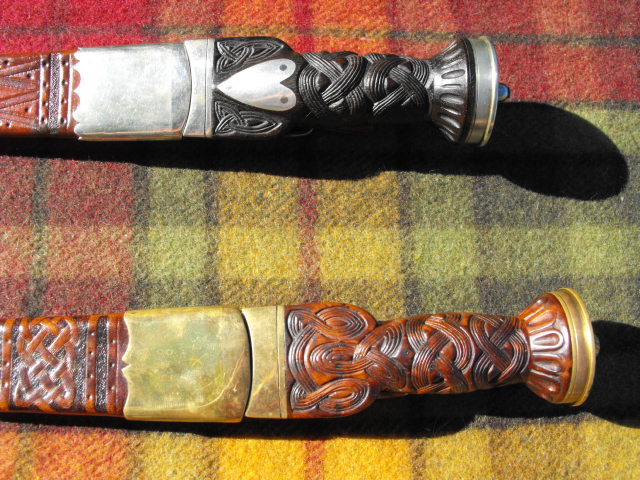

PostPosted: Wed 25 Jan, 2017 3:40 am    Post subject:         Reply with quote
Nathan, these were made by Glenn McClain of Morgantown, Indiana. He has been a knifemaker since the 1960's. Here are a few more of his Scottish knives that I own.
