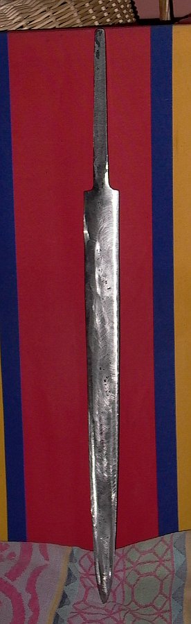

You will pardon me the defects of this picxties .. pictures.
they are taken with an uncontrollabole digital camera, plus an incorporated flash on the camera's lens' axis:there are shadows that alter a bit the point profile, also there appear to be irregularities that do not exist.
Defects of the surface are greatly enhanced. Please remember that I'm not yet finished grinding it, it is still unpolished, a thing that will be completed after carburizing.
The tang has yet to be enlarged a bit and distally tapered for balance.
this is the first rough grinding, tomorrow I will be at the forge and grinder again.

Tang. Pic more realistic
 Attachment: 72.95 KB

This tang is to be corrected slightly leftward by hammering it hot, with a few gentle strikes.

That's some pretty impressive work for your first time, I'd say. I'm working on my first knife and I've just finished the rough forging and I'm planning on finishing it on the grinder. Your tang shape is very good, I especially like the shoulders where it meets the blade. Did you do that with the hammer or did you grind those nice curves in?

I corrected them slightly after forging, most of the shape was already there.
Also the tang needs to be corrected by a very narrow angle lenghtwise, it is almost invisible if not observed in silouhette.
I have measured an actual type XII sword, rusted but still in decent shape, tang has a clear distal taper narrowing towards the end, as well as a clear profile taper.
It even has a fuller itself. (sorry no pics because of the private collection stuff etc.)
I don't know if I will be willing to amke a fuller, not much profile taper will be needed, a distal taper will be instead ground.

The blade looks lenticular in the early pics to me and more diamond shaped in the last few ? Assuming we are looking at the same blade.

Lenticular, possibly with a very short and narrow fuller, as i saw in a work by Boccia (pics are tricky, especially because for want of time I use a flash, which makes strange effects).
At this point I could still forge a fuller, which is likely less risky and difficult than grinding it, I would have to find extra time to forge the proper tools.
