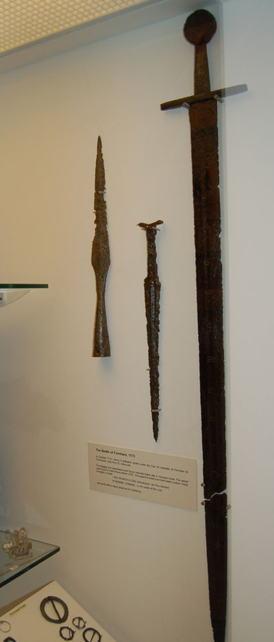

In support of the latter, Strickland & Hardy in Warbow suggest the French men-at-arms were ordered to cut down their lances for use on foot before Poitiers, whilst Juliet Barker in Agincourt reports the same happened before Agincourt.
The only example in David Nicolle's Arms & Armour of the Crusading Era 1050-1350 is the 12th century Fornham spear, housed in the Moyse's Hall Museum, Bury St. Edmunds and shown below; but this being a lance point is conjecture.

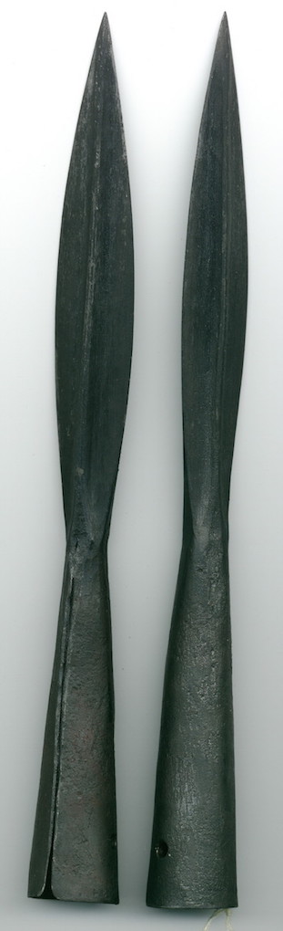

Hector Cole lance head, copied from a 15th cent original somewhere...

Mark, thanks for the info and the photograph, look forward to seeing the Madrid heads.
Fab, it is very kind of you to post your PhD thesis like this; the photographs of lance heads in Part 3 chapter II are excellent. It's going to take a bit of time on google translate but I can see it will be worth it! I suspect, as few if any English/Scots examples, I will have to reproduce one of the continental examples and this information will be invaluable.
