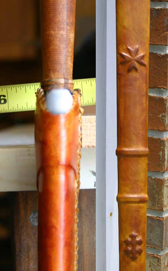

I have been working on another do it yourself (DIY) scabbard for my Albion Sempach.
I should receive leather (for the suspension straps) in about a week, and would like input from the forum on what longsword suspensions people find to be o.k. historically, but also more of a favorite in terms of functionality. I have two questions I am sure someone will have a good answer for.
1) In many cases there were 3 straps (often two straps at mouth/locket area attachment) in longsword suspensions even though there were usually just two attachment points at the waist belt and the scabbard. Is there a functional problem with just 2 straps? So far I am planning on something pretty similar to the Brescia scabbard. http://www.albion-swords.com/swords/johnsson/...bbard.htm.
2) Would adjustable buckles on suspension straps be just plain wrong historically? Christian Fletcher’s web site has an image (ATrim Danish two handed model?) showing an adjustable and detachable suspension concept. This appeals a lot to me since one could switch a favorite suspension between several scabbards. http://www.christianfletcher.com/Catalog/Scab...bards.html
The scabbard is supposed to be my imagined idea of an antique Hospitaller’s scabbard, based on the sword typology (T2) and period activity at the defense of Rhodes. I literally beat the leather with a sledge hammer (while wet and wadded up in a towel) but didn’t get it as distressed as I wanted. It is an inch or so longer than the sword, and a brass nail has been driven through the back side of the “moat sale” chape (cut down shorter than as Albion sold it, and wire brushed to give it a duller worn look.) I kept this one lean, and think I am at the limit of what I can do while incorporating substantial quality wool lining and leather materials.
Finished weight (no straps or belt) ~ 14.5 ounces (.41 kilograms)
Maximum Thickness ~ 1” at mouth, embossed / simulated locket area (wool turned down over mouth to prevent it from coming loose at the mouth opening.
Average Thickness – ¾” (19 mm.)
Breakdown of average thickness;
 Cavity required for blade …. ……………………..¼” (34%)
 Compressed wool (~1/16” wall) lining …………~1/8” (17%)
 Covering (2/3 ounce calf) .................a little under 1/8” (15%)
 Wood (1/8” wall laminated, passed 210 lb “balance beam/step test”) ~1/4” (34%)

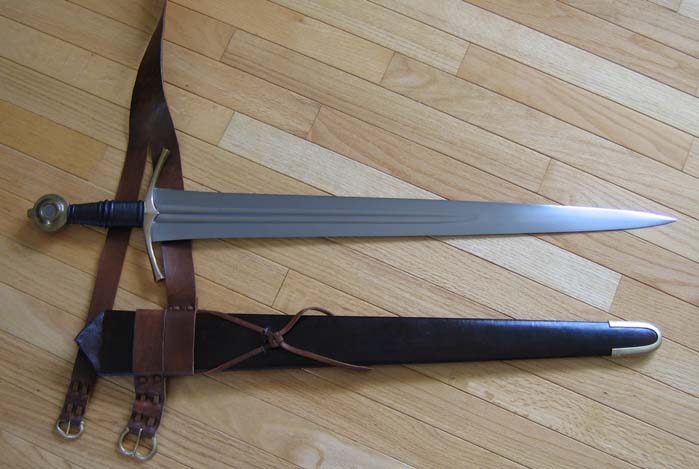

While I can't offer much regarding scabbards, I can touch upon the topic of longsword suspensions with a little bit of confidence.
My personal favorite suspension type can be upon page 87 of "A Knight and His Armor" by Ewart Oakeshott. I've also seen it somewhere upon Albion's website. The picture below is taken from "A Knight and His Armor".
The suspension consists of two seperate main pieces. A simple belt of about 1/2 width with a ring or buckle located at the center of the back and about 6 inches of extra punched lether at the belt end. The second section consists of two strips of leather which are wrapped around the scabbard in two places using a special technique which insures that the scabbard cannot slide, as well as assuring that the "ties" won't come undone. I've used this system with both a longsword and rapier without any problems.
Here is a picture of the suspension upon my MRL Longsword.

Although my post seems to have been ignored, if you look at the first photo of the suspension for my MRL longsword, it is designed to do exactly what you're looking for. The hangers have a "buckle & hook" system which allows the scabbard/hangers to be disconnected from the belt without the need to actually remove the belt. Using a modified hanger style could allow you to use the same concept of "buckle & hook" for attaching several different shapes/styles of swords (but not at the same time, of course). It also has the benefit of being relatively easy to unhook the scabbard/hangers from the belt when sitting down.
As of yet, I have not used this with a triple hanger system, but I plan to redesign it for such for my new A-Trim longsword when I recieve it this fall.
As I've stated before, I'm pretty sure that the design is historically accurate and I've cited the source from Oakeshott's book in my previous post. Somewhere I have another, much better, image showing the same style hanger system in detail, but I've no idea in which book it is hiding. Confused

Well, it's Arnow, not Arrow, but it's close enough. Happy When I wear a sword (check out my collection gallery, I have 3 longswords including the Sempach. I've bought and sold several others. I've owned a few over the years Happy ) they hang diagonally as most people wear them; hilt leaned forward, tip leaned back. That's about the only way they can be drawn. If you draw the sword from the position seen on effigies, you'll draw the pommel straight into your armpit. Happy Many, many effigies seem to depict the person lying down. If that's the case, the sword would have to be depicted basically straight up and down. People lying down, though, aren't necessarily interested in drawing their swords... Also, with effigies, if the sword was depicted at a wearable angle, the tip would jut down into the tomb lid and the hilt would jut up. Monumental brasses are 2D so it would be hard to depict the sword at a drawable angle unless you show it angled it across the body like in the Trumpington and Setvans brasses, which are much earlier. But, since many of the subjects are lying down, the point about how to draw a sword from that position is largely moot.
With the plaque belts, many times a simple hook hanging down from the belt engaged on a ring on the scabbard (either on the back edge or the back side of the locket. In that case, the sword is hooked on at a single point. and will hang, by virtue of weight distribution, not straight up and down: the hilt will cant forward. When lying down, though, it's possible for it to be flat and in the plane with the body. The scabbard can be easily taken off the hook and set aside with minimal fuss if you have to sit down.
The rig the other Chad posted is historically accurate, but I personally wouldn't pair a rig from the mid-15th century with a sword style popular in Germany and England at least a quarter century earlier, if not more. But that's just my personal preference. If you're looking to portray the early 15th or late 14th centuries, I don't believe that belt rig is the most accurate choice. Functional? Yes. Attractive? Yes. Historically accurate? Yes, but later in the 15th century.

The upper waist belt and the lower sword straps merge from between my left hip and spine and are a single belt around the back to my right hip, where they again branch off. See below for one end of the split.
Of course, with the Solingen and with my scabbard, based off an effigy from the 1st quarter of the 14th century, are earlier than the Sempach. Happy
