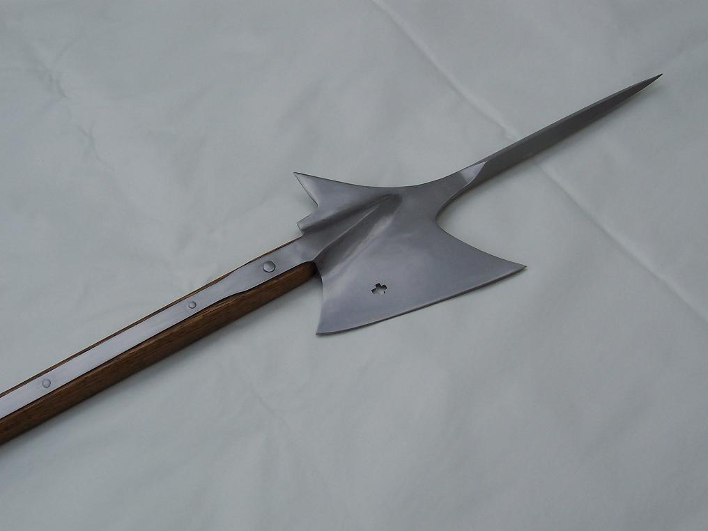

PostPosted: Thu 02 Mar, 2006 6:54 pm    Post subject:         Reply with quote
Well, the halberd I have is based on historical examples and measures roughly like this:
I and 3/12 inches at the socket and head
The spear is 3/4 of an inchand tapers to a point
The axe part is about 1/4 inch
Hopes that helps

Just han another thought... you mention you want to build a 15th century halberd but the pattern that you are looking at my be a little too early for 15th century?

Eric Nower
Location: Upstate NY
Joined: 22 Dec 2004
Posts: 174
PostPosted: Tue 07 Mar, 2006 7:07 am    Post subject:         Reply with quote
No, I don't think so. Mines based on historical examples from the mid -late 15th. I think I said that right Eek!

Russ Ellis
Joined: 20 Aug 2003
Posts: 2,608
PostPosted: Tue 07 Mar, 2006 7:59 am    Post subject:         Reply with quote
I'm sorry I should have been more specific as to who I was talking to. I agree that yours is a 15th century pattern to the best of my knowledge. However the one that Vaclav is referencing appears to be an earlier pattern.

Eric Nower
Joined: 22 Dec 2004
Posts: 174
PostPosted: Tue 07 Mar, 2006 10:27 am    Post subject:         Reply with quote
Russ Ellis wrote:
Ahh right, my mistake as well.
