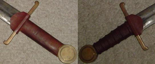

Welcome! I can't add a whole lot to what Patrick and Chad have already mentioned. I do have one thought, though. If the pommel is threaded, and you need to put in a leather spacer, you could take the grip off as well, and put the spacer, in the form of a rain guard, between the guard and the grip. It would be historically accurate for the period to which the Arbedo belongs, but it would cause it to deviate from the original even more. It's up to you.
Just in case you need a picture, here is what I am talking about:
These are from when I re-did the grip, which is why there are two different pictures of the same sword together.
-Grey

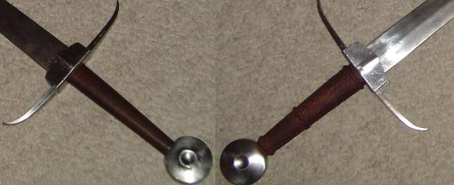

PostPosted: Mon 09 Jan, 2006 3:46 pm    Post subject:         Reply with quote
Thank you guys so much for your help. I looked at the sword's pommel and it appears to be welded instead of threaded but I could be wrong. Will I be able to get it off or tighten it at all? I have attached a few pictures to show what I mean.
 Attachment: 122.22 KB
pommel pic
Greyson Brown
Location: Windsor, Colorado
Joined: 22 Nov 2004
Reading list: 15 books
Posts: 815
PostPosted: Mon 09 Jan, 2006 3:49 pm    Post subject:         Reply with quote
Shae,
What you are looking at is where the end of the tang was peened and then ground flush. Though it does look like they might have done some welding in order to build up the area around the tang. That being the case, you should be able to use the information provided in Patrick's link, but I can't guarantee anything.
Trying it shouldn't be a problem, though. If it is welded and welded well, it just won't make a difference. If it is not welded or is welded poorly, you should be able to tighten up your sword just fine.
