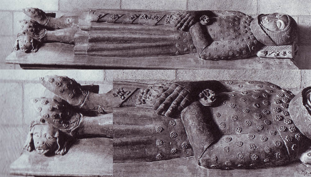

Here is one from 1299 that looks something roughly like it. The discs on seem to be more of decoration than armor. And it could be there are plates under it but it is not clear like on some of the effigies that have coats of plates.

There is however, pictures in a manuscript (to wich I lost the adress and forgotten the nam, duh!) where several knights have coat of plates with big, round spots on them. Much like the picrute above. Most likely they are washers to prevent the rivets fron going through the fabric/leather covering. The main fault with the picture above is that the soldier seem to have a loose garment whereas it should be a much tighter fit. and the "rings" och whatever to call them should be sitting in rows along the edges of the plates underneath. Undoftunately Mr. McBride was not always the best at listening to the authors descriptions... This is not the only picture in which he has done something similar. If you take a look in "Medieval Scandinavian Armies" you will find a strange detail like this in virtually every colourplate in the books...
So it's most likely just a VERY large amount of artistic freedom in displaying a coat of plates...

Not the illustration I had in mind but one can certainly see why the above "reconstruction" might have come from...
The manuscript I had in mind is "The Romance of Alexander" (MS. Bodl. 264) from Bodelian library.
As you can see in some of the pictures below the coat of plates is quite loose from the waist down. Mostly ar though tight fitting and ends at the hip or higher. The rivets and/or washers are quite large. This proportion must be carefully considered as artistic freedom too, but most likely it was an important feature of the garment so the artist wanted to be sure to get all the details in the picture, even if this ment that actual size had to be reconsidered.
Some examples..
http://image.ox.ac.uk/images/bodleian/ms.bodl.264/51v.jpg
http://image.ox.ac.uk/images/bodleian/ms.bodl.264/59r.jpg - Just a few CoP but several other interesting features regarding gaunlets, surcotes and falchions...
http://image.ox.ac.uk/images/bodleian/ms.bodl.264/60r.jpg
http://image.ox.ac.uk/images/bodleian/ms.bodl.264/66r.jpg - Especially lower left side...
