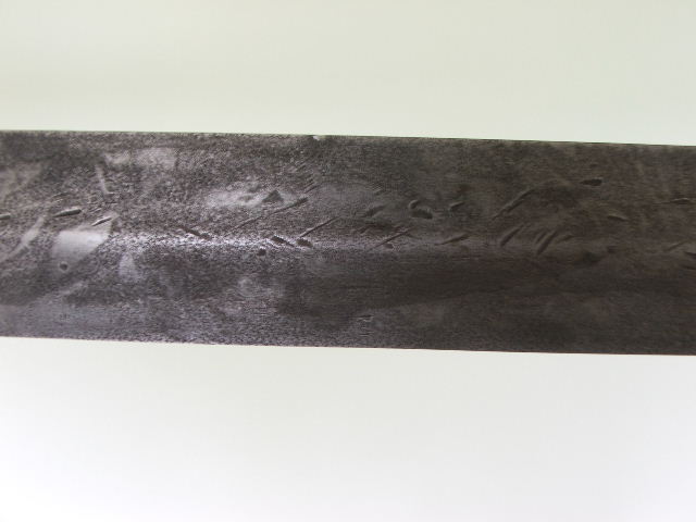

.. portion of the blade

Also, if you observe the pattern in the corrosion/patina on the blade it appears to me that some kind of liquid solution has been used to artificially age it.
The edge looks awfully pristine for a blade that has taken that much damage on it's flat. If the blade had been rehoned to restore the edge you would probably expect to see some waviness to the edge.
It's not a bad looking sword, and not a bad job at artificially aging it.

Looks like the blade was wrapped in a cloth soaked in the oxidizing(rusting) agent and wasn't smoothed out so there were pockets in the cloth that didn't contact the blade creating the "clean" spots. When I screwed around with this some years back I got a very similar look on my first try (I used bleach which is pretty aggressive) because I didn't make sure the rag was contacting the metal throughout.
