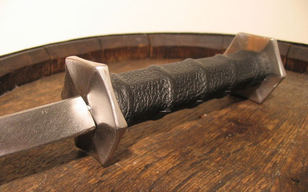

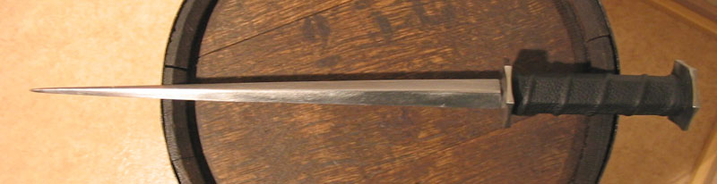

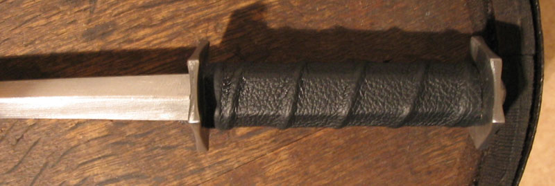

So I needed a training dagger to accompany my training longsword and I thought why not make one. The result is not quite what I had planned for but I'm still happy. I wanted a triangular cross section rondel so I asked a smith I knew if he could make a triangularly shaped spike for me. Well I got one. Ridiculously Cheap. The Thing had almost no sign of tang and was not the most uniform object. It's some sort of spring steel, although it's not heat treated just annealed for the purpose of stock removal. And there was a lot of it. I still can't believe I didn't get any complaints from my neighbors from grinding with a bench grinder for hours on our apartment balcony. Eek! Shaping the tang was a lot of work. And now I understand why many companies resort to cast steel fittings. The labour these things require without proper power tools is quite a lot. The handle is some sort of hardwood I had lying around. I still need to cut the blade a bit down cos it's 5 cm too long and not too safe yet. Maybe I'll make a sheath for it. Well here's the stats.
Length: 42 cm (16,54")
Handle length: 10,5 cm (4,134")
Blade length: 30 cm (11,81")
Blade width at the base: 1,7 cm (0,663")
Blade thickness at the base: 1,2 cm (0.47")
Diameter of rondels: 4,2 cm (1,65")
Thickness of rondels: 0,5 cm (0,2")
POB: ~1cm from rondel. (~0.4")
Haven't weighed it yet.
I took some quick pics, from the sides you can see almost none of the horrible mistakes I made Big Grin
 Attachment: 36.42 KB
 Attachment: 51.08 KB
 Attachment: 50.52 KB
 Attachment: 46.96 KB

Very nice, Risto! I particularly am impressed with the sculpting you did of the rondels. Was this your first blade project?

Thanks for the kind comments. This was my first short blade project. Earlier I have made a one "normandish" sword, one round pommel and re-hilted some swords.
Sean: I had a wooden version and then I lost it. Better makea training dagger you certainly will not loose! I have to admit that I have thought of leaving it as-it-is. The length of this beast is quite intimidating, but if the ideal length for a rondel is such that the blade extends to the elbow, then this one is about 2" too long for me. Besides the tip is not quite straight for the last 2" so I could correct that by cutting it down. The nut is not threaded to place as I don't have proper equipment to make threads on the tang (which is by the way monsterly thick). The nut is modified from an 8mm off-the-shelf nut. Smaller would have sufficed but I couldn't be bothered to make that 7mm thick tang anymore smaller. If I had known what trouble I had to go to peen that *stard, (this involved sneaking to the university's physics lab, but no more of that...) I would have made it smaller. If I can find the pic of the blank where I started, I'll post it.

I particularly like the work you did on the rondels - the faceted hollow grinding adds a major impact to the aesthetics of the piece.

Good work Risto!
By all means, do *not* shorten the blade or blunt it. That wold be a real shame.
It is perfect this way, even if there are slight unevenesses as you say (can´t see that i the pics).
Nice combination of elegance and brutish violence in the design. Perfect 15th C character in that respect ;-)

Very nice work the only thing I would change would be having the blade heat treated " before " putting it together.
For a training tool your only mistake was making it too good: Would be a shame to blunt it and even then I wouldn't want to face someone holding it except for extremely controlled half speed training. ( Just an opinion that I can't support by personal experience. )

Quite a beautiful piece of work, and heat treating the blade... Well, the pyramidal spike... before attaching the furniture would have been better, and it'd definitely be a shame to blunt or shorten this lovely weapon.

Jean: To be completely honest, the A&A rondel is where I got the idea for the faceted surfaces. I went through tons of pics of antique and contemporary pieces and picked up things I like.
The reason I didn't heat treat it was simple, I don't have the equipment and I didn't have the patience to send it anywhere for it. I believe it will be more than tough enough for any use it will get. I think it was hardened some as it was let air cool and it was not properly annealed. The way I would blunt it, if it ever came to that, would be the same as you blunt practice rapiers. First put a 9mm shell over the somewhat dulled point and then this sort of rubber blunt over the whole package. This way I wouldn't have to blunt it too much. I do realize there is a wide variety of lengths in rondel daggers, but as we use Fiore's and Vadi's system I believe what they recommend, would work best within their systems. I AM growing to be more and more reluctant to shorten it... I've always liked the way Mr. Windsor put it concerning longswords: "If you love it and want to play with it all the time, you will spend more time practising." I think it applies to all practice weapons. Happy
