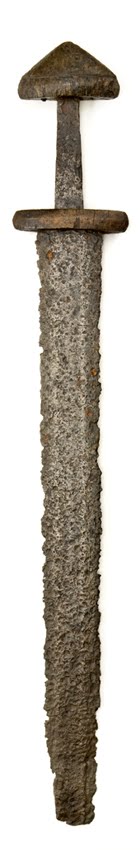

Yes, this is one of the options. The second is Hanwei-Tinker Norman. I have wanted a medieval one hander for some time, my original idea was something that would not have looked out of place in my home country Finland during early medieval period. My first choice was Hanwei Tinker Viking. There have been some sword finds of that era in Finland.
http://www.helsinki.fi/arkeologia/rautaesine/...52_37a.htm
http://www.helsinki.fi/arkeologia/rautaesine/...52_37b.htm
Suontaka Sword is of course the finest specimen from Finland, but costly to reproduce.
The Hanwei-Tinker Norman has the general looks of this sword: http://suomenmuseotonline.fi/fi/kohde/Arkeolo...mIndex=474
Of course, there are lots of later sword finds and the words were usually imported. Still, the original question is: which one has the better balance and feel? The norman might be a bit more tip heavy?
I plan to rewrap the handle anyway. Easier with nut attached pommels. When I am pleased with results I could epoxy the whole thing together, make a mix of epoxy and steel file dust and fill the cavity in pommel to give it peened look? Still it could be taken apart with heat.

By the way, this one would also be mighty interesting to reproduce, maybe using a HT longsword blade as the basis. A find from the Castle of Turku. It has been dated to 1450 or later. It was hidden in the castle chimney!
http://kaponieeri.blogspot.com/2010/09/turun-...iekka.html
And another find, this time from viking era: http://4.bp.blogspot.com/_HjIEhVKLPzo/TH-tJa3...762_01.jpg

Looks like I would like a sword with the early medieval blade and Norman fittings. Thanks everybody for information, but my choice has not been made any easier. Big Grin Choices, choices...
So the norman is slightly heavier and more tip-heavy, but might make a better cutter? I also like the brasil nut pommel and gaddhjalt guard. Since I primarily seek a cutter, secondarily another blunt sword for training and a sword of late pagan/early medieval era, the norman (or the viking) would be the best choises as sharps and the early medieval blunt for training. Looks like wheel pommeled swords were not unheard of in Finland during this era, so early medieval is not out of question as a sharp:
http://suomenmuseotonline.fi/fi/kohde/Arkeolo...emIndex=31
This sword has been dated to 1050 - 1250
Swedes did three crusades to Finland between 1150 and 1293 and that is the time frame (or slightly before the first one) I am most interested in. The sword would have to be something a wealthy Finn of that era might have had. Still the Suontaka sword would be a prime choise, but expensive.
Thank you Charles for the tip about the scabbard, this gives some interesting possibilities in decorating it and making it more "Finnish". For example this might look nice on the leather:
This symbol has been used to bring good luck and is found for example in Finnish jewelry.
