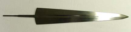

When is a tang too narrow or better yet why are very narrow tangs considered adequate for the job historically ?
I have the Anelace dagger from MRL, and although I am not sure how wide the tang is as I haven't tried taken it apart to see, the tang can't be very wide considering how narrow the wooden handle is.
When flexing this blade I observe that it curves in a uniform way and not at what I would expect in an exaggerated way right at the junction of blade and tang.
Now I can see that the wooden handle would stiffen the whole grip so that the tang would not bend where inside the handle: But I would assume then that the tang bending stress would be concentrated at the point the blade become very wide at the shoulders.
Now the observed bending of the blade seems to " fortunately " contradict that assumption that all the bending would occur in the tang and not in the blade ? I guess I am looking for an explanation and reassurance that these very narrow tangs if properly heat treated are not a snapping blade waiting to happen ? Design and metallurgical / engineering question.
I'm including a Pict taken from the Moat page at Albion just for illustrative purposes as I assume that this size tang is historically correct and must be similar to the size of tang in my MRL Anelace.
 Attachment: 20.03 KB

PostPosted: Mon 31 Oct, 2005 7:10 pm    Post subject:         Reply with quote
Nathan;
I only used this Cinquedea blade sold by Albion but made by Del tin because the tang size is close to what I expect the one in my Anelace is. The exact form might not match what a historical tang might have been like but the size has to be close.
I have noticed in some of my reference books that the narrowness of the handle of many very wide bladed daggers, Cinquedea in particular, would impose the use of only the narrowest of tangs.
No negative criticism of this product offered by Albion meant or implied: The fact that the tang of an historical piece couldn't have been much stouter lead me to believe that this size tang was in period considered O.K.
Just don't understand why / how ? Laughing Out Loud
Note: In proportion the tang of my Albion Sovereign is narrow at least when compared to the blade width but is more substantial because everything is bigger with this sword compared to a dagger, whatever is happening to the bending forces in the dagger should be similar in the swords at least in engineering / force curves / stresses, etc ......

What's really surprising is that large hole in an already thin tang ? If the whole handle assembly including the guard was solid, the two other holes meant I assume for rivets, might mean that a lot of lateral stress would be transferred to the widest part of the blade and not all concentrated on the tang.
Although I am assuming that a period piece would be a " using " piece ? Some may have been more " male " jewellery than serious weapon ? On the other hand one like this may have been sturdy enough, but without the extra beef giving it a large margin for error strength wise i.e. NOT railroad engineered to say the least. Eek! Laughing Out Loud
I guess my expectations are influenced by " modern " fighthing knives " or Bowie knives that have full tangs or at least substantial tangs.
I see the same design issues in 19th century large Spanish fighting folding knive with heavy blades and tiny pivot pins.

Thanks John for the reply: I also like a stout tang as it makes me feel better, the last place a sword should fail is at the tang and if overbuilt the blade will either take a set or snap mid blade before anything can happen at the tang.
HMMMMM: With a dagger like my MRL Anelace or the Pict of the Del Tin Cinquedia in my first post the tang is scary narrow but the distal taper of the blade making the tang thicker than the average thickness of the blade would go a long way explaining why the blade of my Anelace flexes midblade rather than at the tang: I would assume that the stress curve ( If that is the right term for it ??? ) spread the flexing over the length of the blade rather than concentrating all the force at the tang.
Now if a tang is very narrow but at the maximum thickness of blade the above is the situation.
Now if you have a tang that is thinner than the blade, even if wide, I would think there would be a good chance of the tang failing or at least bending excessively at junction of tang and blade.
The worse situation is narrow tang + thin tang, and if we want the very worse: Add bad heat treating too soft or too brittle.
