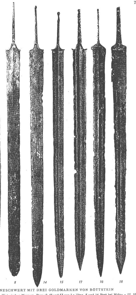

PostPosted: Tue 04 Oct, 2005 5:55 pm    Post subject:         Reply with quote
pre-spatha blades:
Celtic longswords from the Port find and vicinity. Most likely date is 1st century BC, but could be a bit earlier or later. Certainly not later than 1st century AD.
All blade lengths are 30.5" or more
 Attachment: 98.88 KB
