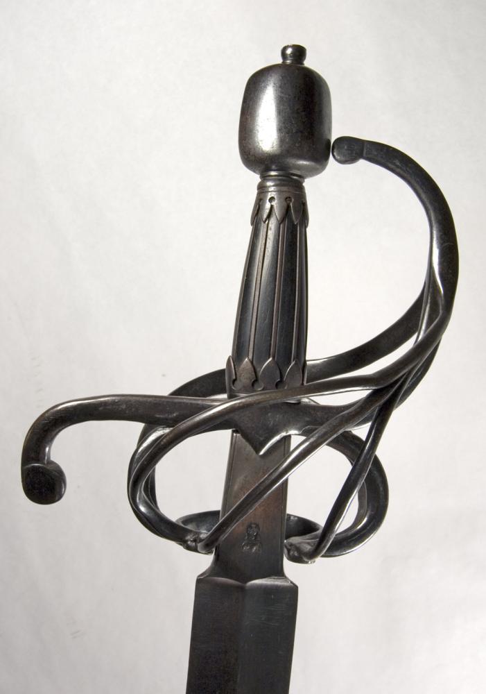

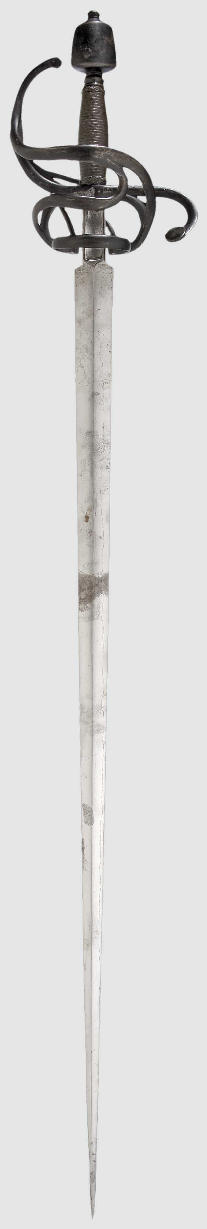

Does anybody have a photo, drawing or catalog text for WC A612?
For reference, this is the sword upon which A&A based it's Town Guard sword (first image below).
The next two photos show swords by the same manufacturer, Wolfgang Stantler.
I found some old data online for "rapiers in the Wallace Collection," and although A612 is included in those tables, I don't know the source or reliability of the data.
Any help is welcome.
 Attachment: 11.16 KB
 Attachment: 37.21 KB
 Attachment: 54.01 KB

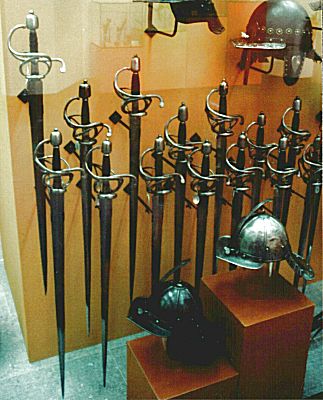

PostPosted: Wed 10 Sep, 2008 7:52 pm    Post subject:         Reply with quote
Unfortunately, I don't have any info for you Sean. But I would also love to know if anyone has any data: This style of sword seems to have be recreated quite a bit. There is one in the National Museum of the American Indian, and there is another on loan from the Higgins which is currently at the Folger Shakespeare Library in DC (though this one has a blued hilt). I've seen others elsewhere, and all of the ones I've seen are attributed to Munich for use by the town guard.
One of the really intriguing things about the design, to me, is that the ricasso is incredibly thick, but the blade tapers very drastically. Eyeballing them from behind the glass, I'd guess the ricasso of these tend to be about 3/8 of an inch thick... that's nearly half an inch! Modern repros just don't do that (probably because it isn't cost effective with stock removal).

PostPosted: Wed 10 Sep, 2008 11:42 pm    Post subject:         Reply with quote
This type of sword seems to have been highly popoular in the first decades of the 17th Century, however I have some serious doubts about the sword being made for use by the Munich Town Guard. Swedish, Dutch & some German historians consider it a cavalry weapon used mainly by the Cuirassiers. At a glance the design and quality of the sword seems to support this. I have yet to see a 'common' infantry sword from the same period which is as finely made and all I have seen tend to favour the cut more than the thrust. The A612 and it's realtives all favour the thrust and seems to be a type XV/XVa fited with a complex hilt.
The first of two such swords on display in the Swedish Army museum
The second of the Army museum swords.
http://www.sfhm.se/templates/pages/ArmeObject...anguage=EN
Franco-Swedish Colonel (later Fieldmarshall) Jacob De la Gardie wearing version with a gilded hilt in the Netherlands 1606

PostPosted: Thu 11 Sep, 2008 6:10 am    Post subject:         Reply with quote
Great info, guys! Excellent photo support, Daniel!
Thanks!

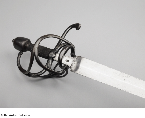

PostPosted: Thu 22 Jan, 2009 1:55 pm    Post subject:         Reply with quote
Aha! The Wallace Collection has added A612 to its online database:
 Attachment: 74.33 KB

PostPosted: Wed 28 Jan, 2009 11:25 am    Post subject:         Reply with quote
Found these detailed photos at Hermann Historica (auction 56). The HH magnifying feature shows incredible details of the whole sword--much less than I can show here.
 Attachment: 141.09 KB
 Attachment: 142.73 KB
 Attachment: 84.69 KB
