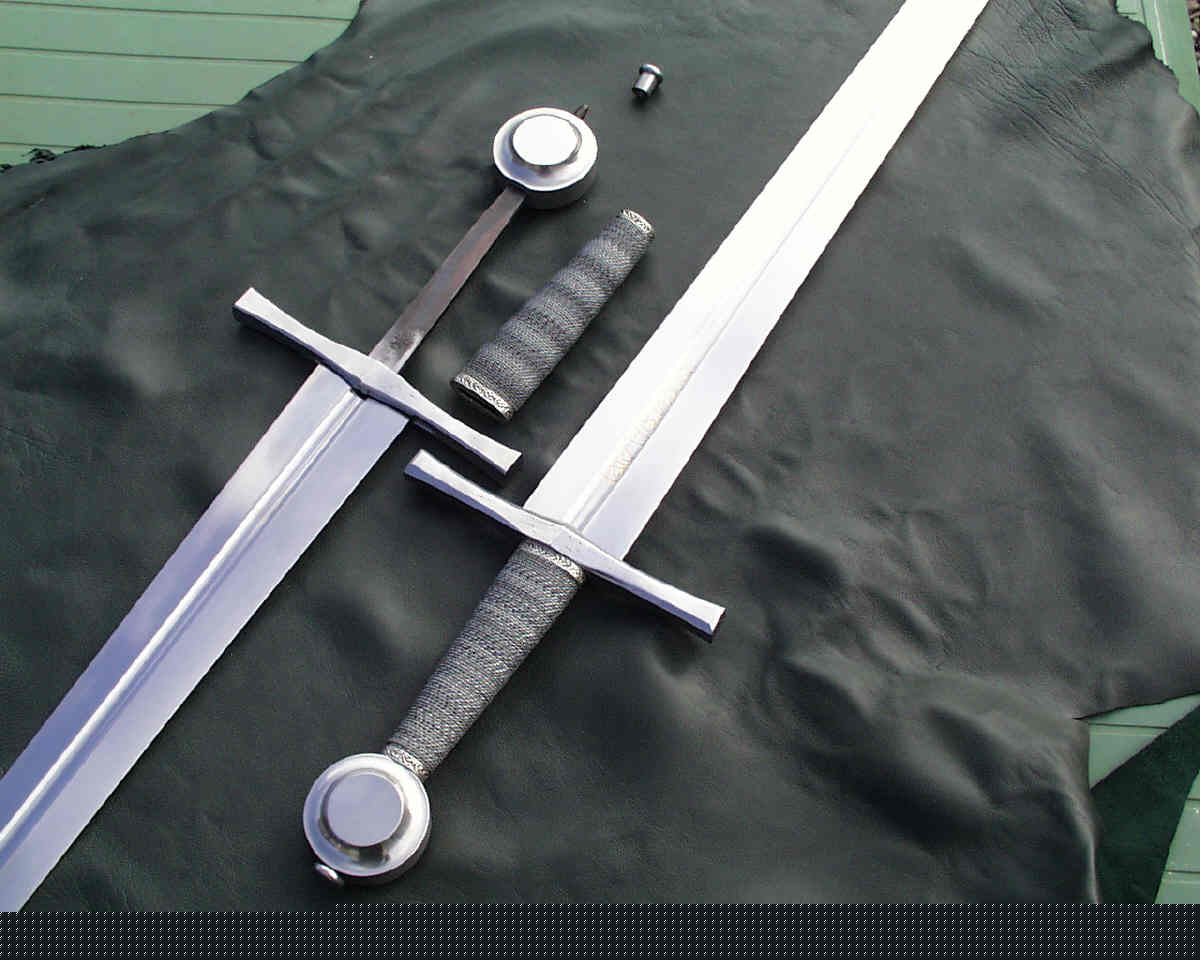

What do you guys think about this construction method compared to the production methods of Albion swords.
From Rob Miller's Castle Keep website, Castle Keep, Isle of Skye, Scotland:
"OK,OK...so its time to get a new camera,this one has had its day i think,it has a hand cranked mechanism and a lareg black cloth over the back of it. anyway,this is to illustrate a new construction method that i shall be using from now on,the tang fits tight into the slotted pommel as in all Medieaval swords,but without being peened over at the top.The advantage of this method is two-fold,it allows the sword to be completely dissembled for cleaning etc,and a heated and peened tang on a modern tool steel blade will be brittle due to the heat used in the peening without the ability to anneal it afterwards.Some makers my weld a mild steel end onto the tang to overcome this but that is a further weakness in the construction,so i have provided a tang nut on top that can be undone and tightened up again after re-construction of the sword.I shall be using this in all future Knights swords and Claymores,which will add a little to the price,but worth it i think.. "
Rob's Philosophy as noted on his website:
""When a sword is hand forged it becomes more than a dead piece of steel. The structure of the blade comes awake and crystalises under the hammer blade to produce a tough and far superior weapon to those made by mass production methods. When I started my training as a Bladesmith I began a search for excellence in this field; to try and reproduce acurately the finest blades of history, as living, working pieces, both beautiful and functional."
 Attachment: 68.36 KB
PostPosted: Sat 17 Sep, 2005 12:33 pm    Post subject: Re: Construction method comparison         Reply with quote
Charles,
That's basically the method Gus Trim uses. Arms & Armor also used to use a similar set-up; they may still, though their pommel nuts sat atop the pommel, rather than being counter-sunk (as this appears to be).
Using the excuse of being able to disassemble it to clean it doesn't hold water for me. Historical swords of that era were not made to be torn down and reassembled regularly via methods like this. I prefer more historical methods of construction. But that's just my preference.
Plenty of people use swords made like Castle Keep shows, and that kind of construction can be solid when done properly.
For what it's worth, Albion's method of adding the sandwich-style grip as the last step (after the guard is wedged in place and the pommel peened) is historical for many types of swords, grips, and tangs, but not all. Some grip styles and tang shapes made the slide-on-peen-last method necessary. The grip would have been slid down onto the tang after the guard was added. The pommel would come next and be peened.

This kind of assembly method can give satisfactory results but it's not my preferred choice. This is basically a method of compression-fit assembly. Everything is held together under tension by either a locking nut or some kind of screw. This results in quite a bit of tension on that screw or nut and failure could possibly occur. It also puts added tension on the individual components that doesn't need to be there. In a construction method like the one Albion uses the components are secured individually. Consequently they aren't under any unnecessary tension. I'm not saying that Robs method is a bad one necessarily. A sword like this, if properly constructed in every other sense, could give years of satisfactory service. It just that this method causes stresses that don't absolutely have to be there.
As for disassembly being a selling point, well, a sword shouldn't be taken apart for "routine" maintenance. Just because you can take it apart doesn't mean you should take it apart. Every time you disassemble a sword it causes unnecessary wear and tear on the components. If a component needs replacement (which is more likely with Robs construction method due to the added stresses placed on the components) that's fine, otherwise it should be left alone.

Thanks guys, basically I just curious about Rob's remark that by peening the end of the tang, it would make the overall blade more brittle. Also his remark that heat treated blades are not as strong as hand hamered, forged blades.
Patrick Kelly
Location: Wichita, Kansas
Joined: 17 Aug 2003
Posts: 5,739
PostPosted: Sat 17 Sep, 2005 4:38 pm    Post subject:         Reply with quote
All functional blades are heated treated. Forging is simply part of the manufacturing process, and one that can be replaced by milling and grinding. We admire and value forging because of its part in the traditional process of blade-making, not because of any marked superiority it may have. It's been well established that forging and stock removal can both result in high quality blades. The whole idea of forging being superior because it realigns the grain structure of the steel is an old myth. Since Rob forges his blades he obviously chooses to believe this, or uses it simply as a marketing tool. If you're seriously considering a purchase from Castle Keep, or any other maker, I'd strongly suggest that you look beyond the marketing and hyperbole and focus on the real tangible aspects of the work.
