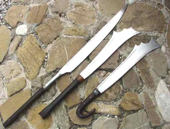

Here is a pic from the Del Tin web page of their choppers

Lance K.

PostPosted: Thu 25 Aug, 2005 2:51 pm    Post subject:         Reply with quote
wow i love that first one!

PostPosted: Thu 25 Aug, 2005 4:17 pm    Post subject: Del Tin Chopper's !         Reply with quote
I have both in stock, the two on the right side of the photo.
