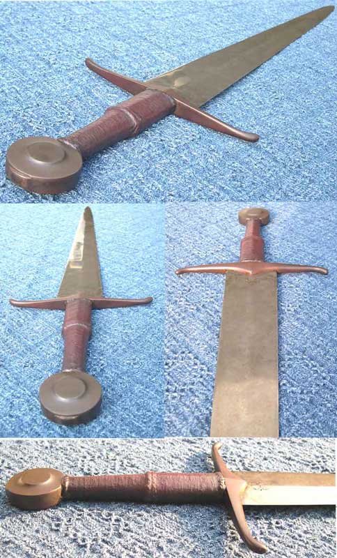

Here is my Museum Replicas’ Arbedo with a reformed and rewrapped grip, and browned Cross and Pommel.
Measurements and Specifications
Weight: 2 pounds 13 ounces
Overall Length: 39.75 inches
Blade Length: 31 inches
Fullers: None
Guard Width: 8.25 inches
Grip and Pommel Length: 8.25 inches
Grip Length: 6 inches
Point of Balance: 3.25 inches from guard
Center of Percussion: 18 inches from guard
The Arbedo Sword is Museum Replicas’ attempt to replicate a beautiful hand-and-a-half sword (c. 1350-1400) in the Metropolitan Museum of Art in New York. Based upon the few pictures I have seen and the one blade measurement in Oakeshott (31 inches), the MRL’s Arbedo Sword seems to be a fair replica. The blade geometry is slightly different, especially at the tip. However, the pommel and grip is where most of the differences can be found. The replica’s pommel seems to be significantly thinner. The shape of the grip is also different. The original has a ridge running down the center of the grip that continues the median line of the blade.
My Arbedo has a tight and solid feel to it. The fit and finish is well done, with no large gaps, pitting or scratches. It has a very flexible, well-tempered blade with the typical MRL grinding (or forging) ripples on the blade surface—maybe a bit more pronounced that normal. One of these depressions is larger and somewhat noticeable near the ridge-line of the blade. These irregularities can only be seen in an oblique view down the blades length. And, as this sword was a Christmas gift from my wife, it would take much more than this to tempt me to send it back.
The Arbedo Sword is easy to control. The point of Balance is rather close to the hand and the counter-weight of the pommel and extra grip makes the sword feel much lighter than the scales would indicate. Yet the sword has enough blade presence (barely) to track well.
With five children in my house, all my swords are blunts. So I have no idea how the sword would cut. I suspect that the sacrifice of weight in the blade (making it easy to place the cut) would reduce the force of the cut. The same could be said for thrusting. The point would go where you wanted but the relatively thin flexible blade would not have the rigidity to penetrate very easily. A little less distal taper and a more prominent central spine would make this replica a better weapon. In fact it would be the blade as appears on the original.

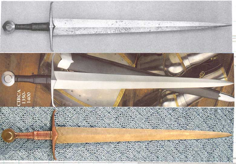

The Original in the Met
MRL Arbedo Replica
My Arbedo "Redo"

More Arbedo Redo Hilt Pics...

That looks absolutely fantastic. Thanks, in particular, for sharing photos of the original reproduction along with the antique and your own version. Can you please include more info on the process you used for the aging process and re-gripping? I think a lot of people could benefit from this!

As to the aging of the blade... It is really simple. Dab mustard in a regular pattern on the blade, let it dry for 10-15 minutes and then polish it off with 0000 steel wool. It has a strange polished, 3-deminsional effect. The difference in the blade color from yellowish to gray in the photos is cause by the different ways the light reflects off this almost etched pattern.

Before I became interested in swords, I was a "buckskinner" (fur-trade reinactor). I used Birchwood Caseys "plum brown" on the barrels of my rifles. I thought I would try it on the guard and pommel... Of course you must heat the metal. I very carefully heated the cross and pommel, with a torch that I had... applied the browning solution let it set... heated it again applied another coat, let it set... then one more heating and coating.
[I have seen browing jobs on the forums where it appears the only applied one coat, so it is really splotchy.]
I was surprised that I could use a hot browning solution on an assembled sword without burning the leather on the grip. You start at the edges and let the heat conduct through the metal toward the more organic parts.
Then I messed up...
I had some cold browning solution I got through Dixie Gunworks catalog. I use it to darken just a few light areas. Then I decided later to do one more coat of the plum brown (the true artist knows when to stop).
Evidently the cold browning solution was flammable and had soaked into the edge of the grip.
So I had the proverbial flaming sword.
This inspired me to change out the grip to more closely match the original. While the grip was ruined, I took the opportunity to finish the browning process. You can see that the pommel is a darker brown... that is the cold browning solution. And the guard has a more reddish brown of the Brichwood Casey Plum Brown. It looks off balance to me, so I am applying the cold brown to the guard now, leaving just a few reddish highlights of the plum brown (just so the whole flaming sword thing doesn't seem unnecessary).
As for the grip...
I took the burned leather off, unwound the waxed cord underneath. They had wrapped it with two separate cords one starting at the pommel and the other at the cross, leaving gaps that were filled as the opposite cord passed. I'm not sure why they did it this way... maybe it is more stable... or maybe a maching did it. The wood of the grip was sandwich together around the tang. Plain straight grained wood, obviously milled, giving the grip its mass produced look. I ground the wood with my dremel tool to match the shape of the original in the Met. There was not enough wood to create the central ridge of the grip, so I got out my JB Weld epoxy, cut grooves in the wood for a better grip of the epoxy and then built up the ridge with epoxy, let it set, and then finished shaping the grip.
Cording
I took the left over cord and braided some to form the larger cording on either end of the grip and in the middle. I took some coarse sandpaper and made the surface of the wooden core very rough. Then I rewound the left over cord around the larger portion of the grip, super-glueing it to the core as I went. (Super-glue... is that cheating... I heard ancient sword hilters had some kind of supermastic.)
There was not enough cord to do the smaller end of the grip because I had used it to make larger bands. I took some of my grandfathers waxed line he used to weave fishing nets and used it for the smaller portion of the grip. I like it better because the cord varies lightly in diameter and make it look more handmade. I then took the braided thicker cord, wrapped it around the ends of the grip (and the middle), glueing all down securely.
Leather Wrap
I bought the thinnest leather I could find. (I got a whole cows worth... only used about one square foot.)
Cut it to an approximate size then took my supermastic to one edge along its length and then worked my way around the grip a little at a time, putting down a line of superglue, pressing the leather down and running my fingernail between the cords. When I made it around to the other side I overlapped the two layers, took a very sharp exacto knife and cut an angled slit through both layers of leather. Pulled up the loose side, put some supermastic (glue) and tried my best to blend the edge away.
There you go Nathan...

Looks great! Having gone the faux-antique route a couple of times now, I have to know–How did you strip off the lacquer? I sand it off with good results but that's time consuming and probably not great for the mucous membranes. I found lacquer thinner and even Citrustrip to make hardly a dent in the stuff. There must be an easier way, but I haven't yet figured it out....
Sean,
On the Cross and Pommel I used a little very fine sandpaper and alot of elbow grease. On the blade I used the Citrustrip and steel wool. It was a hit and miss operation. I missed a few places, but the mustard would not etch in those places so I would put on some more Citrustrip and hit those spots hard with the steel wool.
In the end the steel wool produced a very smooth surface... I believe that is one reason the mustard produced a three-deminsional etched look, as if it were under a glass surface... obviously an optical illusion, but very interesting. The first time I did the mustard etch, the blade surface looked as if it had been etched into a pattern... much too regular... so I changed the thickness of the mustard in places, took a blow dryer to different parts to get it to etch at different rates so it would look more like aging instead of hand etching... not as a regular pattern...

Patrick,
I for one would love to see some of your work!
I can not seem to leave any of my swords alone... They will probably all meet the same fate as the Arbedo.
I am currently working on getting a grip on Albion's Odysseus Sword.
http://www.albionarmorers.com/swords/albion/odysseus.htm
Here are a few more pics of the Arbedo (the cross is a little browner) and the light was a little better for pics.
I think the Arbedo is well worth the price.
Kirk
