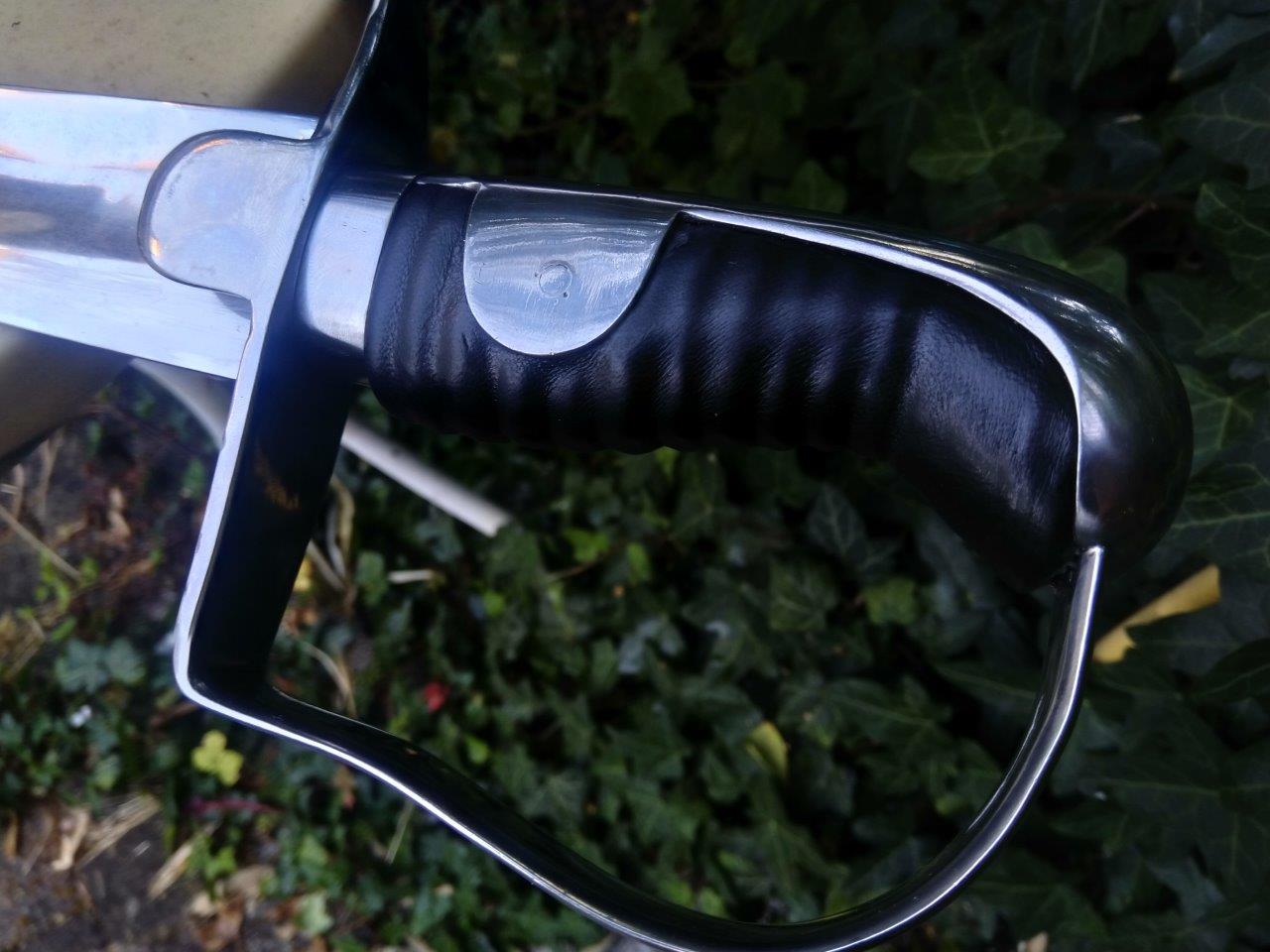

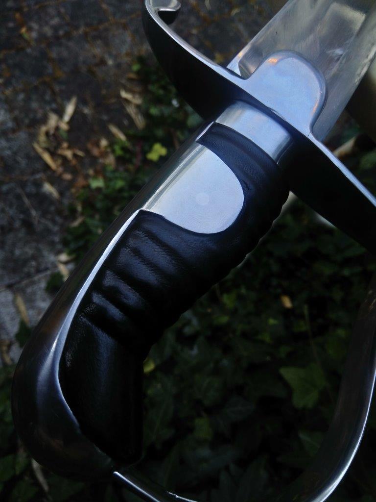

The hilt is solidly assembled, the end cap and the ears are well peened and smoothed afterwards. The ward iron seems well shaped and straight, with the caveat that one of the langets has a tiny "cut" perpendicular to the blade that goes about 1.5mm in.
As with the example that Kane Shen reviewed on Youtube, the back strap isn't perfectly centered, instead being slightly offset to the left. I don't see this as an ergonomic issue, especially as a right handed person it's better like this than the other way around. I do not know if this is a feature of originals, but it would not surprise me on a mass manufactured, state bought, trooper's weapon of war.
The leather, while not the highest quality, is well executed, firm on the grip and still nice and supple. There's a small ledge on the top between the front ferrule and the back strap, but since Roworth's manual at the time did not recommend the thumb grip (and the 1796 LC's hilt kinda is too small for this anyway), I don't see this as an issue either.

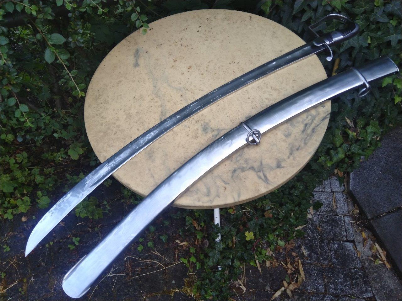

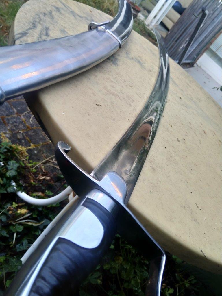

The blade is overall well shaped, with a few caveats.
1) From what I can tell, it starts relatively thin by the standards of the originals (which sometimes are over 9mm) and remains relatively thick in the foible (where originals often dip below 2mm at the end of the fuller). Thus it's a bit more forward-leaning than a some other LCs (both Windlass and originals), but also that it's a bit more rigid and less floppy. Since it's overall quite light, it does not at all feel cumbersome to me, which may partly be due to me training with the Blackfencer synthetic 1796LC beforehand, which is quite a brutish instrument.
2) There are a few spots where the edge's radius isn't perfect and flattens out for a section. I would consider this a relatively minor gripe and also something that could easily happen when swords were service sharpened.
3) There are scratches perpendicular to the blade that mar almost mirror polish. These likely happened either during sharpening or came from the scabbard. While not really something you'd want on an original sword, it's not something that detracts from it as a replica for me. I do like small artifacts in my swords. I likewise also do not mind the ripples and slightly wavy lines the blade's geometry and polish have.
4) It has a false edge. It shouldn't have a false edge, though I appreciate it having a false edge for the potential utility it provides.
The leather washer that came with the sword, as the review by Alientude, also on Youtube mentioned, was poor quality leather and not fitted to the blade. I tossed it and made my own from 2mm leather I had lying around.
The pronounced secondary edge bevel it came with is not particularly well done. It is a bit steep and, aside from the section at the hatchet tip, not particularly refined. It had also been substantially dulled from the scabbard, but more on that later.
Despite that it handled a large carton juice box with ease and also went through plastic bottles adequately. Didn't have any more targets available so far.

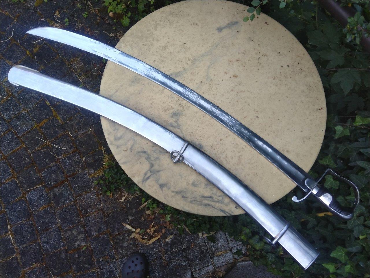

Impressions on the Scabbard:

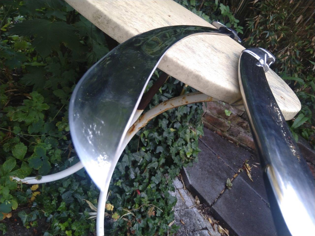

The scabbard is externally quite nice. It has a satin finish, which indeed does attract fingerprints quite readily. The chape as well as the reinforcements for the attachment rings are brazed on with gold-colored solder. The throat insert is relatively tight in the scabbard and affixed with screws, as per the originals, though one of those apparently has already eaten its threads and came with the head slightly mangled.
I'd love to say it's a nice scabbard, but unfortunately it is not and it is hard to fix it as well. I was prepared for it not being great from Alientude's video, but ended up negatively surprised regardless.
From what I understand original scabbards had a wooden core inside the steel casing. The Windlass reproduction does not.
All it has are two slats of thin (0.5mm), flexible plastic held in at two points per side with double sided sticky tape. They serve to prevent contact between the sword and the scabbard and, since the sticky tape is layered so tall that the insert slats essentially touch where the tape sits, prevent the sword from rattling about in the scabbard.
Unfortunately they do nothing at all to prevent the edge from rubbing along the front of the scabbard, which had substantially diminished the factory edge after drawing it a few times.
Removing the throat and the slats, with the aim of putting in wood and leather inserts to improve this, also revealed a tremendous degree of brown rust on the inside walls of the scabbard. I did what I could to scrub some of it away and put in Ballistol as to keep it from deteriorating further, but it's not in great shape to begin with.
I did proceed to make an insert from wood, leather, duct tape and a few choice cuts from the plastic slats to guide the blade between the wood, which so far seems to hold up well and successfully prevent contact between edge and scabbard.
