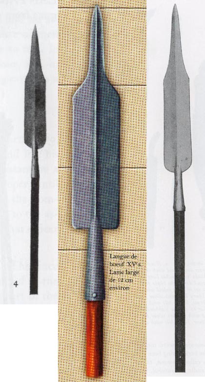

Been looking / thinking about getting a nice new pole arm and I decided to go for a custom job by A & A.
Just waiting for a confirmation from Craig as he already gave me a quote on it: So the order is 99.99 % confirmed.
I assume that Craig may suggest changes if needed to make the design reasonnably historical, although my priority is in the handling qualities. Althought a type of spear, I see this one close to a halberd in function with axe like cutting ability combined with a short but heavy armour piercing point.
 Attachment: 63.02 KB

I have a picture of one of these in a book: All hand drawn illustrations, very nice pictures, a bit like an Osprey book in quality of illustration and research. I haven't seen a photograph of one like this but the design is interesting.
" Langue de Boeuf " or Oxtunges seem to vary in shape depending on which Author / Book you read: The partisan or any large bladed pole arm resembling a sword on a pole or oversized triangular spearhead seem to be all called " Langue de Boeuf " The book I have seems to group this style with " Fauchard " type weapons.
My first impression of this one was ugly but logical design: As with an halberd you have the axe like cutting but in a symmetrical package, no specialized hooks like a bill and it could work like a two headed axe. ( I like it now or I wouldn't have one made: It sort of grew on me. )
That would take care of the more lightly armoured opponents and that narrow top spike gives you a good knight " Can opener " Eek! Laughing Out Loud
Oh, my source is in French and I've had it for years: LE COSTUME, L'ARMURE ET LES ARMES AU TEMPS DE LA CHEVALERIE, du huitième au quinzième siècle. By Liliane et Fred Funcken, © CASTERMAN 1977 ISBN 2-203-14318-5
pages 89 and117 No idea if an English version exists or even if it is still in print.
In any case, nobody makes these that I know of, so since it looks like a wicked weapon I decided to have it made.
The A & A Italian Bill was my other option but since its a strandard model I can always get one later. Cool Laughing Out Loud

That's pretty neat Jean. Very cool! About those surfaces just below the point: are they sharp so you could sort of use it like a double-sided axe?
I'm sure we'd all love to see some pics of the finished product. Big Grin
-Ted

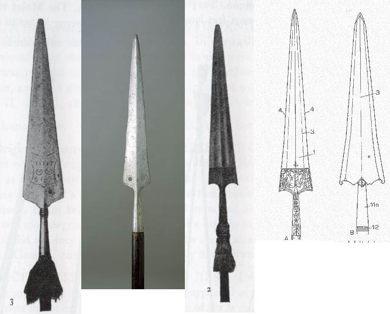

I have the Funcken book in German, it was a very good source for it's time but it is a bit dated by todays standard IMHO and contain several "strange" interpretations of polearms. I've never been happy with the langue de beuf as shown nor understodd why they have put it the hands of the Burgundian coustilier
It simply doens't "feel" right to me and I've never seen a photo of a preserved example which looks like that. But i can easily be wrong about the shape not working.
Still it would be very interestign to see if this particular design works in real life, there are faar to few good polearms on the market today.

Yes, the two parallel edges of the big rectangular shape are meant to be sharp and work like a double bladed axe.
After discussion with Craig the narrow point will be half way between a knife blade and a thick diamond section: May become thicker where the point starts in the same way that the spike on his Italian Bill is a very square diamond section and is thicker than the main blade below it.

Well as a polearm I think it would work, how historically accurate it may be I'm not sure.
I have found another source for this one in an Osprey MEN-AT ARMS book: FRENCH ARMIES OF THE HUNDRED YEARS WAR, plate G 3 from the book description ( Main sources: Helmets and Langue de Boeuf, French 15 cent., Musée de l'Armée, Paris; Crucifixion, panel painted by Jan van Eyck, Flemish c. 1425 - 30, Metropolitan Museum of art, New York )
Now the one in the plate looks more spear like in weight although of the same general shape as my design.
Mine is more of a halberd heavier version and may not be supported by any existing surviving piece.
I guess my priority is the design itself and my interpretation of it rather that historical accuracy: If it is historically based I would view that as a bonus. Big Grin
So even if it turns out to be a fantasy piece that's O.K. with me as I am now curious about how it will turn out.
At least Craig at A & A finds it an interesting project and seemed to think it was at least credible as a historical design.
Now finding photographs of surviving pieces would be interesting in any case.

Very intriguing design, please do let us know how it handles. I was under the impression that a langue de boeuf was akin to a partisan, but without the hooks, as seen in Chicago (fifth from the right).
 Attachment: 119.87 KB

I have also read that definition of a Langue de Boeuf: depending on which books I use as reference there seem to be a lot of contradiction and confusion when it comes to pole arm names.
The same name may have been applied to different types at different times, also Victorian Era sources may give us different definitions than more recent research.
The Italian Bill I've seen defined vaguely as a Vouge or Guisarme if I remember correctly.
A Langue de Boeuf could be any very large bladed spear head of conventional triangular design or maybe the version I'm having made is a possible sub-type ???
The defining point being a cutting as well as thrusting spear of symmetrical shape as opposed to a one edged Fauchard or Couteaux de Brèche.

Well I sort of hope that it is somewhat historical as finding a photograph of one exactly like it hasn't been easy so far.
Trying to search some of the primary sources with google brings you to the Museum site but that doesn't show you much more than what Metro station is closest to the Musée de l'Armée in Paris and opening hours etc .....
If I was in Paris I might be able to make an appointment to search their slide data base or actually find the one I'm looking for.
As to Langue de Boeuf, the majority of sources I have been looking at show Partisans and Partisan variants without the hooks at the base of the Blade. Also managed to see the painting quoted as a source for Plate G in that Osprey book but just couldn't see it there ? It's possible that the painting is the source for the kettle hat and not the polearm ?
SOURCE:
" I have found another source for this one in an Osprey MEN-AT ARMS book: FRENCH ARMIES OF THE HUNDRED YEARS WAR, plate G 3 from the book description ( Main sources: Helmets and Langue de Boeuf, French 15 cent., Musée de l'Armée, Paris; Crucifixion, panel painted by Jan van Eyck, Flemish c. 1425 - 30, Metropolitan Museum of art, New York "
The more I look at various polearms the more convinced I am, that as an example, that a halberd is a halberd but there is an infinite style variation i.e. no rigid pattern except for general function: A point, an axe and a hook opposite to the axe edge, proportions and other details being at the whim of the maker ??? At least with early ones and maybe regional preferences that I am only starting to be aware of are at work here !
In the same way, the minimum description of a Langue the Boeuf seems to be very large symmetrical spear head. Adding hooks they might be called other names like partisans or corseque, but would be in the same family.
Assuming that my limited " historical " sources are accurate I don't think that a Langue de Boeuf has to look like my design to be a Langue de Boeuf and that this one may just be one of those possible variants that would fit the definition ?
Oh, well, I am trying to learn more ! If my version is closer to a phantasy piece it does resemble a halberd of symmetrical design more that anything else at least in function.

Found a photographic source of a Langue de Boeuf with the same shape as my design. ( Sorry I don't have a digital camera yet. )

Jean
See attached picture
 Attachment: 74.26 KB

Jean
Another pic.
The last two are known as Alla Bolognese I think.
Perhaps they are Italian versions of the Langue de boeuf.
Anyone have information on the Alla Bolognese? Is the name correct?
 Attachment: 60.41 KB
Posts: 5,977
PostPosted: Tue 05 Jul, 2005 7:05 am    Post subject:         Reply with quote
Polearm terminology is very fluid and confusing, as even the most scholarly sources readily admit. Call this weapon what you like and nobody will really be able to challenge you with much authority. We need a good typology (which, as complex as the subject may be, would probably be simpler than a sword typology).
