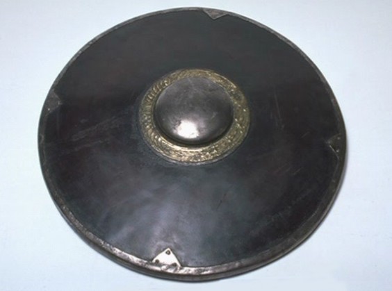

How would I go about making a convex/concave? viking shield with a boss??? You can probably guess Im trying to replicate Boromir's shield, but I have no idea where to start other than with something like a viking type, but pressed? into a convex shape? Please, any advice would be helpful!

I appreciate all the ideas....keep em comin!!! Anything and everything helps! I've done alot of sheetmetal work, but the wood working is totally new to me...... I'm really wondering about the origins of this piece... is it actually a viking period piece, and did anything like this ever exist out there in the real world??? If I really did want to make it of wood, I guess I would need to make a frame press in a concave shape to make the blanks, and use layered glued sheets? maybe with 1/4" oak veneer in plank shapes to simulate boards, and then cover the front with dyed leather? I KNOW there are more shield experts out there.... comon guys, join in the discussion!!!!

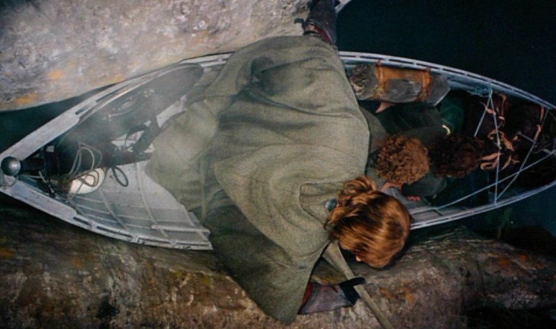

any pics??????? I have a bad pic Ill submit later of an overhead shot of Sean Bean getting into one of the elven boats that happens to show a 'bit' of the back of the shield

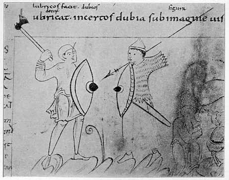

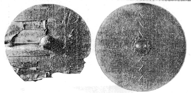

Does this help to put in context? Frankish ms pic of curved round shield.
 Attachment: 38.49 KB

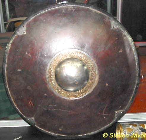

another!
Certainly is a bit of pictorial evidence for them. The boss maybe less ornate than the one you have there. But then theres some mean looking boss's with a spike wich I have seen.
N
 Attachment: 60.84 KB

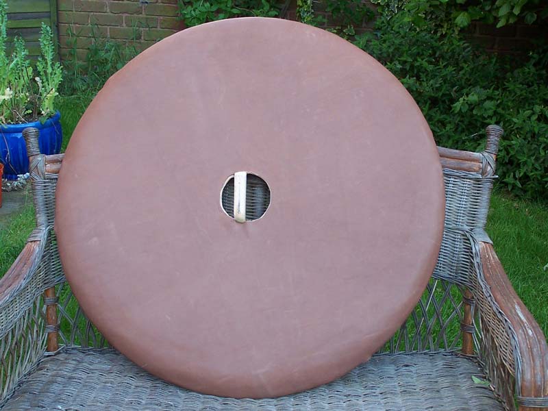

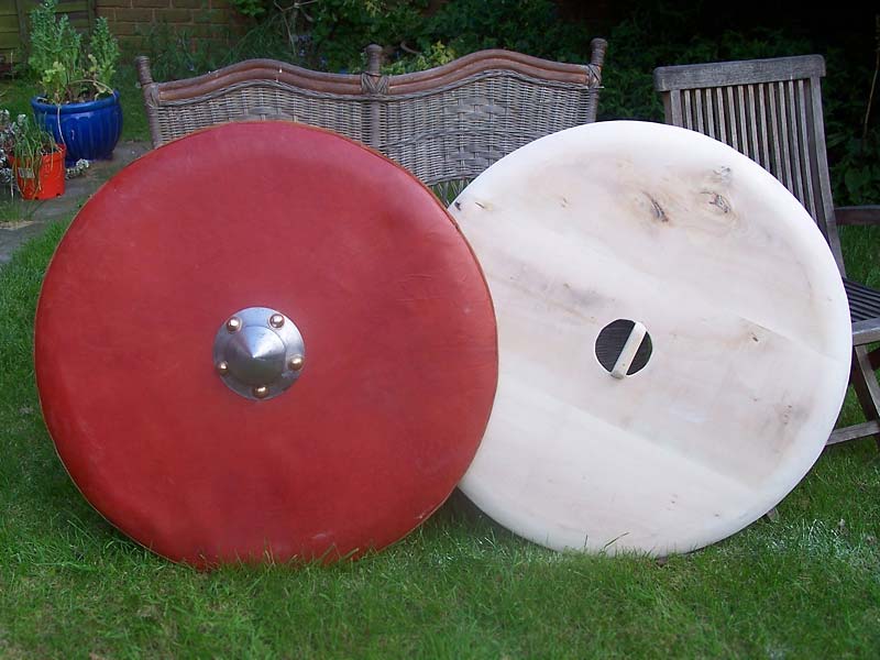

Here are the two shields that I made (photo shrinkage courtesy of Nathan) -- theses are basically flat shields with the edge rolled over.
I am not sure you would want to carve a more convex shield - they were probably pressed.

Oops, here is another.
