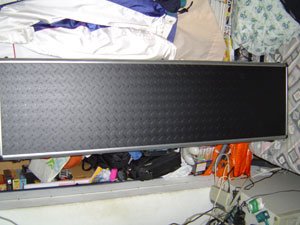

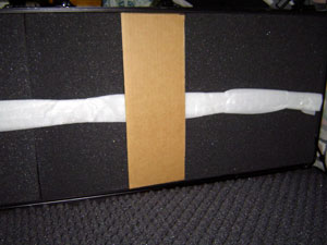

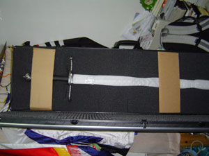

I want to commend about A&A shipping package improvement along the time. When my friend Ben first got his GBS in gun case, the sword knocked against the rim of the box and dented the tip a lil' bit. Then years later I recommended another friend of mine to buy a GBS from A&A without special mention other than "shipped in gun case". A&A crews improved the packing so much that the tip of the sword never got to touch anything but foam. Here're some photos. Craig and guys at A&A have my high recommendation:
