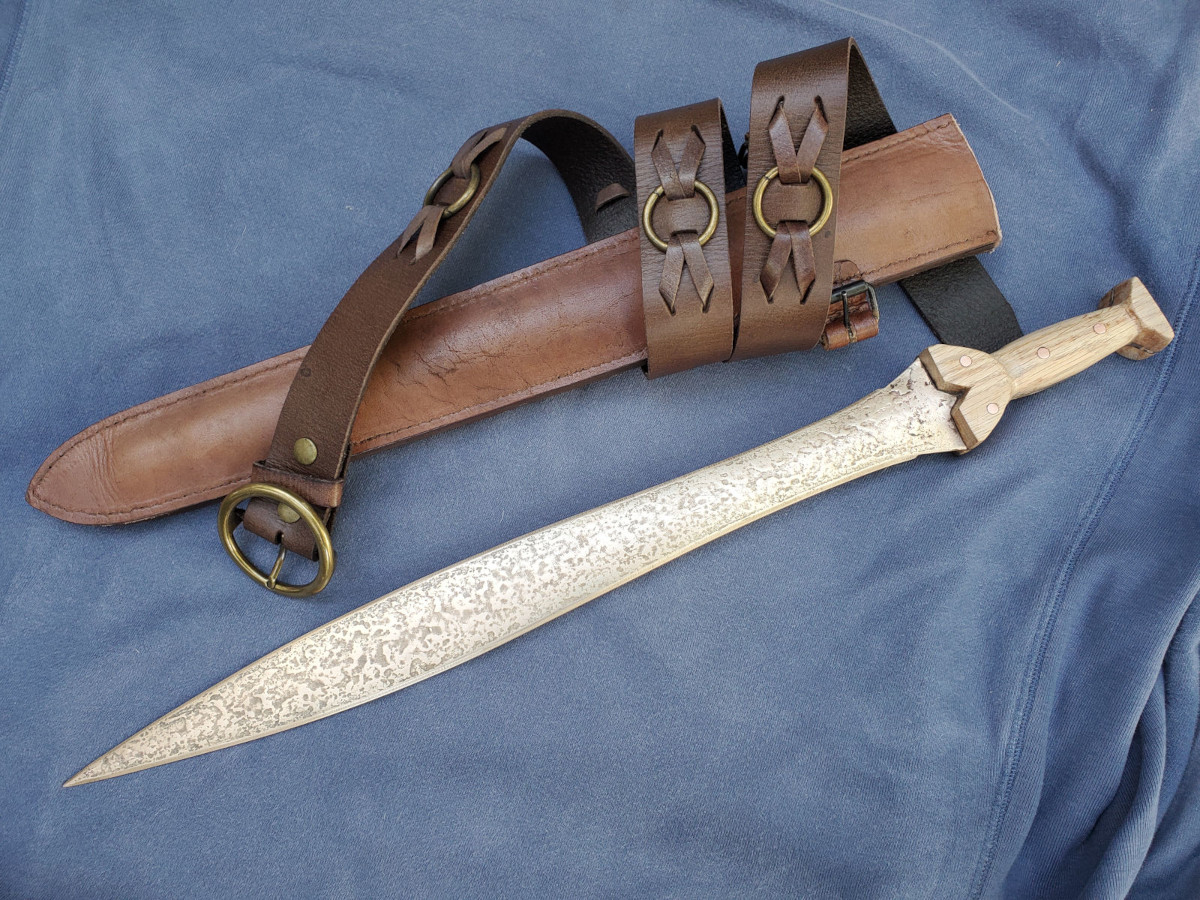

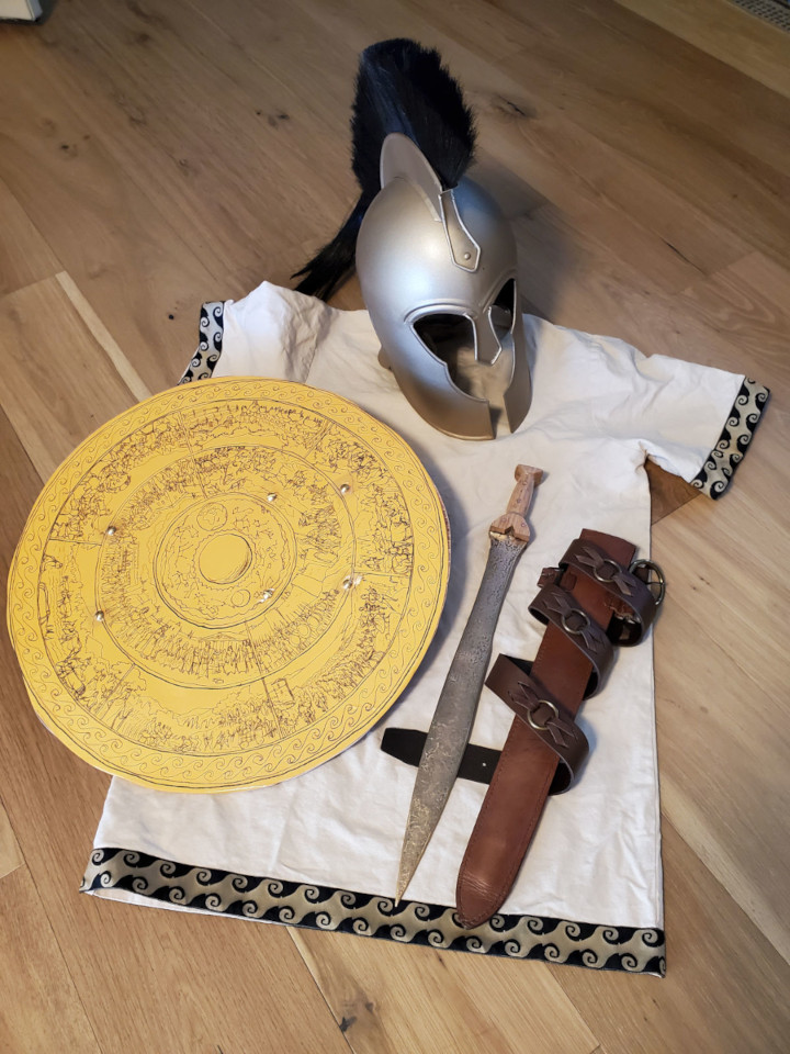

I thought some of you might get a kick out of this. My youngest, age 11, was inspired to dress up as Achilles for Halloween after reading and re-reading Gareth Hinds' incredible graphic novel version of the Iliad (https://garethhinds.com/wp/iliad/). Here is how it all turned out.
We contacted Mr. Hinds, who graciously gave us permission to use his drawing of Achilles' legendary shield. We had a print shop transfer his drawing to a vinyl sticker and then mounted it plywood. Though we should have used a dished design, for simplicity's sake we left it flat.
The helmet and tunic are from Etsy and Windlass, respectively, with the helmet just spray-painted bronze.
The belt is also from Etsy and the scabbard is the lower half of one of Kult of Athena's low-priced modular scabbards.
The sword is a solid bronze blank from Dave Chapman at Bronze Age Foundry in the UK. I burned it into chunky oak scales and pinned everything together with solid copper pins. Rather than polish the blade to a mirror finish, which seems to be the typical approach with bronze replicas, I decided to leave it rough from the foundry, just sanded it down a bit. I like the chunky texture.
Let me know what you think. Thanks!
