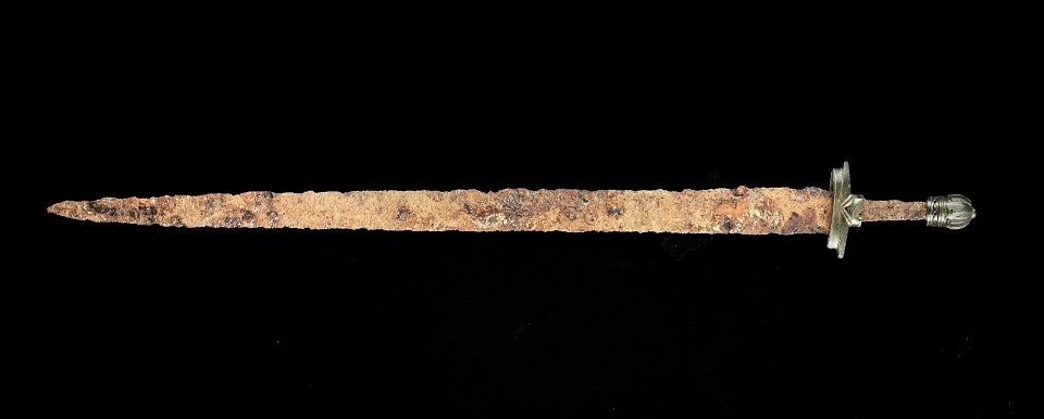

The blade size and style put me in mind of a late Roman or early Byzantine spatha. As for "no pommel", that isn't necessarily true.
Follow this link for an example of an extant Byzantine spatha with a grip style that would have presented very much like that in the illustration. One of the pics from the site is included below.
https://sword-site.com/thread/1469/holyland-byzantine-bronze-spatha-sword

| Victor R. wrote: | The blade size and style put me in mind of a late Roman or early Byzantine spatha. As for "no pommel", that isn't necessarily true.
https://sword-site.com/thread/1469/holyland-byzantine-bronze-spatha-sword |
The reason I don't think it's a pommel is because of those lines on it that appear on the upper handle. Surely there would be lines on the crossguard as well if lines did not mean handle

| Martin Kallander wrote: | | Victor R. wrote: | The blade size and style put me in mind of a late Roman or early Byzantine spatha. As for "no pommel", that isn't necessarily true.
The reason I don't think it's a pommel is because of those lines on it that appear on the upper handle. Surely there would be lines on the crossguard as well if lines did not mean handle |
Looks like a pommel to me! Sure, it's not big, but looking at the size of his hand, and the overall smallness of the rest of the sword, it doesn't look like just the end of the grip. Plus, sword grips aren't that long, they are made to fit the hand pretty closely. (Until you get into later hand-and-a-half styles, etc.)

| Matthew Amt wrote: | | Martin Kallander wrote: | | Victor R. wrote: | The blade size and style put me in mind of a late Roman or early Byzantine spatha. As for "no pommel", that isn't necessarily true.
Matthew |
This saint is from the later Byzantine period when longer hilts were a thing. If it is a pommel then the handle still looks at least 10 cm or longer since you can see it and the thumb above the palm. Pommel or not, I do not think it is a closely fitting handle like earlier swords with hilts always around 8-9 cm.

| Martin Kallander wrote: | | Matthew Amt wrote: | | Martin Kallander wrote: | | Victor R. wrote: | The blade size and style put me in mind of a late Roman or early Byzantine spatha. As for "no pommel", that isn't necessarily true.
Matthew |
This saint is from the later Byzantine period when longer hilts were a thing. If it is a pommel then the handle still looks at least 10 cm or longer since you can see it and the thumb above the palm. Pommel or not, I do not think it is a closely fitting handle like earlier swords with hilts always around 8-9 cm. |
Did you even look at the picture or follow the link? The style of pommel presented, other than being silver instead of gilded, is spot on. The type of cross presented, with a collar on the grip side, is very similar in style. You can't see the grip because it is obscured by the hand. This is a Byzantine painting and the sword in the link is an extant Byzantine sword that covers the time frame of the painting. I'm pretty sure the painted image and the extant sword reflect the same aesthetic and design technique - they are both from the same era and region. You asked "what is this sword" and I believe that link tells you precisely what it is based upon.
