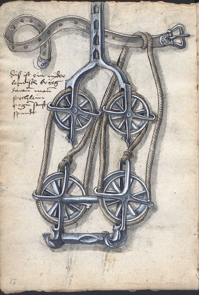

One thing I did come across, which seems to help on at least one front, is the attached image from the Löffelholtz Codex of 1505. It looks like a pulley system for belt spanning not unlike the one in the Signorelli painting, and appears next to a crannequin. It is hard to say without knowing 16th century script, whether this particular pulley system is for a springald or a handheld crossbow, since the section it appears in shows both. Still, it is something!
For those interested the codex is available here:
http://jbc.bj.uj.edu.pl/dlibra/docmetadata?id...ublication
 Attachment: 338.6 KB
Löffelholtz Codex Belt and Pulleys [ Download ]

I think the bar with holes in it shown on the Löfferholtz pulley might be meant to aid with the issue of distance of pull, perhaps to hold the bowstring in place while you reset the hook. The shape of the holes is unusual, so that might also be relevant. The crannequin on the previous page also has this bar and, interestingly, does not have the normal cord method of affixing
You can just barely make out a similar bar on the end of the tiller in the Signorelli painting. In The Battle of San Romano, it's also interesting to note that the one foreground image of an arbalest being loaded shows the crossbowman bringing something to the hook from a straight-legged position, stirrup on the ground. This may also indicate some sort of pulley system or other spanning method that uses the belt hook.
Do you think the four pulley spanning device shown by Löfferholtz offers any mechanical advantage over the two pulley system you use in your video? If not, I don't understand why one would include the extra pulleys at all. Maybe something to do with the peg holes?

Thank you very much for your comments and expertise, Tod.
Regarding M. Nordlund's comment: a friend of mine, who is much better with early modern German paleography than I, helped work me through what the note next to the pulleys in the Löfferholtz codex might say:
diß ist ein wüder lendistler [birg? beig?] davonn mann stechlein bogenn sonst spandt
which, at her best guess, translates to:
this is another [leindistel] that you use in another way to wind the [probably hook bow]
The previous page shows a crannequin and another spanning device. There he calls a crossbow an "armbrust", so by using the term "stechlein bogenn" it seems the author does distinguish a separate bow type, and that spanning method corresponds to it. Depending on if she or I can improve the translation, there might be something more interesting coming up.
I'll add that I don't think the phrase "with the belt" necessarily excludes the use of a pulley device, especially if we accept that both the Uccello and Signorelli drawings suggest the hook might be applied to a pulley rather than the bowstring itself.
 Attachment: 416.12 KB
Text of Löfferholtz pulley page

Sean Manning wrote:
Pieter B. wrote:
Is that equating a goatsfoot lever to a bow in terms of power and 'proofing' capability? If it does that is more good support for the notion that simple lever or belt and pulley bows could match contemporary bows while windlass crossbows stood a notch higher.
My working hypothesis is that the "hook crossbow" (arbaleste à crocq) in this text is the type spanned by a single hook hanging from a belt. I don't know what the contemporary term for the "goat's foot" was or how common they ever were. Ditto for the arrangement with a hooked pulley and a pin on the stock of the bow (Tod's "doubler belt"). There does not seem to be a lot of philological research on crossbow terminology from 1350 to 1550.
There is some differentiation in terminology in the records of the Teutonic Knights, of which some scholars have done some significant work. The number of papers is somewhat limited, I suspect because not that many people have learned to read Low German dialects compared to say, Early New High German. There is however also a considerable quantity of data mostly in High German from the Schützenfest contests which were routinely held in scores of towns and cities in the German-speaking, Flemish speaking and West-Slavic towns from the High Medieval through the Early Modern periods. These get into detail for the different types of shooting sports with their various different types of weapons - for example shooting at near and far fixed targets (with weaker and stronger crossbows respectively), shooting the popinjay, and shooting targets from horseback. Again, there aren't that many modern papers and most of this hasn't even been translated or reviewed recently but you can find transcriptions into modern German which were done in the 19th Century.
From these records, you can see clearly that there were sharp differentiations between various grades of crossbows, and a somewhat overlapping differentiation between different spanning systems or devices. The Teutonic Knights distinguished between at least four different types of crossbows, the knottelarmbruste, with a solid yew prod usually spanned by hand, and used only by peasant levies for the most part, the steigbügelarmbruste which seems to have usually been a steel prod weapon typically spanned with a belt hook or with a goats foot (geißfuß), gaffle, or 'wippe' spanner (particularly when used from horseback). For more elite troops they mention the statchel ('stinger') which is spanned with a cranequin, which they sometimes call the 'German winder', (sometimes also referring to these crossbows as 'half-tonners') and the windlass crossbow as an "English winder'. Finally there are the wall crossbows (Wandarmbrust and other euphemisms) which were very large weapons typically only used for siege warfare but also sometimes taken on wagons or boats.
The pay rate for mercenaries armed with crossbows varied from half a mark per month to 12 marks per month, depending on which type they were equipped with. You see similar numbers in the letters of Matthias Corvinus when discussing pay for the Fekete Sereg.
The Schützenfest don't always distinguish between types but there are indications as to different levels of power, for example crossbows used for the 'far' targets have a restriction that the prods had to be wrapped in wire as a safety measure to protect the crowd in case they broke.
I think a large part of the confusion about medieval crossbows, which has been damnably persistent, is because all crossbows kind of look the same. So what you could say about one type (regarding range, power, rate of shots, method of spanning and so on) doesn't actually translate over to another type, but they all tend to be jumbled together in (usually very superficial) modern analysis.
But I agree there is an interesting overlap in spanning methods with crossbows - you see period art depicting weapons being spanned with a goats foot or a cranequin and yet, it also has a stirrup.
