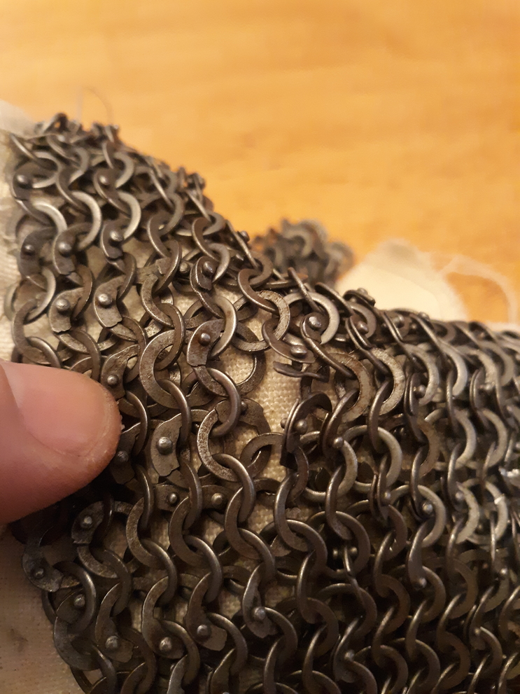

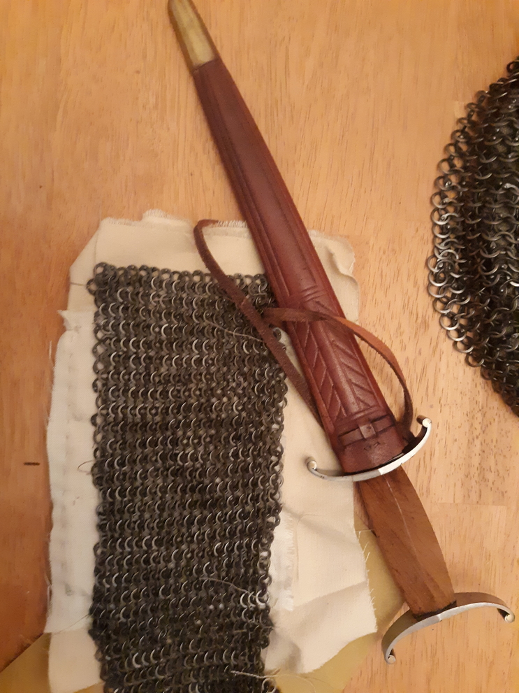

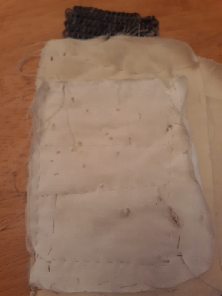

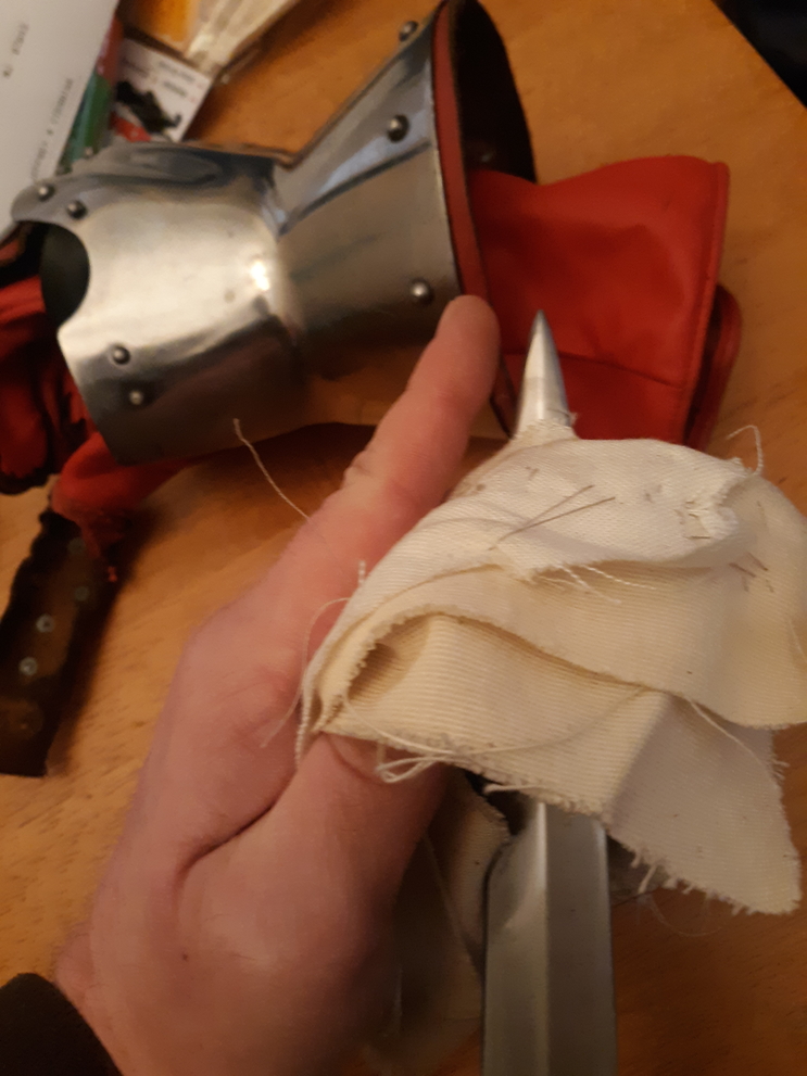

This was a not super scientific experiment of a Tod Cutler Antenna Dagger vs. 6mm ID half riveted half solid steel mail. It is sewn onto two layers of linen and two layers of sturdy canvas, the backing was fairly dense 3" furniture foam but then a cold steel buckler.
I tried three different attacks at 50% power and then close to 100%. I was wearing mail sleeves and steel hourglass gauntlets (pictured) to give a bit more weight and simulate an armored combat. I tried sottani (underhanded stab, forehand grip), roversi (downward blow from left, ice pick grip), and mandritti (downward blow from right, icepick grip). I am a relatively strong guy with I would say fair technique.
Sottani: 50% power did no visible damage. 100% partially cut into two rings a bit and did penetrate the garment beneath, but only just barely. Superficial wound at best.
Roversi: 50% power cut into rings a bit and resulted in some deformation. 100% cut deeply into rings and resulted in more deformation and close to breaking a ring on a couple of attempts, but fell short. Did penetrate garment, but would result in only superficial wounds again.
Mandritti: I managed to break a solid ring! And pop a rivet on one next to it. One of the pictures shows how much I was able to push the dagger through after the fact, as the cold steel buckler would not allow penetration. I think this could have been a "fight ender" potentially if the one stabbing was also grappling and in an advantageous position. Could result in some pretty good bleeding if in the right spot. Other hard attempts caused a good amount of ring deformation and cutting deeply into rings, but I only managed to break through the one.
The dagger is completely fine, perhaps slight blunting/very slight rolling on the tip, but I did several very hard strikes. If you look closely, the leathers on the thumb of my gauntlet did not fare as well Wink This wasn't super scientific, but showed me that it is no easy task getting through mail with a dagger. Certainly possible, and two combatants colliding in armor could probably generate more force, but not easy. I feel like it would still take a certain amount of luck with a dagger, i.e. hitting a spot that perhaps the rivet or ring just wasn't done as well or a spot that has been previously compromised. No hard conclusions, but it was enlightening for me! I do have video if anyone wants to see but it was super windy and cold so I was having a tough time recording properly.
Thanks to Tod for the great and affordable dagger. Just might have to get myself a rondel as well to compare!

Seeing that blade's pretty broad, it doesn't look like a bad penetration at all!
What's the thickness of the wire, approximately?

I don't have calipers so approximate, as you asked for, is the best I can do. Just under 1mm it looks like. The weave is pretty dense, though.
That's the main problem with Indian mail. The links are hammered way too thin. Mail made from some of their links can be torn apart in your hands. The smaller links like the ones you have form a denser weave so they provide better resistance. I posted the above link to remind people that Indian-made mail isn't really suitable for weapons testing. I love the dagger, though. Tod always does quality work.

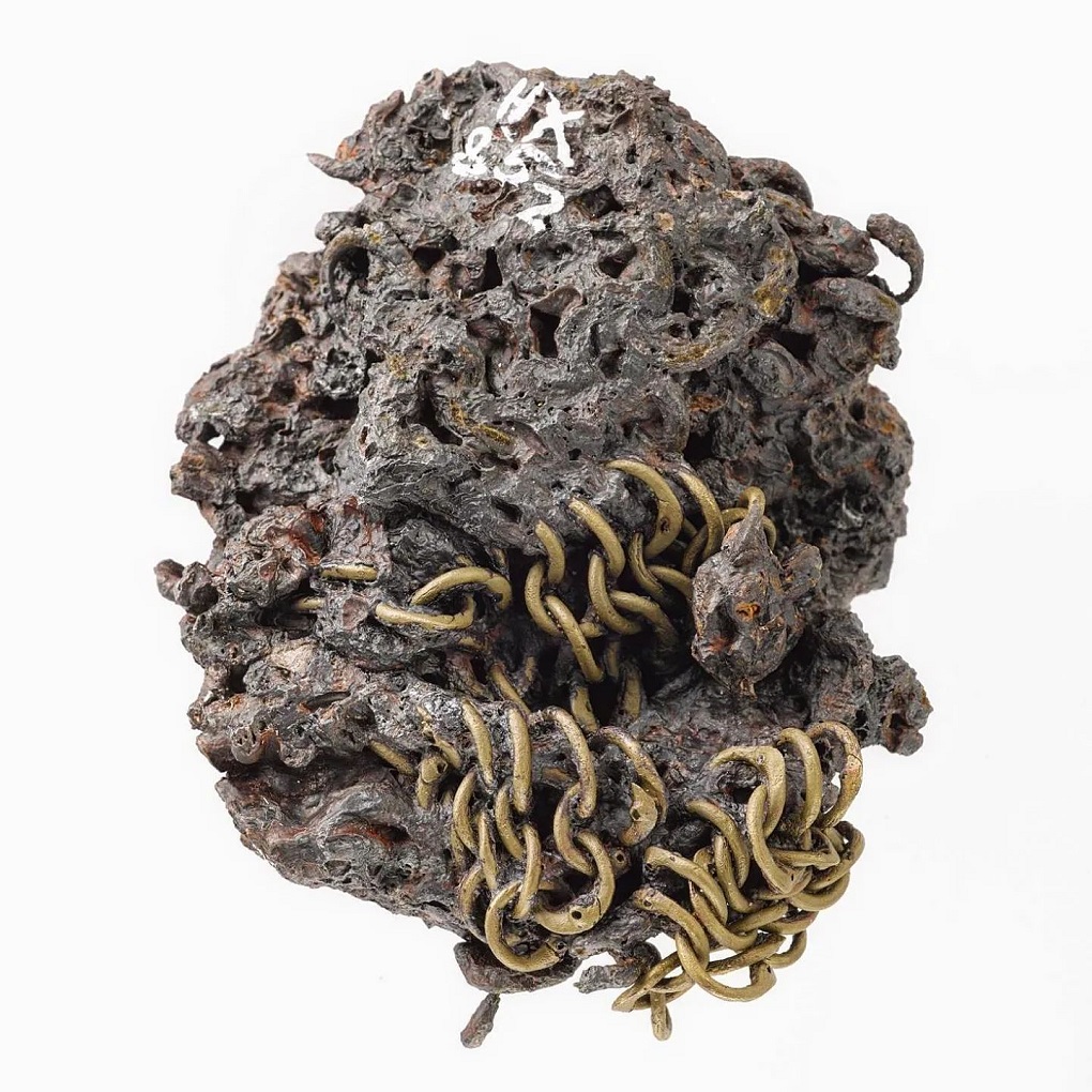

While non ferrous rings don't oxidise like iron rings, there questionable as to how representative they are of the whole garment.
They might of been a collar edging an much smaller then the rest of the garment or decorative trim an enlarged for economic or style reasons.
As there usealy attached to a lump of rust you cant tell much other then its likey a mail thing and of around so big.
(see the attached pic)
The working life of mail is most cases long and hard but the wear is not be equal on the entire garment, the areas of lower strain and less movement should be much less worn.
There's no pristine examples from mails golden age, we have battered old scraps and later mail some of which is in a good state.
Look at the Vimose mail coat, its got multiple holes, a large gash and tears up the sides.
[/img]https://i.pinimg.com/564x/02/e7/f7/02e7f73621934b2e16f0e0b5a15f3cd3.jpg[img]
While some of that might be ritual destruction, it clearly was far from new when chosen for depositing.
The Gjermundbu shirt is torn and partly corroded scraps.
Even later mail suffers from many garments being reused in different forms over time and there own long working life.
 Attachment: 322.68 KB
