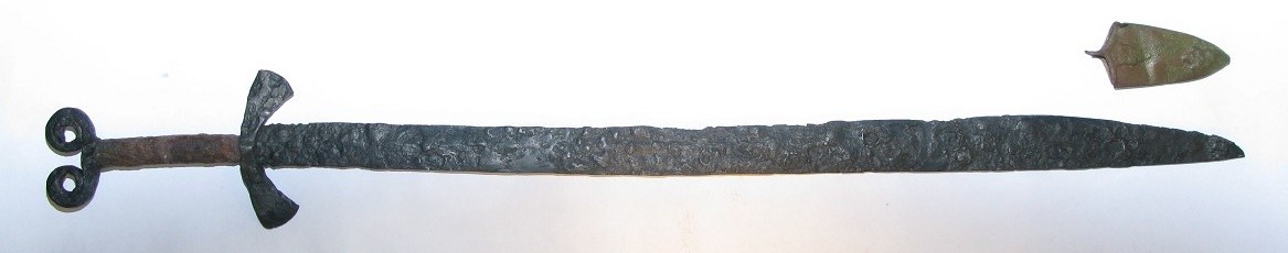

Good day,
Anyone know if any curved migration/viking swords like Jeff Helmes Baltic Viking Sword we’re available then?
Best regards,
Barrett Hiebert

I would not consider that sword curved rather its single edged.
The shape of that repro it's a bit off from any archeological example I have seen, but I have probalby not seem them all..
All examples I know of from scandinavia are straight single edge, and not curved. (Petersen type 14, seem to be most popular in Norway)

We did have this recent find mentioned at the beginning of the month elsewhere on the forum
Described as Scandinavian type, with a hint of a curve. Apparently from a battle fought on the site in 1091, so at the later end of the time range.

Bartek Strojek
Location: Poland
Joined: 05 Aug 2008
Likes: 23 pages
Posts: 478
PostPosted: Tue 28 Sep, 2021 1:40 am    Post subject:         Reply with quote
The articles I can find aren't very clear, but one in "Nauka w Polsce" clearly says it was loose find, kinda random and cannot be dated because was found with no context.
So it doesn't seem anyone connects it to the battle of 1091, it was just found during excavations that were aimed at locating the battlefield mentioned in chronicle.
It's apparently cautiously dated to the 8th century indeed, based on analogy from Haukeli.

Barrett Hiebert wrote:
Good day,
Best regards,
Barrett Hiebert
This sword was a reproduction of a sword type that was typical to the eastern Baltic region, specifically Latvia, Estonia, and Lithuania. They are from the very late Viking or early medieval age, definitely not migration period. The sword type often featured a gentle curve, or a "belly" which gave the appearance of a curve. This repro is very historically accurate, so yes, they were available.
Bjorn Hagstrom wrote:
The shape of that repro it's a bit off from any archeological example I have seen, but I have probably not seem them all..
All examples I know of from Scandinavia are straight single edge, and not curved. (Petersen type 14, seem to be most popular in Norway)
As I said above, swords like these were typical, but not in Scandinavia. Many of the most celebrated (and most interesting) swords from the Viking age were not Scandinavian and don't fit neatly into Petersen's typology, which is based on mostly Norwegian examples. Eastern examples such as these really drive that point home. Some of the Continental swords of the era are amazing and also don't fit into Petersen's typology. The same is very true for Anglo Saxon examples. Petersen is a good reference, but he's only 1 reference whose scope is pretty narrow....
I've attached a drawing of the original that this sword was a reproduction of, and several other examples of the type to give you a frame of reference. Notice that most are curved, or feature the "belly" that I mentioned above. The hilt style was usually a Petersen type Z or the antennae style, which was likely a local interpretation of the contemporary Petersen AE.
